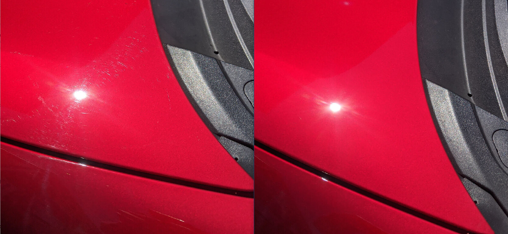

    Well, yesterday was intense. My first time using a machine polisher to try and correct the paintwork. There were numerous scratches, scuffs and a ton of really bad swirling. I couldn't get them all ou

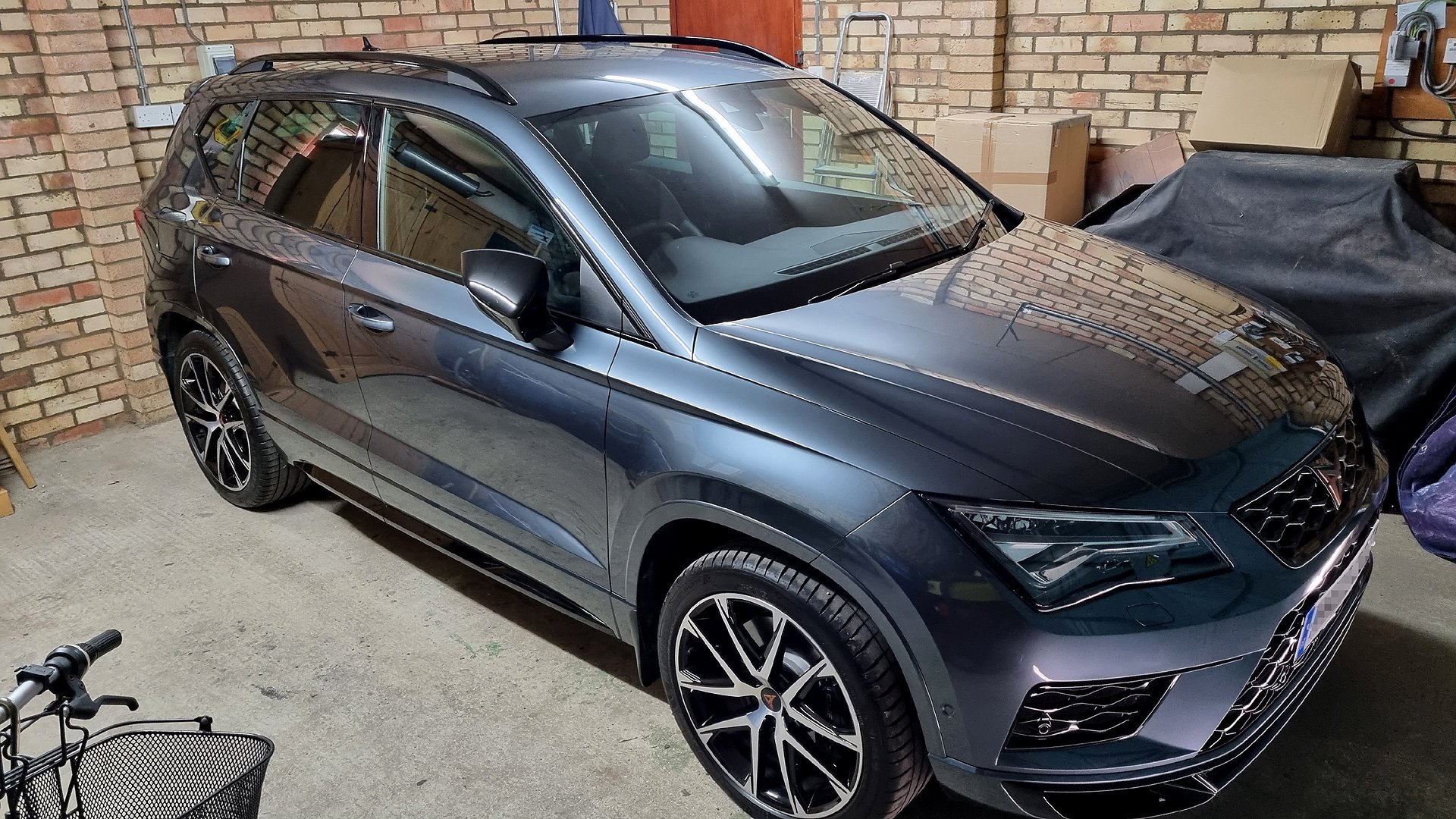

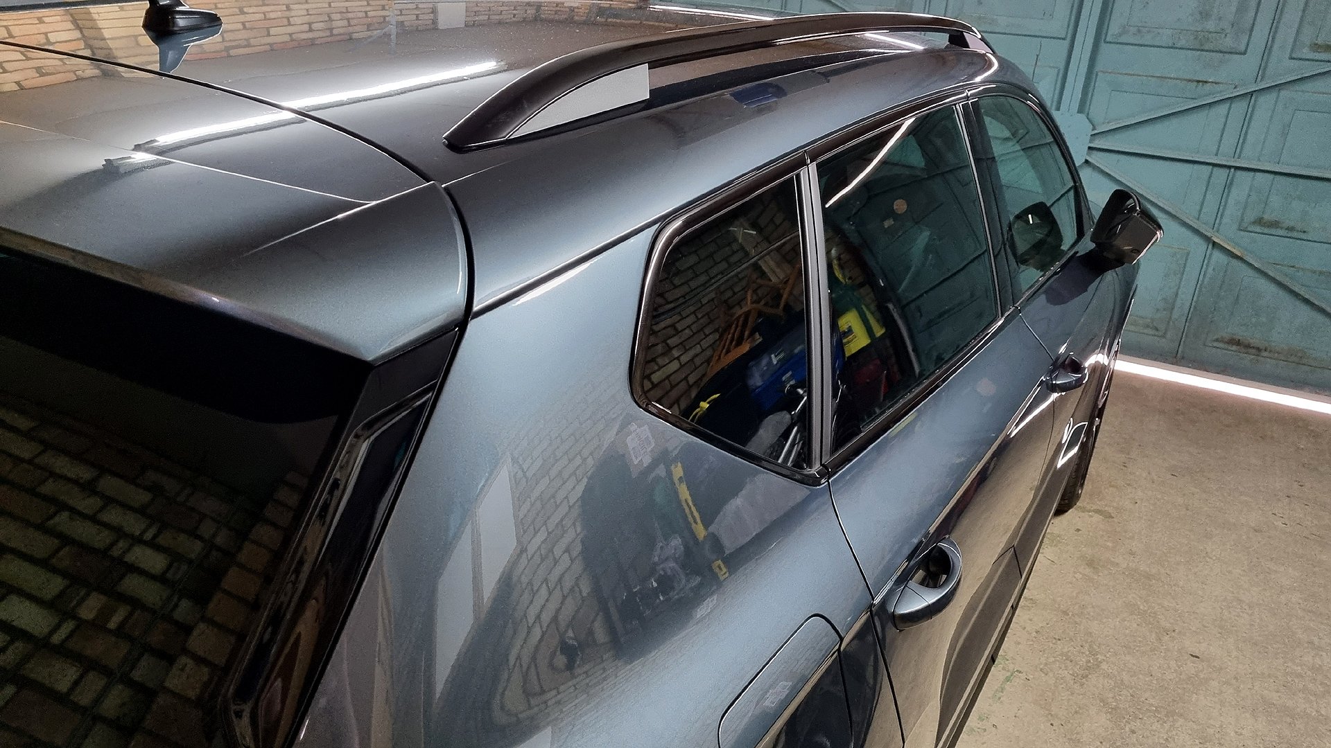

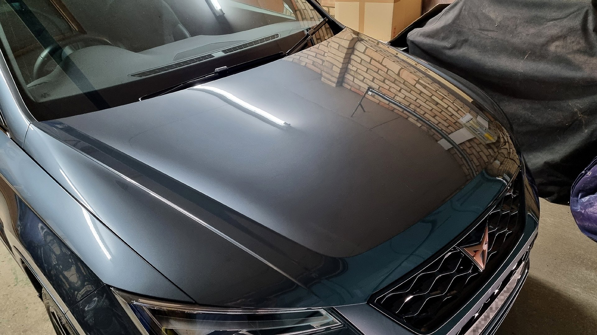

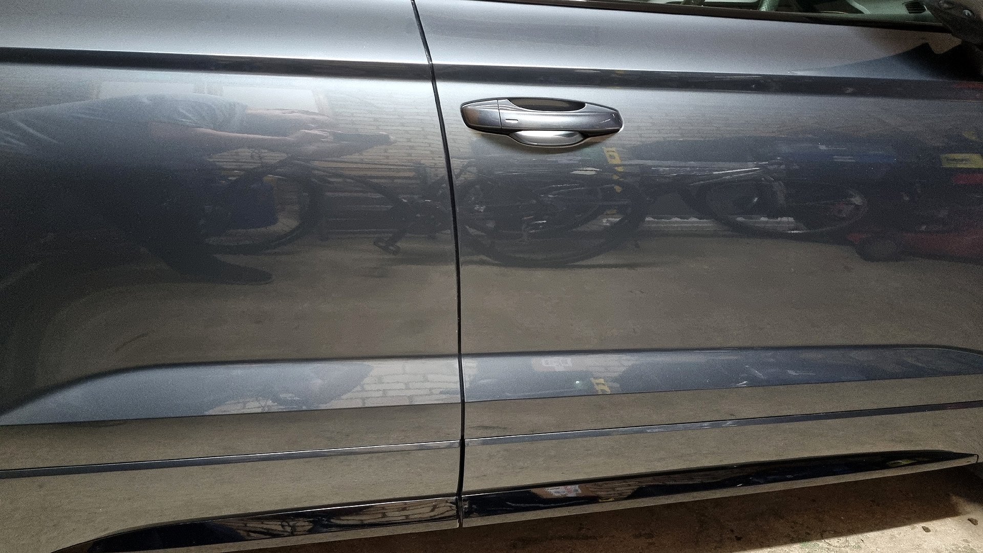

No pics, sorry !
Found my car does fit in the garage  😄😁😎
As I  had some as some light swirls in some areas (not by me I add). *Note to self be very specific when car goes in for work in future !
So todays brief:
Jet washed, Snow foam and TFR mix left to disappear then snow foamed again, left to dwell and rinsed.
2BM wash, Jet washed and MF towel dried.
Clay mitt+ detailer lube used on panels I planned to DA polish.
Nervously machine polished the panels that the swirls were noticeable in the sun.
Swirls were light so I thought start soft, (new to a DA and machine polishing) so used a finishing compound and a soft pad (Merzena 3500 pad/polish).
Then cleaned off remainder of polish with MF, followed by a wipe down with a mix of isopropyl and de-ionized water.
Inspected using the Auto finesse Swirl Correction Light (and the 6500k LED's installed in place of the old Fluro tubes in the garage). Appears my mission was successful 😁
Then  put a coat of Bilt Hamber Double speed wax on the entire car, Auto Finesse Revive on the plastic/rubber parts, Sonax BSD on the wheels, and Auto Glym Glass Polish on the glass.
Dressed the tyres with Finishkare Top Coat.
7  hours later sit down with a glass of Cider, for half an hour then start preparing tea 😌
Still to do:  clean out the window seals, and do the interior.
Purchased some more Gyeon Q2M Wetcoat for the next interim clean, I love that stuff 😁 (TBH I usually do a  full wax around once a year, the rest are interims ☺️).
Edit: Snapped some pics this moring, bit of dust settled but hey 😜
