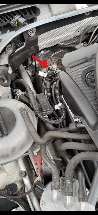

I have the air quality sensor failure issue so went to take a look but noticed that an animal of some kind has  chewed through some other cables and their sleeving in engine bay of 2.0 TDI 190.
If I can ask you to take a look at the photos i've included, I'd really appreciate any &all help identify what the part is please?

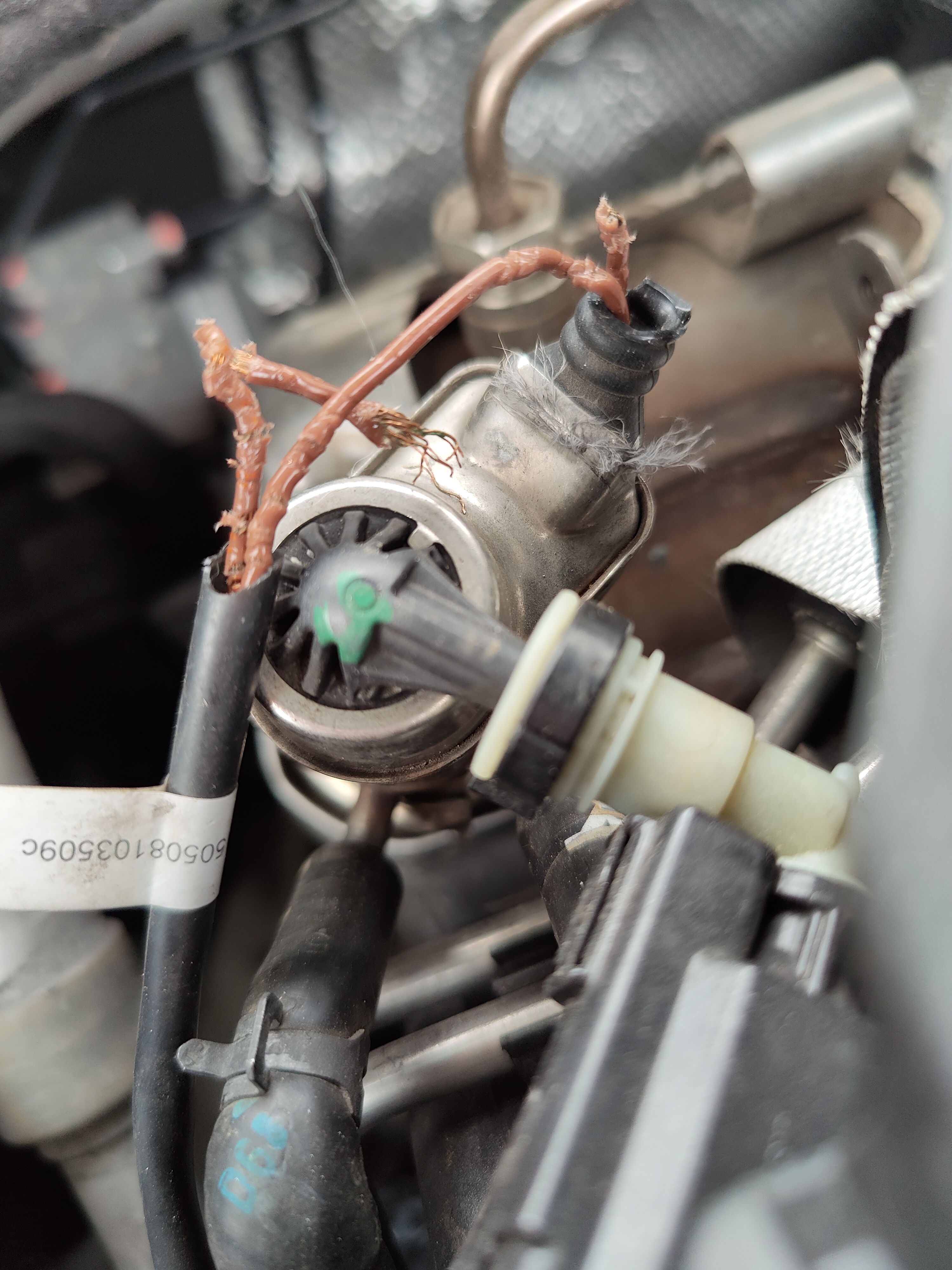

I can see a part no: 50508103509c on the label attached to the cable - but that comes back as a window switch - maybe we are missing part of that part number from the label.
Thanks and sorry I should have said, I tried full number F01C410125150508103509c but google says "Your search - F01C410125150508103509c - did not match any documents."

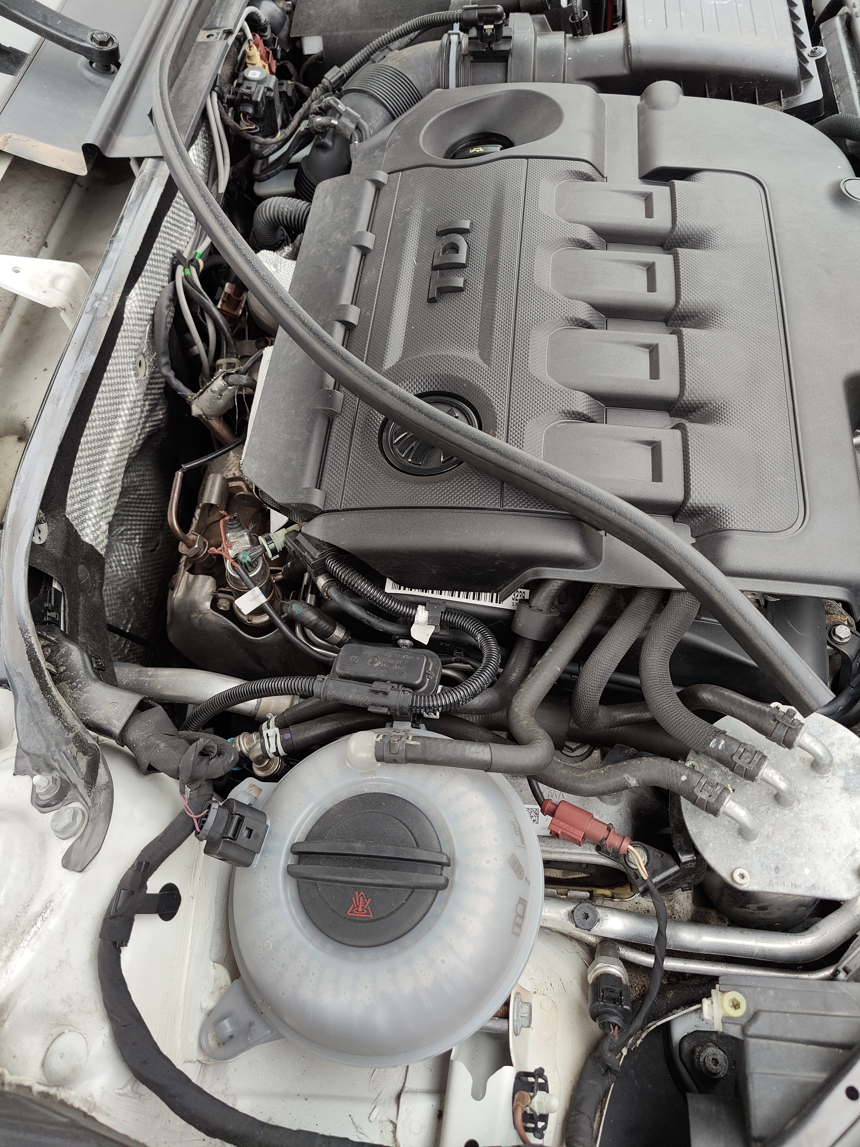

Another view in case it helps to identify the part:

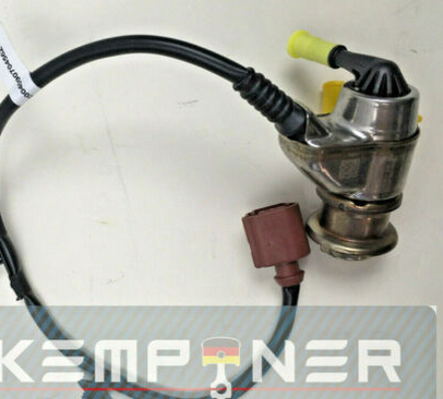

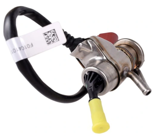

Adblue injector.  Range of VW part numbers - VW 04L131113P 04L131113K 04L131113L 04L131113R 04L131113G
