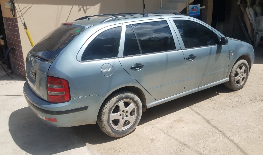

i uploaded a picture, i t think they are of magnesium, aluminium?
They are sand cast aluminium, like most alloy rims.
They are not magnesium. Magnesium would corrode (rust) easily, and are more suited to racing cars than road cars as they are not durable enough for road use.
Expensive cars like Ferraris and Porsches, will use forged aluminium which is stronger and lighter than sand cast aluminium but much more expensive.

Your suspension looks quite high. Does it have the +15mm off-road suspension option? This might be a standard option for cars sold in the Caribbean, due to poor roads.
Oem raised suspension? Wonder If I could find a set of those for my mk1.
