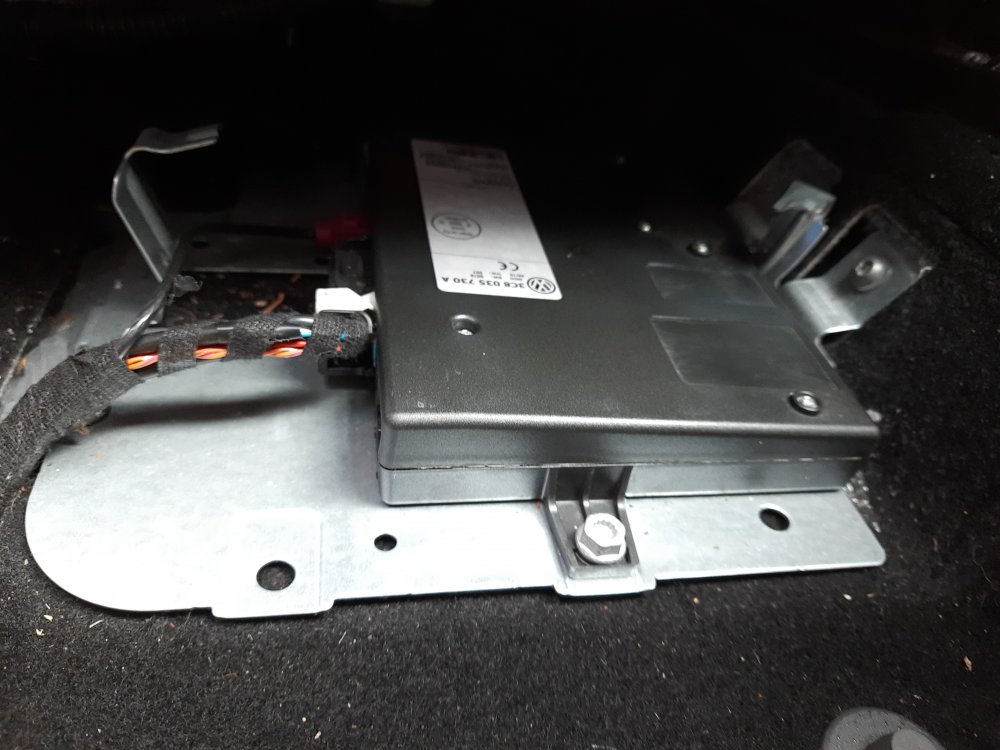

Thanks guys, I knew I'd find the answer from the ever-helpful BRISKODA forum! I found the BT module under the seat as you said, disconnected it, and no more messages asking me to connect the phone - and no error messages either. As usual, the only problem was finding how to unclip the connector; for the benefit of those who may want to do this too, there is a small black locking clip behind the big white retaining clip which has to be depressed (I used an electrical screwdriver) and then the white clip can be lifted all the way to the back and the connector pops out. Photo attached. Thanks again for your help.
