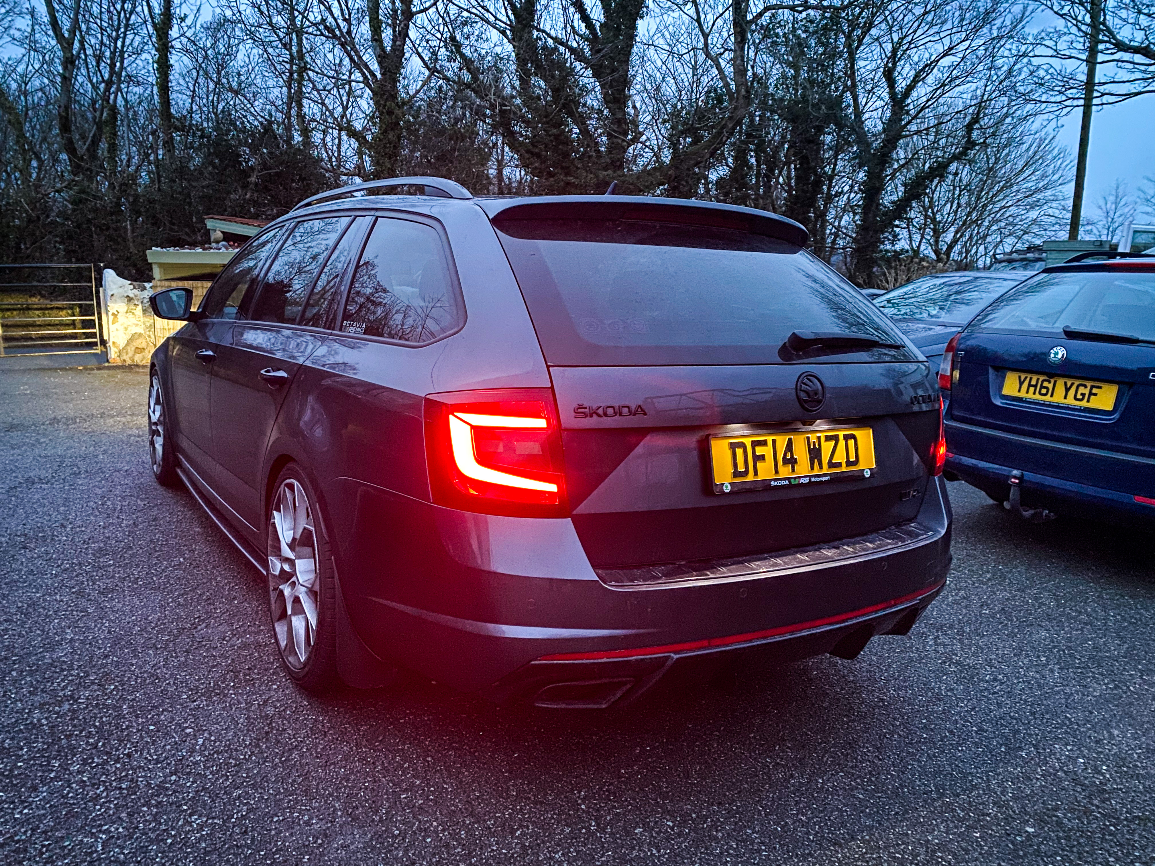

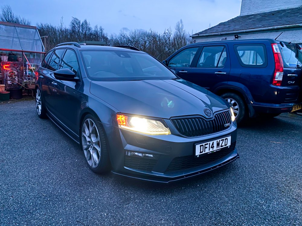

I still have 20mm spacers on the back with 19 x 8.5j et43 and the wheel sits perfectly flush with the arch and no scrub. Cars lowered.
I used 25’s on the rear of my PFL Estate, lowered, and it was about as far as you would want out and it worked flawlessly.
Your vRS sat perfectly Sasha.
What spacers did you have on the front?
Thanks, had 20mm on the front and 25mm on the back plus 40mm H&R lowering springs but I only went 20 on the front for the brakes.
