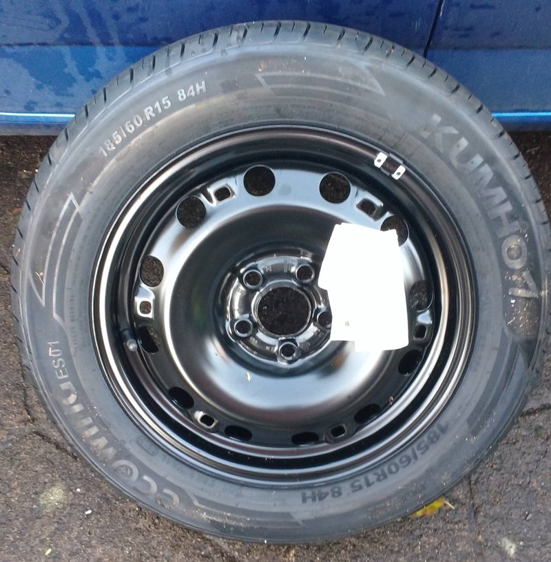

You might find that one of your four normal wheels/tyres will fit. Have you tried this?
The Fabia can come with two spare wheels/tyres.
A true space saver, narrow, skinny, speed limited one.
A Steel 6j x 15 wheel with a 185 60 15 tyre fitted.
This can be the same size as the wheels/tyres fitted to some Fabia III's
Don't forget you will want all the kit as well, the jack, wheel brace tool holder etc.
Thanks, AG Falco
mytyres.co.uk are listing Alcar 6664 6Jx16 ET35 steel rims from the Skoda Kamiq/Scala which could be used as a spare when fitted with 195/50R16 tyres, on the Fabia MK3. 195/50R16 has the same outside diameter as 185/60R15. The latest Vredestein Quatrac tyres are available in this size.

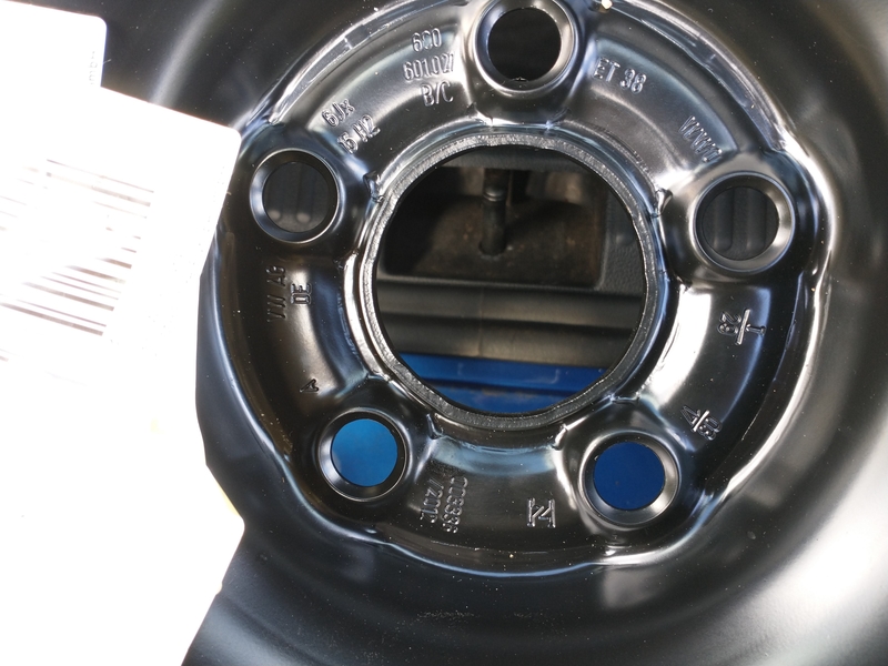

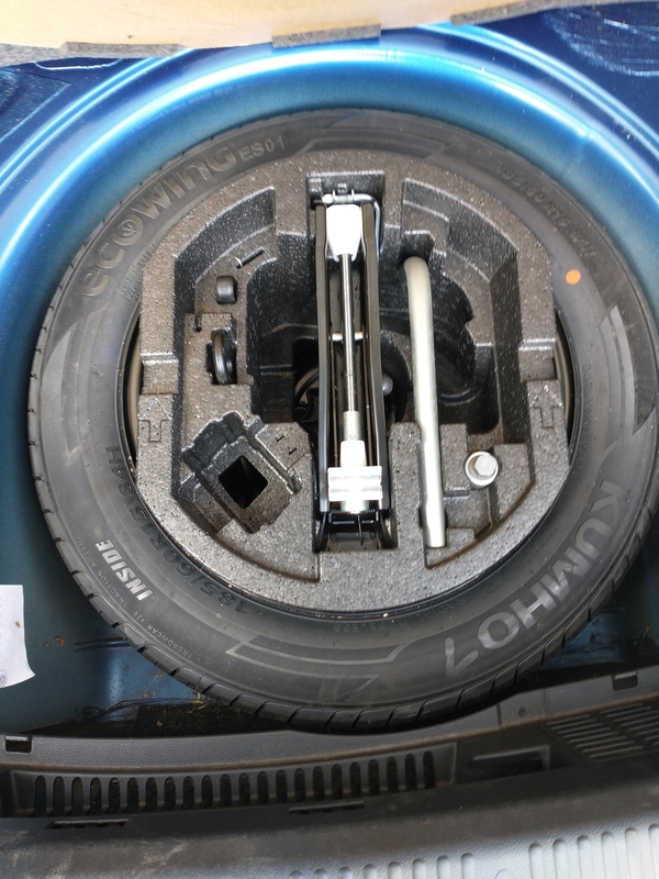

12 hours ago, Jim H said:
This is what we got when we asked for a spare before picking up the car.
1747081344_img_20191201_143803205--2edit.thumb.jpg.8e678e8f80b226e78e7e3d840e7290cd.jpg
Maybe you could confirm that the dimensions of that wheel are ie, is the ET 35 or 38 it should be a 6J in width, also the VW Group part number just in case the OP can buy one cheaper locally than via mytyres as there will be a delivery cost to add into their price, worth checking what the all up price is though for getting a wheel+tyre, as said non directional. I've used mytyres a few times with no problems - if you go down the steel spare route.
