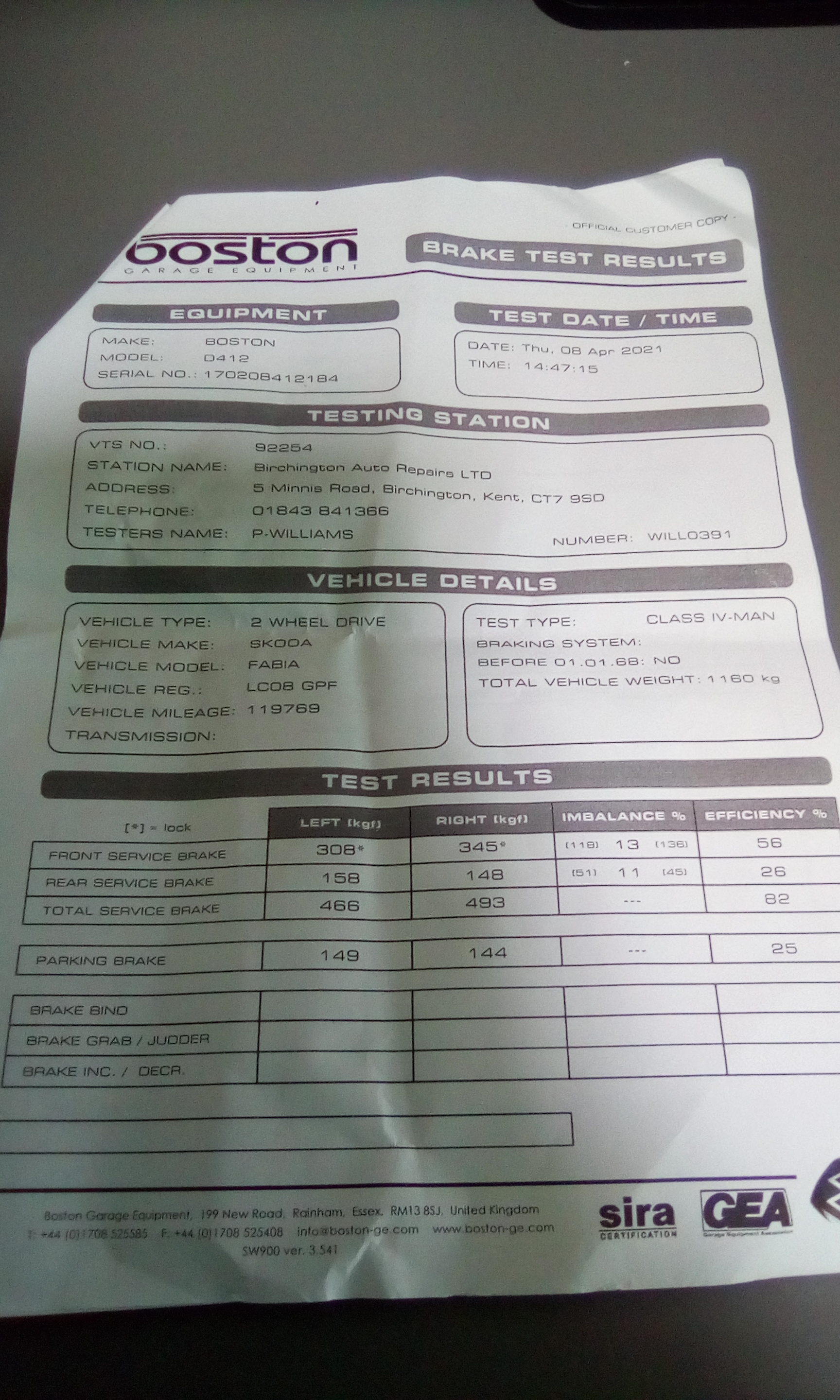

    I can explain for you..........   The Brake requirements for the vehicle is 58% of its measured weight over ALL 4 wheels, so yours achieved 82% which is BOTH axles added together

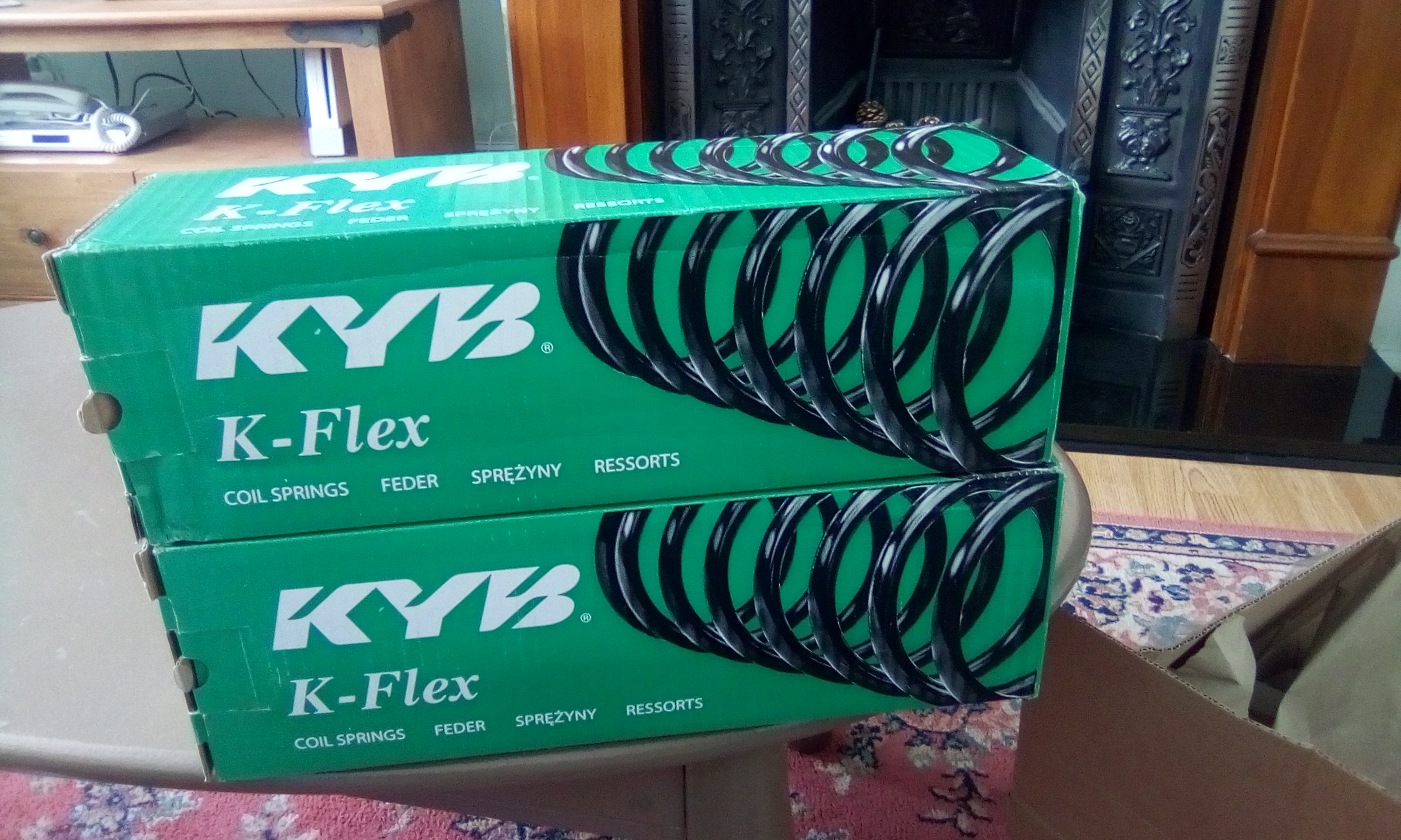

They've arrived!
Thanks Parts In Motion and Fed Ex.
Tomorrow the fun begins.
You might want to carefully take some measurements and write down the specification of each spring. This is so that if you notice a problem after you have fitted them, you can refer to your notes. For example, if one side is higher than the other, if the back end is high or low, if the ride seems too hard or too soft, etc.

Ok Carlston, thanks will do.
They've both got the same code RA5136 on boxes. Annoyingly ones got a chip in the protective coating.
Just put them on a flat surface, they look the same height. Both have 8 coil turns.

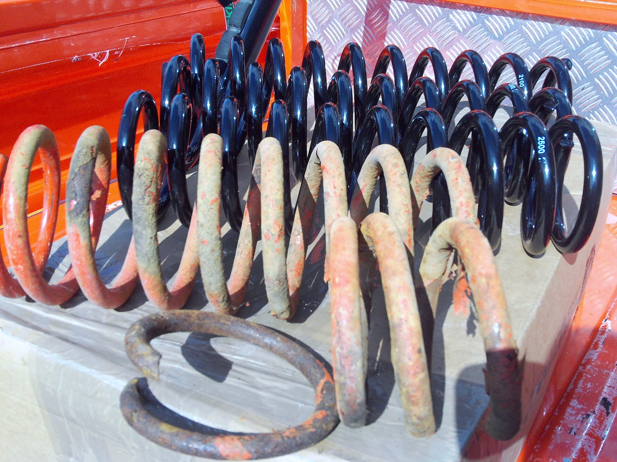

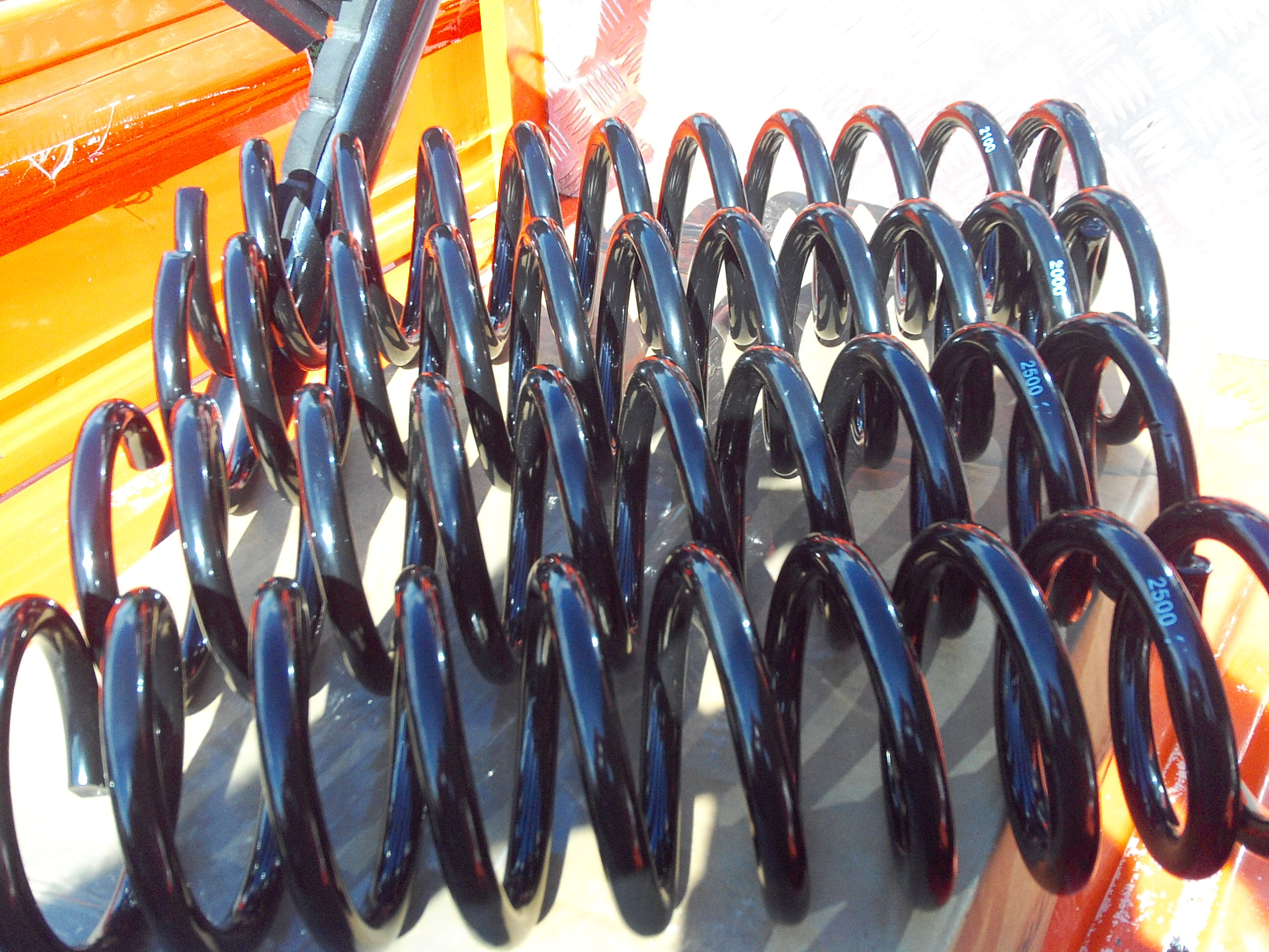

Well , job done and both springs fitted. No real probs apart from cleverly supporting car on axle stands on rear beam then realising needed it to move to get clearance. Old springs came out without needing spring compressors, thanks to all who said not to bother buying them.
Replacement springs had same number of turns so that's good.
Pictures below:
The offending article , and a few useful tools to make life easier. Head torch from Tool Station £10. Absolutely love this, charges off usb so no batteries needed, no more faffing about trying to balance phone torch. Aldi impact driver £20 bare, got a few of their cordless tools. Still crack nuts off with breaker, then use this to unwind, great time saver. Lastly socket converter from Tool Station £4.

Presume you mean because of the difference in colour dots . The replacement springs had no dots, so I'm presuming ones I've replaced were the originals. Not bad then for age of car.

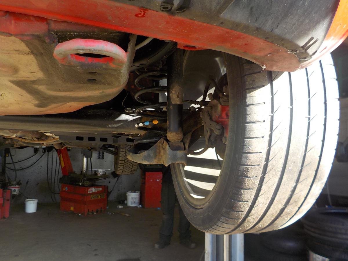

It looks like the coloured dots are 1 orange, 2 blue, 1 white.
1 6Q0511115AF coil spring
for vehicles with lowered running gear
1 paint mark
2 paint marks
1 paint mark
orange
blue
white
Model data: PR-0YB

Got new style brake test report with mot cert and emissions report. Not seen one of these before, can anyone explain the test results at the bottom, particularly the efficiency section? Doesn't look brilliant to me , 25% efficient on park brake yet still passed?
Unfortunately garage has been taken over so couldn't ask mot man with Covid restrictions.IMG_20210408_164053.thumb.jpg.a9bbda25c70458e1795fd11ae491278d.jpgIMG_20210408_164053.thumb.jpg.a9bbda25c70458e1795fd11ae491278d.jpg

Re the brake figures, someone else will explain better than me but its a function of how many kgf of retardation before the wheel locks compared to the recorded weight of the vehicle, the rear brakes on a FWD do very little work before locking up, I would say that yours are in excellent condition.
Why?
Because you have the same figures for the handbrake as the footbrake.
The pass figure is 16%
Ok, thanks JR, I didn't interpret the figures the way you have.
Be nice if vosa had a guide on the back of the report to explain the parameters in layman's terms.
My first thought on seeing 25% with the pass rate set at 16% was just scraped through.
