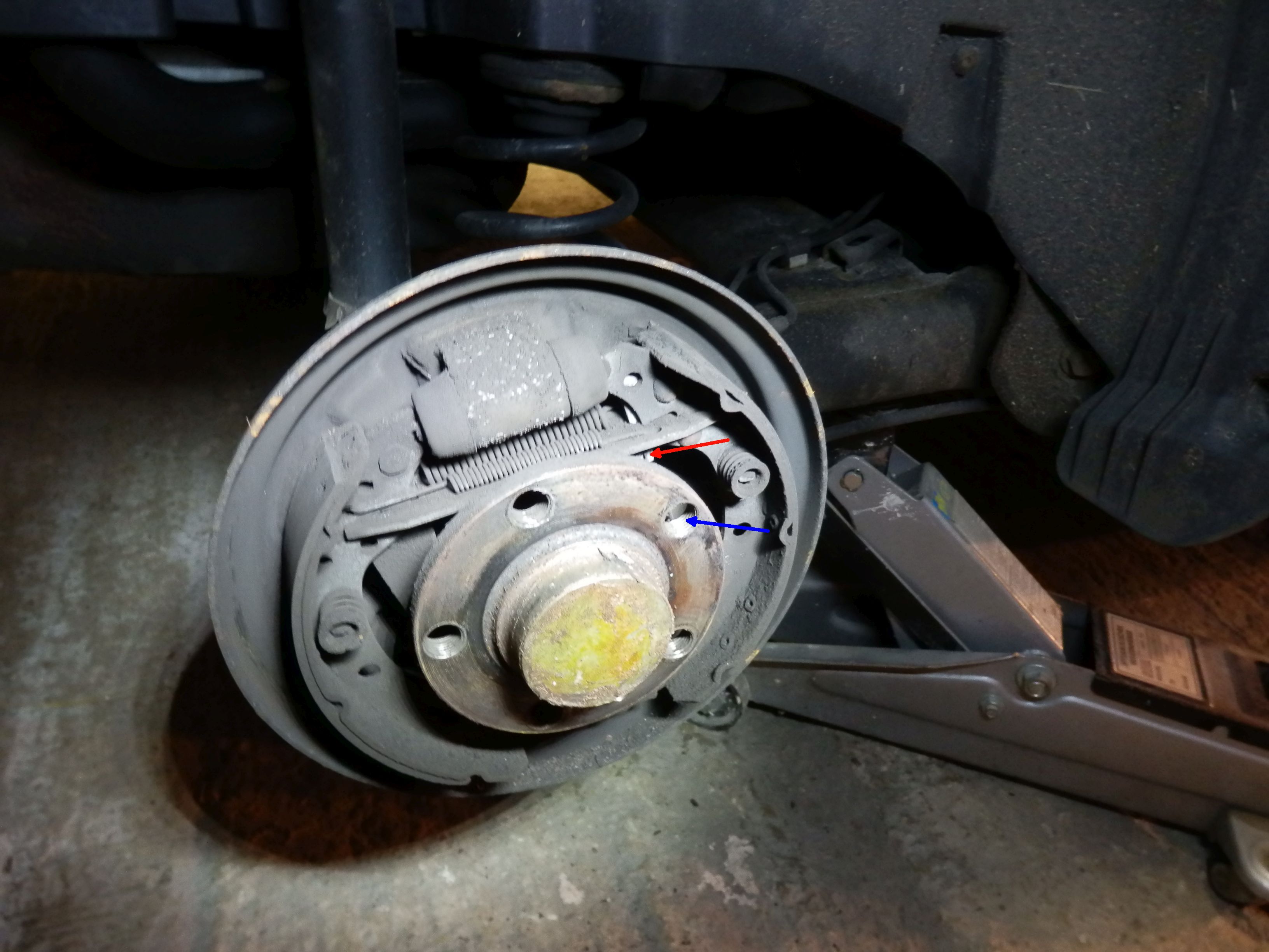

I changed the rear springs on my daughter's 2009 hatch F II 3. I used a spring compressor and loosened the dampers at the bottom.
I have attached a picture of the rear drums. The red arrow shows the adjust which you have to push up with a screw driver through the wheel bolt hole in the 2 o'clock position on the right - blue arrow - and 10 o'clock position on the left.
Thanks 26DIPP, always helpful to have a diagram / photo.
