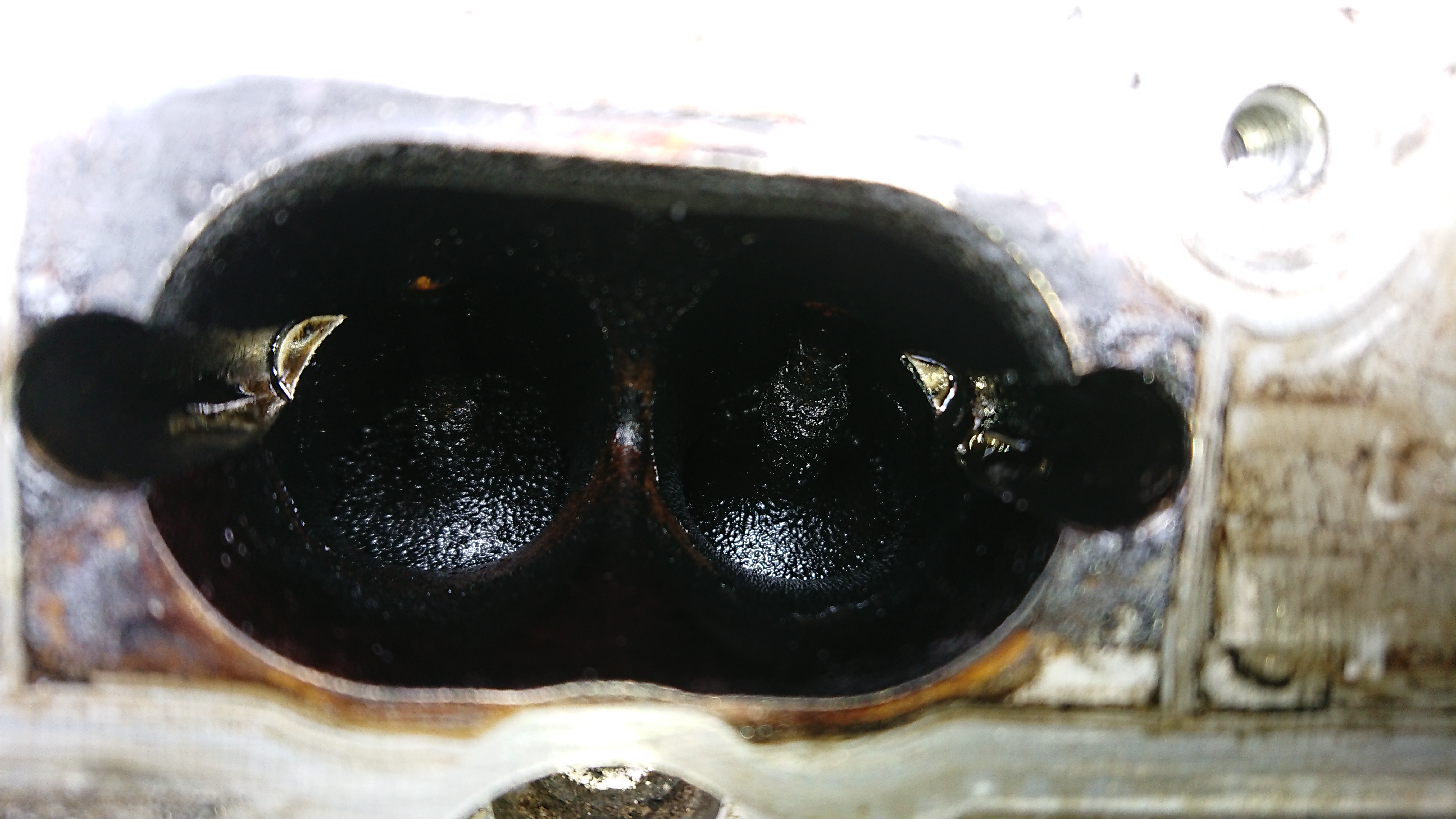

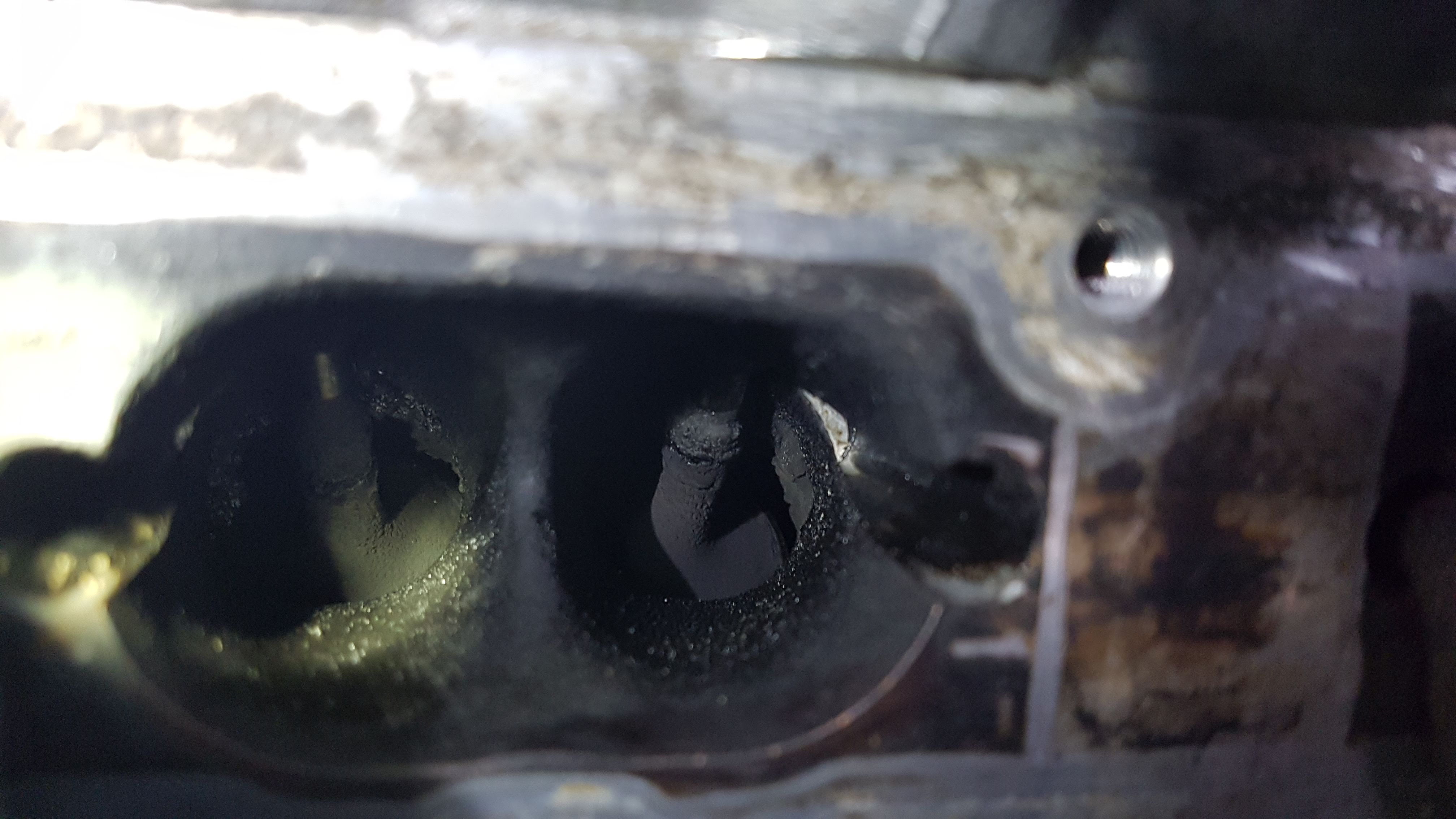

Pretty coked up and a little wet with oil
There was a significant amount of oil in the inlet pipe to the throttle body.
Going to clean the valves up today, but a little concerned about the oil.
Is it only he faulty injector ports that look like that? Wet? Cylinder 4?  I suppose fuel may have soaked in and around the cylinder? And leached to the intake port?
I think I knee jerked a little with it being wet.
Ultimately its burning an in spec amount of oil.
I've watched some vids, and oil in the intake is very normal on these.
As long as you aren't burning loads of it and you aren't smoking, should be ok.
That inlet is not number 4 (the stuck open one). They all looked similar, big canon build up.
They are all much cleaner now and ready for the injectors to be replaced.
I dropped the oil too, and it's not significantly contaminated. Flushed a litre of fresh through to get any left in the sump.
You may have a PCV failure or not operating correctly.  Mine were gummed up as are yours.  Not as clearly as "wet" though as yours seem to be, unless it is the photos.  Especially on the port separators and valves themselves, it was kind of a dry crusty surface with gummy consistency underneath!
How much oil are you using?
Edited by TheClient
Nah, not the photos. Mine all looked significantly wetter/slicker than yours.
Using about 1L in 1000 miles, but think its been getting worse recently, tricky to say.
Anything it could be besides the PCV, and how to test it? The hose coming off the PCV to the inlet manifold wasn't particularly oily, but the intake pipe from the turbo to the TB was very oily. I hope this isn't a sign of turbo failure!!
Also, not getting any codes to suggest the PCV is failing, or any codes at all until the injector failed...

Showed your pics of the IM to my mechanic and he believes that your valve seals are shot. That's where you're losing oil and it's getting burned. He compared your picture to the ones from @TheClient and you can see a shiny bit on the valves in his, meaning the seals are intact. On yours it's all black so he deducted they are done. Unless the pictures are misleading!?
Saying that your PCV might be fine but that means that your engine head might need work which is not good as the cost is greater.
Also, my mechanic said that you'd have a vacuum problem given this (PCV would not work as it should) and you should have noticed that your engine is not running smoothly prior to this, even though it'd still have pull (while burning oil).
Not sure I can agree given the amount of oil in the inlet manifold itself and around the injectors I'd think it's coming from the intake.
Also the compression test was spot on. It's also not excessively smoky.
Also looking closely at all m pictures I can see a little shiny bit at the top of each valve with no carbon.
I'm highly suspicious of my PCV, the fact I've been idling on 3 cylinders intermittently, the fact the idle doesn't return quickly when blipping smooth running engine. The fact it's $10.
