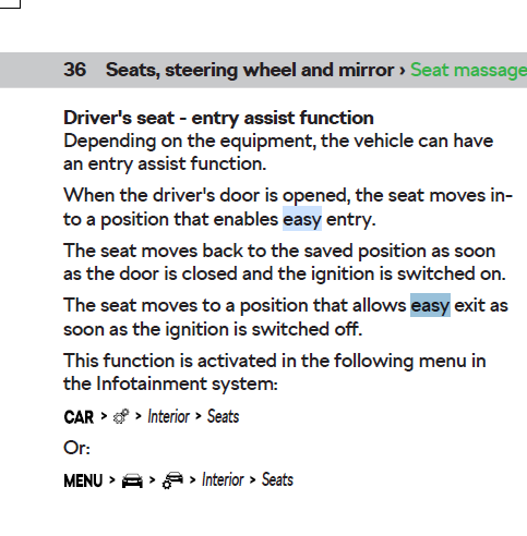

BTW, I remember I have read somewhere that seat goes back to get in and out easier and then goes back to position? is this correct?
Correct. It's an option somewhere in the menu.

so i did not found that setting.
no worries, and as far as im aware it does not unless you have a certain optional extra, the reason it would of worked before is because the seat was going back to original saved profile on guess account

I think it comes only with the full option Ergo seats. Which seats do you have?
Just now, TheUltraRunner said:
I have it. ;)
middle option, no alcantara :crying:
3 memory options no massage,
Mhm. This could be the reason. Here in Slovenia we had only two options for the RS model. Standard seats or the full option (Ergo) seats with alcantara, etc.
