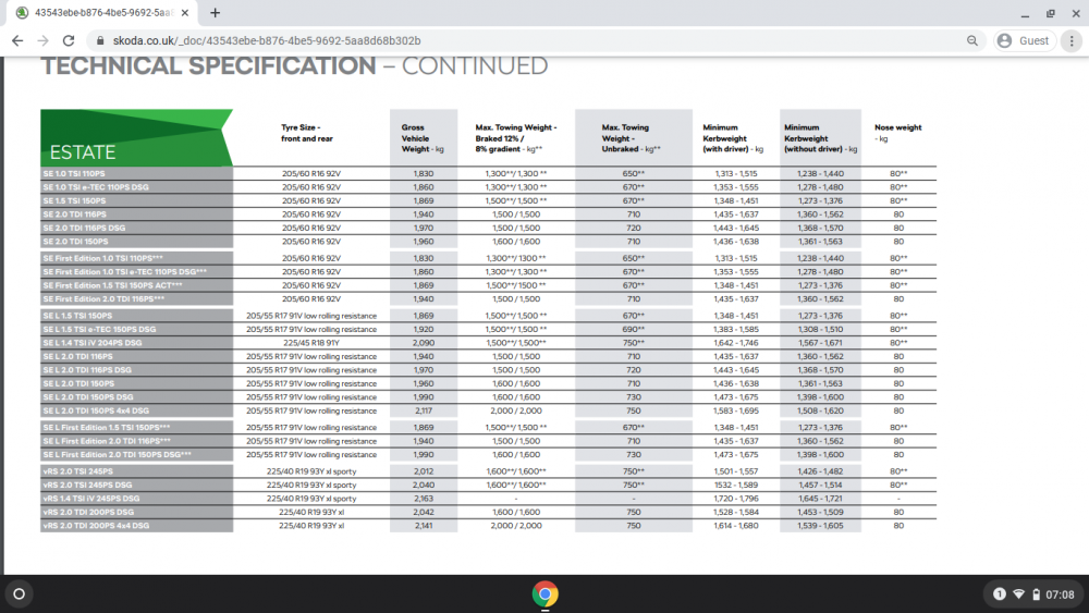

Stupid question - What makes a car more suitable for towing over a similar model where both cars have the same chassis, the same brakes and only the manufacturer's approval process differs?
the size of the rear springs and  the size of the radiator and cooling fan these items are beefed up for a tow car
^^^^ That is a wrong assumption to make.  Some vehicles ordered from the Factory with Tow Bar Preparation or the Towbar factory installed might indeed have a upgraded cooling system, engine, gearbox and more suitable springs.
But vehicles might have a plated max tow weight etc and be exactly the same as ones that have not have a given the scores on the doors and can not have a towbar fitted and legal tow.
What VW group and their Brands and what other manufacturers do can be very different.

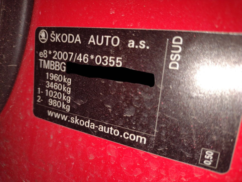

The VW thing about not having Towbar prep and you can not fit a towbar to tow (or even for a bike carrier) yet the car is plated with braked and un-braked weughts allowed is the cause of much confusion.  Often caused by Main Dealers employees, sales staff. service staff.
Yes dealers don't seem to know anything about 0kg gross train weight
