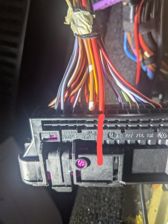

Could not find the problem.....mainly cos I can't read the wiring diagram!
What I do know is there is no power for the red wire at the plug in the A pillar. It's the one identified with red line in the pic below..
Where the power comes from inside the car to there  is a mystery to me!

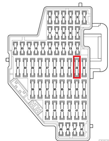

Can you confirm that in the cabin fusebox, top row of full size blade fuses, 2nd from right is intact?
If you are referring to fuse No.2 5A - yes it is.
  • Sponsor
No, fuse 23, 30A.
Take a photo of the one I'm describing.
Is there not a couple of rows of mini-blades, then some of full size, then a bottom row of minis?
I'm talking about the first/top row of full size.

Oops...my bad!
Yes fuse 23 is in tact...BUT....when was testing it insitu with my lead light, the top point of the fuse had power, but the bottom point did not.  I wiggled the fuse and low and behold there was power!  So this seems to me that the bottom retaining fitting is 'loose' and maybe is the cause of the problem.
