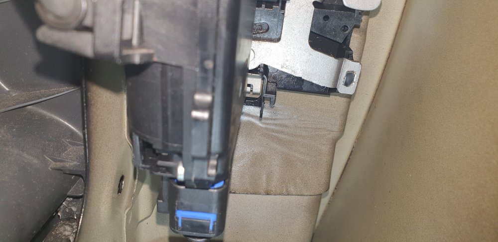

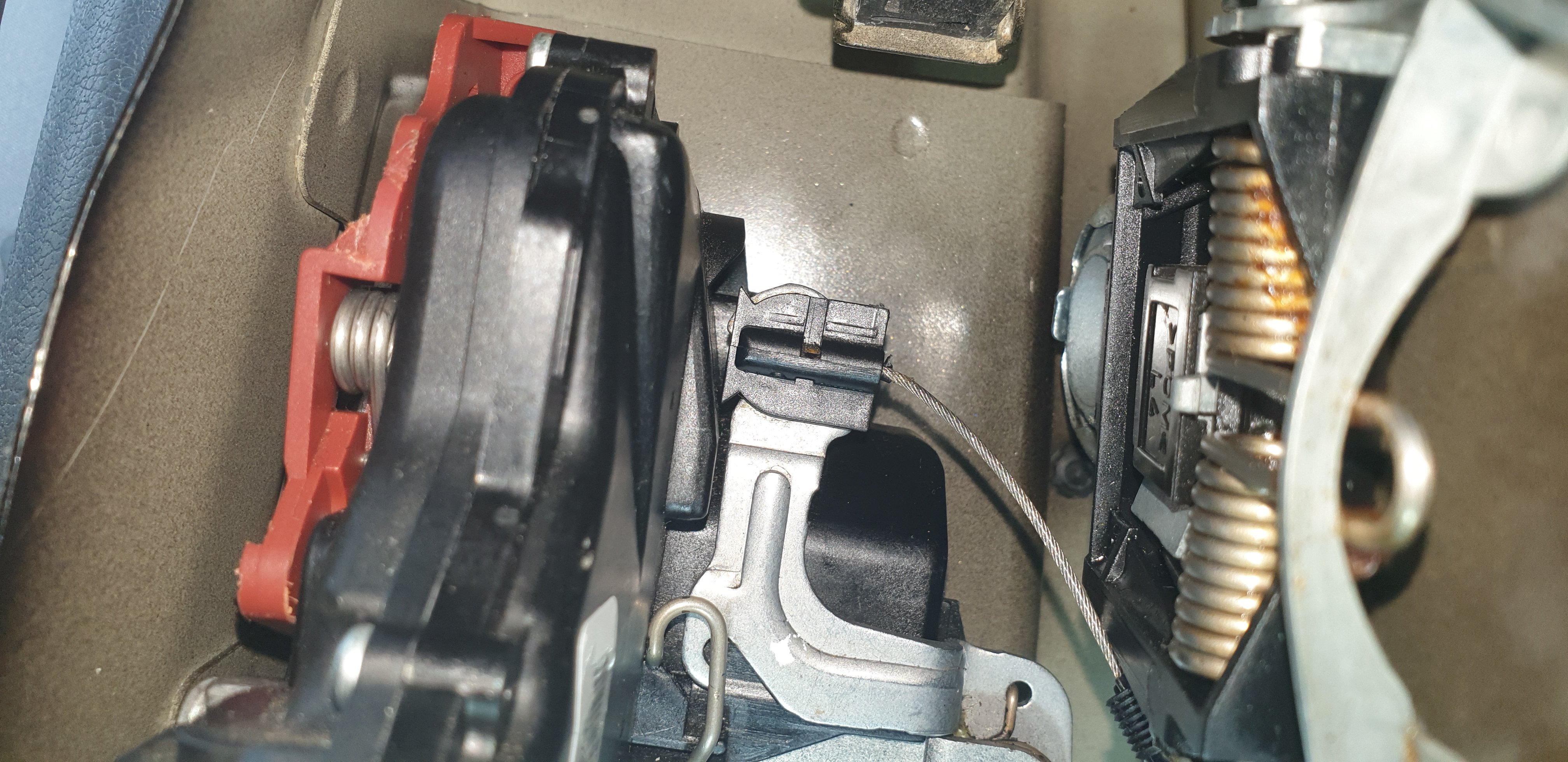

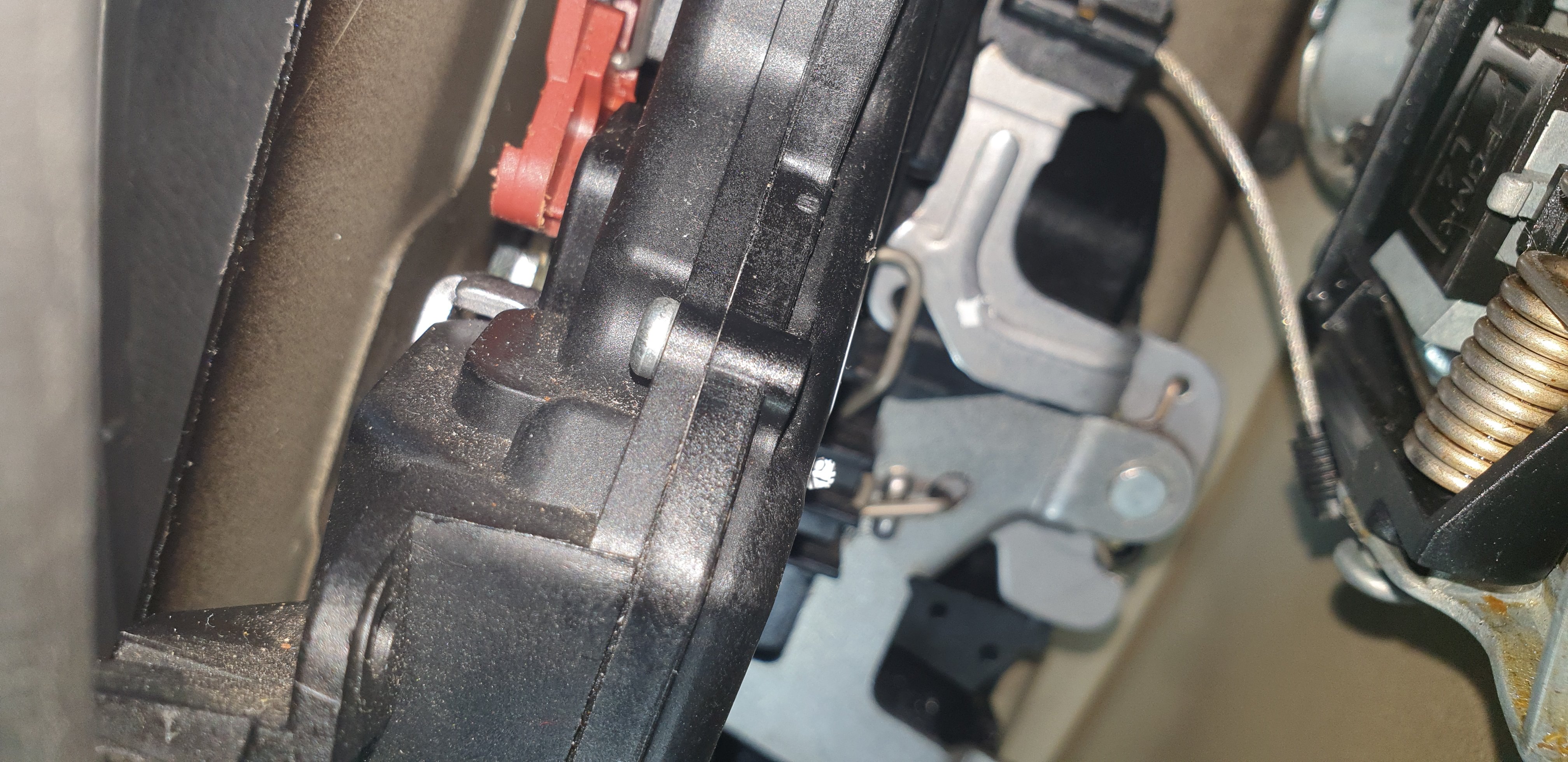

Ive got a bit more access to it now so perhaps with the photos ive taken you/or anyone could tell me what i could/should do next.. the door is locked closed so bare in mind i cant open the door...
Ive pulled off the cable which i guess it the external door handle cable..
What i was hoping to find is either something on the actuator that turns or pushes something that i could reach to mimic the actuator
I might not have described the problem very well.
So with access through the door panel i need to get the deadlock to unlock.
The actuator isn't doing that so any one know how to do that manually?
