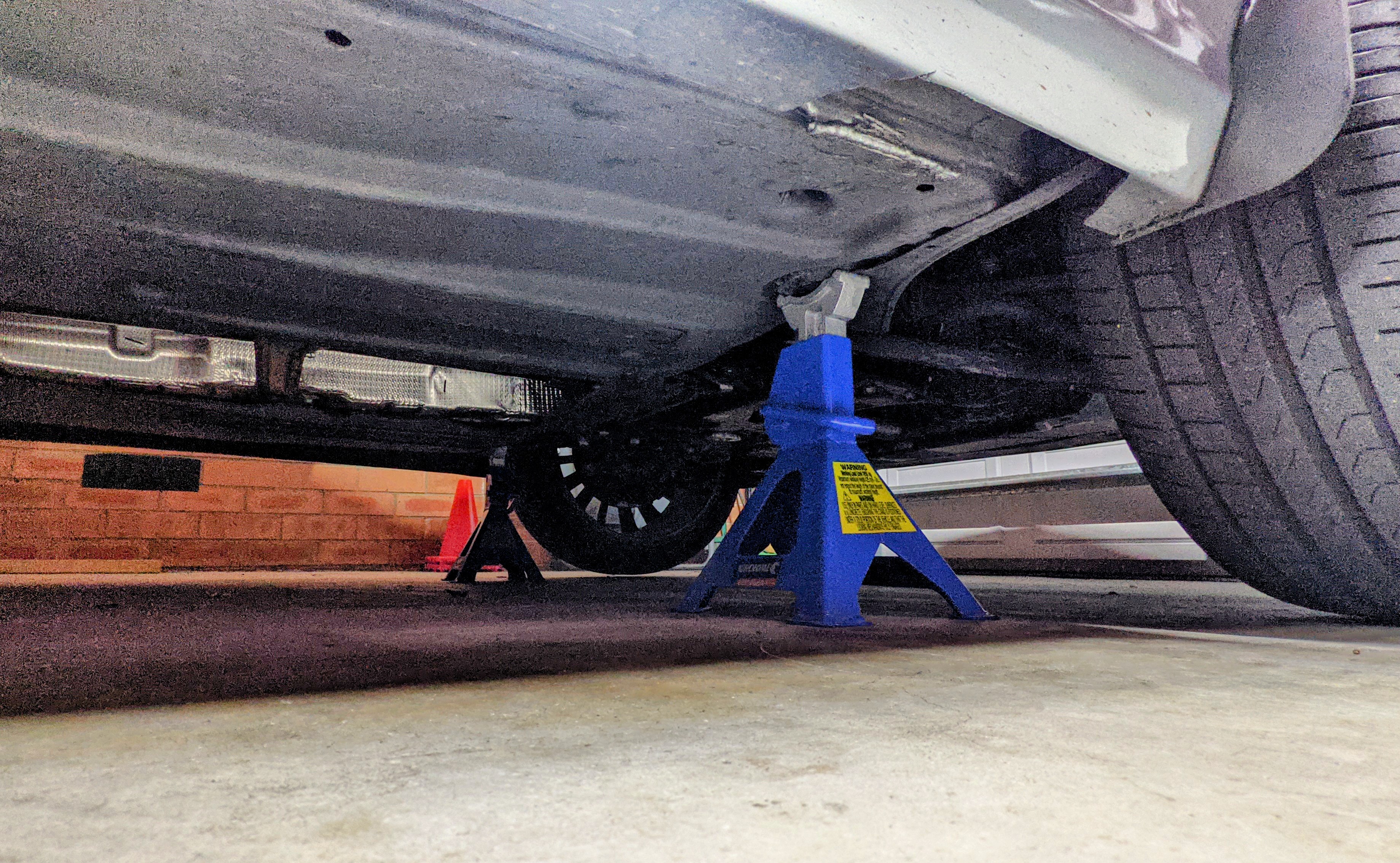

I asked about this not too long ago
3rd reply, 2nd & 3rd picture should help you
Front....
Rear. Remove plastic cover first.....

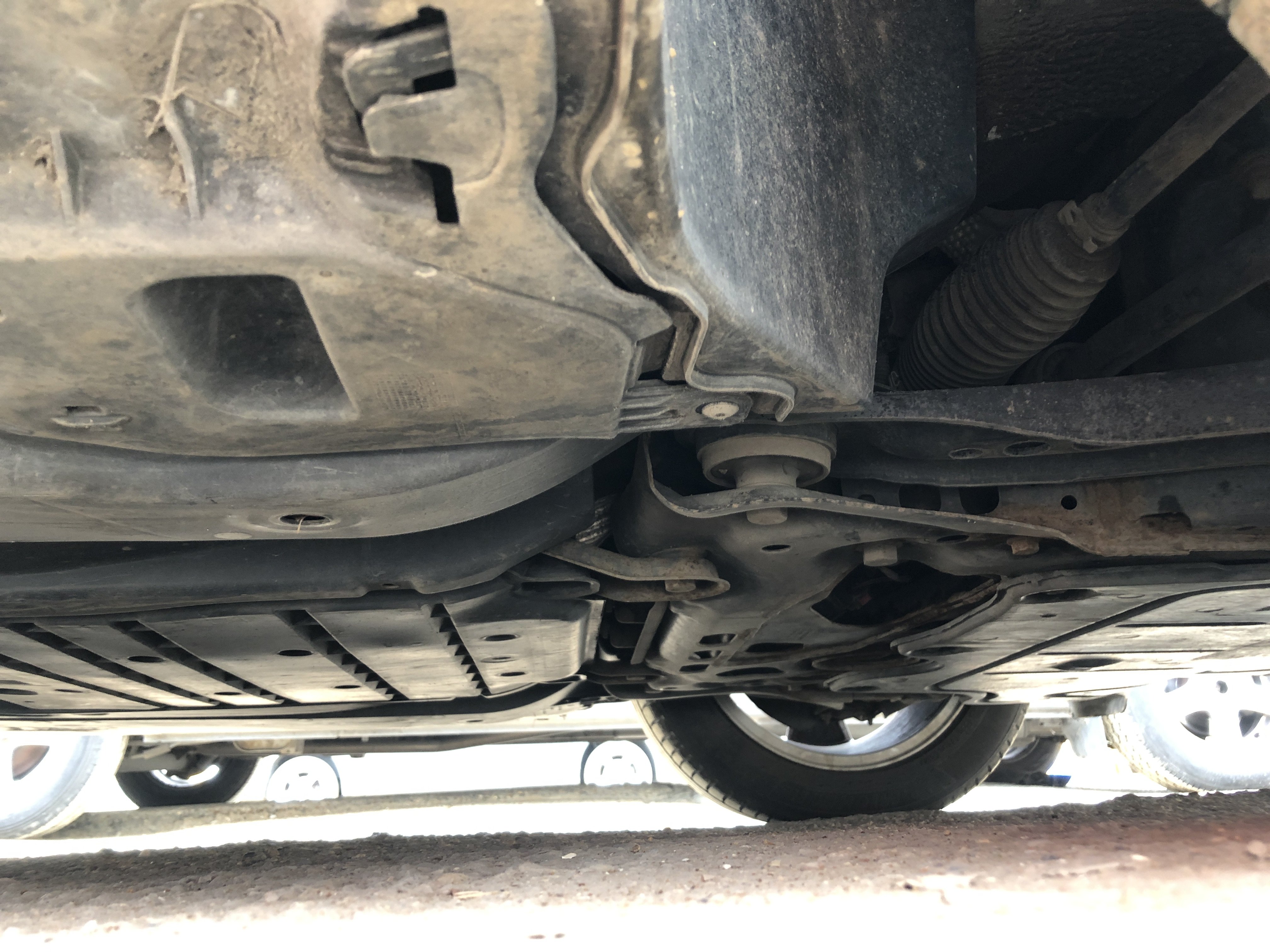

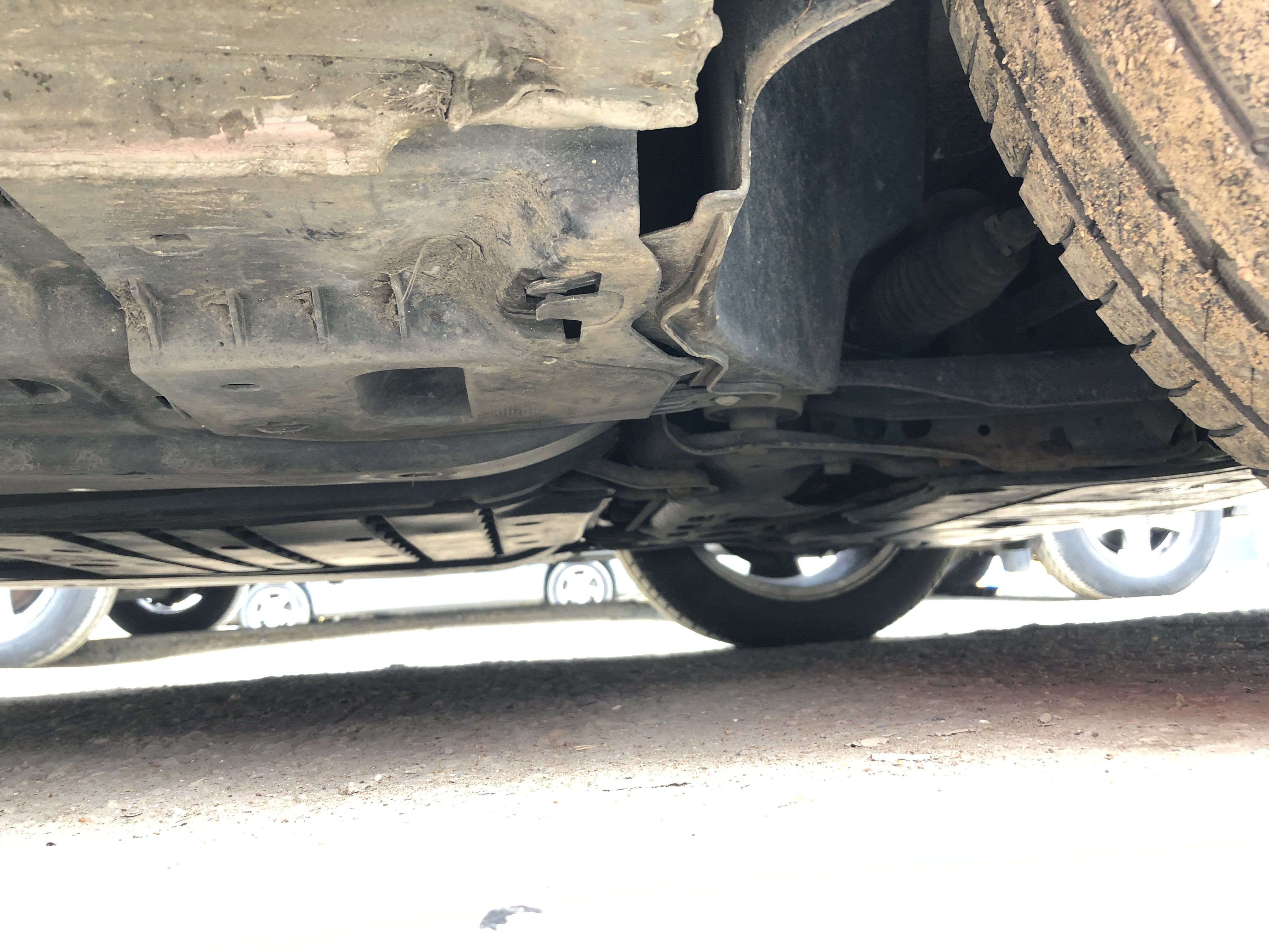

Not sure where is the safest point for axle stands, a lot of plastics underneath
I am thinking about here 😒🤔
@The1effect - i was wondering why the underbelly of ur car looked very different to mine, including the wheel-arch liner where it meets the underbelly.......then i noticed ur profile says u have a 2016 Octavia SE L.
sorry - i don't know where the axle point r on the mk3 Octavia.
u should ask the question in the mk3 Octavia forum.
this is how it looks, close-up, on the mk3 Superb......
Edited by JR RS
Ok thank you
