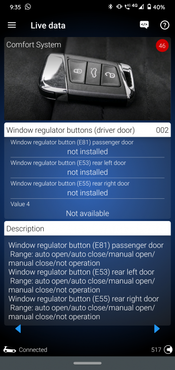

I've had an issue with my electric windows not working for over a week now.
On obdeleven it's showing as the buttons aren't installed, could this be a coding issue, or a faulty switch.
Also does the main window motor control the system, so if that gets faulty the whole window system stops.

It's just the front two are electric (I think I'd prefer manual windows all around)
That makes sense about the Lin bus, I noticed they was a circuit board in the motor when I was checking all the connections. It's starting to look more likely it could be the driver side motor, I've seen one with the same part number on a VW breakers site for £50 which is quite cheap from what I've seen on eBay.
When I reset the battery it will work for a short while and then crash and both windows will be non responsive with no attempting noise.
It happened when my battery died one morning, it had been going for a few days and I replaced it on the same day it went.
Could the drivers switch have a similar problem where it could crash both sides if it's faulty, or is it likely to just be the motor.

I think I did, I had my manual downloaded as pdf, but I've got my actual manual out and it shows about the key indoor method and said about the windows being down :s
after I disconnected the battery i was able to use the passenger window so I used the key method with that window down and nothing happened.
After disconnecting and reconnecting the battery the passenger side works but when I try it with the driver door switch it just crashes both sides.
So I I think I'll try that and check all the wires, there was a few where the insulation had split so I've taped around them at moment, but I think I might take the whole loom out and unwind the tape and have a proper inspection on them and solder or replace any wires that look faulty.
and yeah I agree it's not the best design lol

I read people saying about a faulty switch but I couldn't see it being that, but I seen some for £8 on eBay so I thought take a gamble just in case and if not then I've got a spare, and it's worked :s
I don't know how, the original switch was immaculate and no corrosion on the circuit, so I don't know if something had failed on it and it kept crashing the module :s
But problem solved
