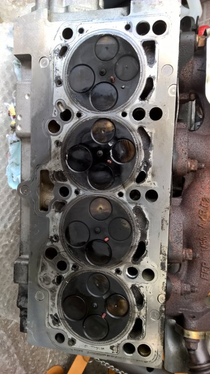

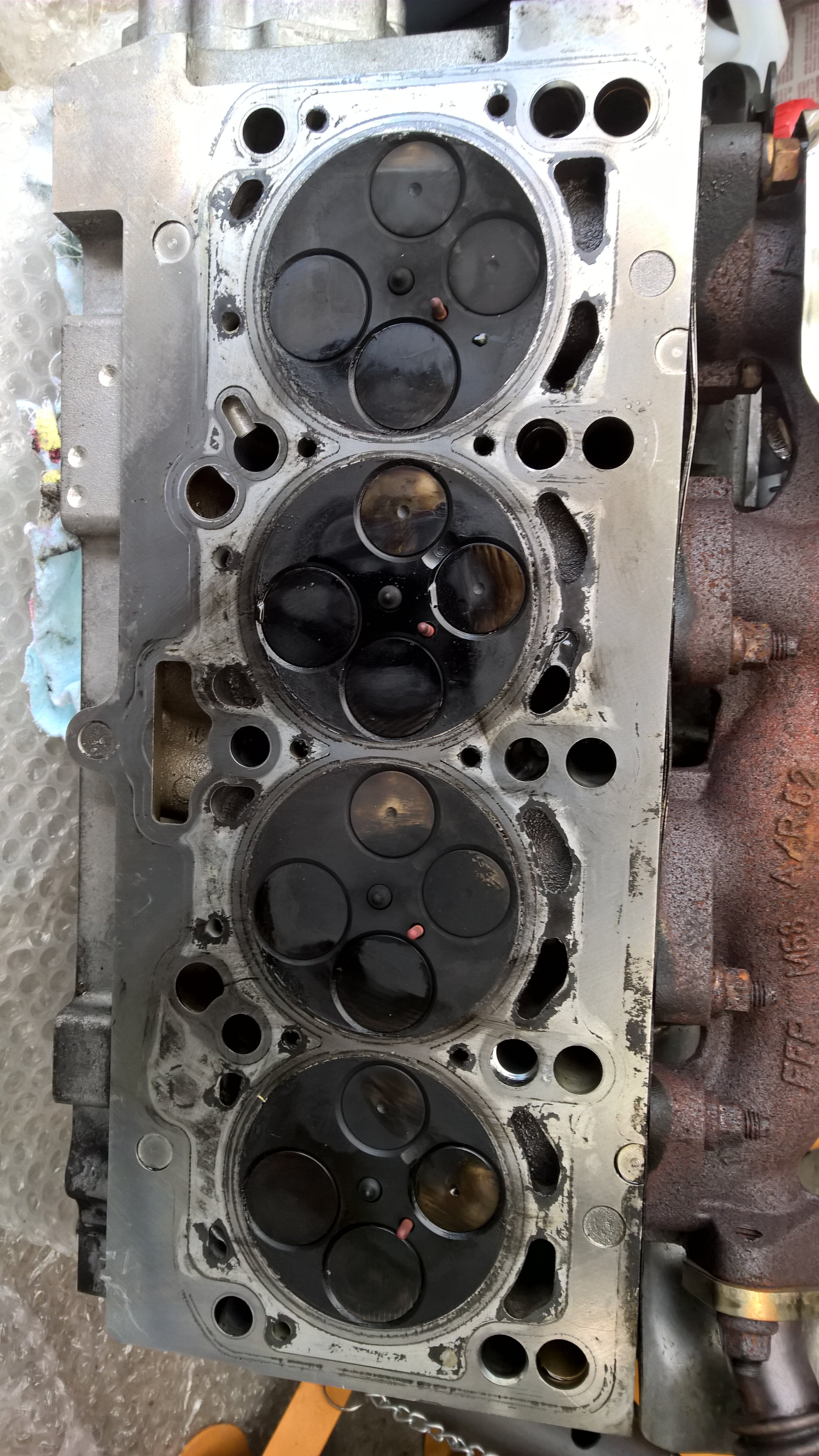

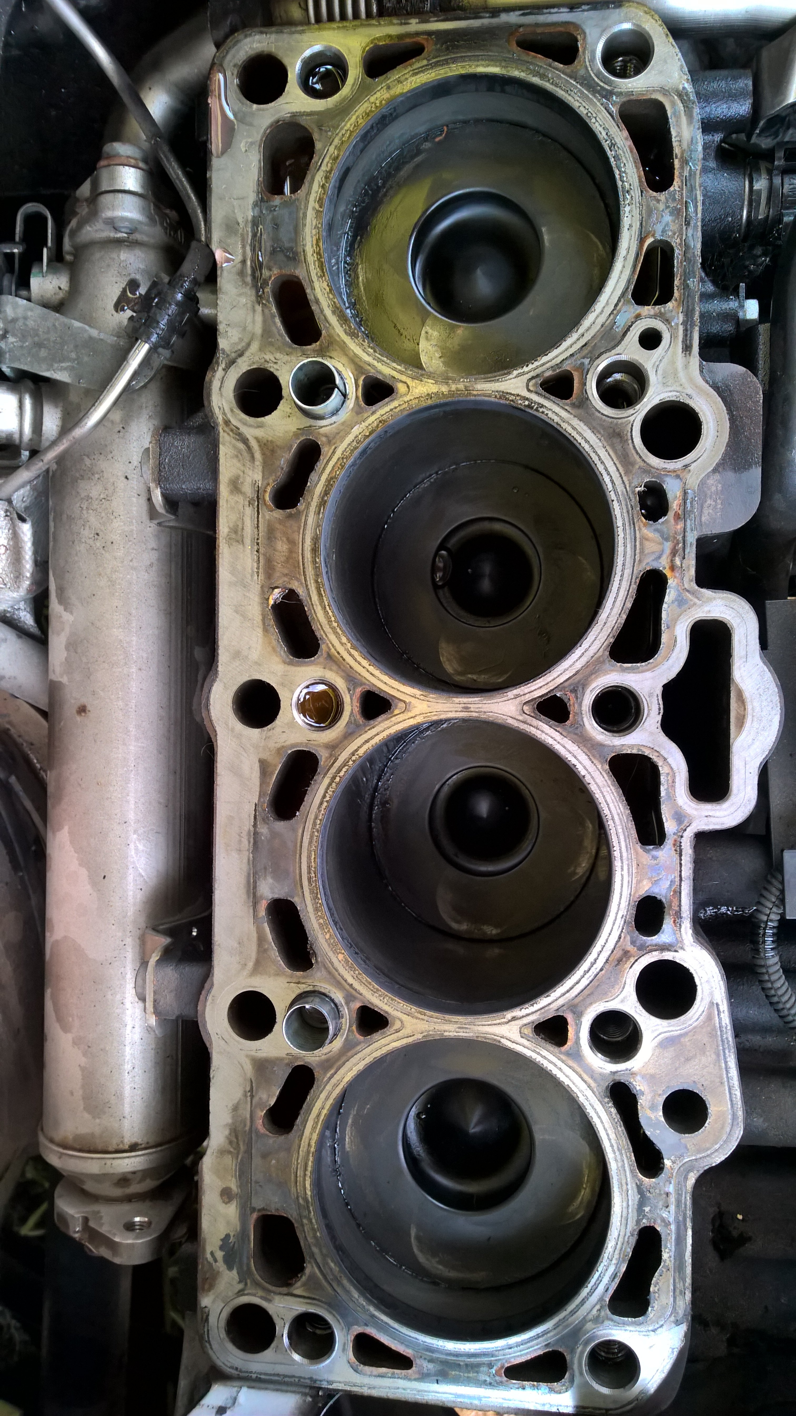

Strip down started, first thing was to put bore scope down inlet side as this is where the sound was coming from, all looked ok...........found it, the tensioner stud had stripped the threads in the head (common problem apparently -, after 3 or 4 cam belts thanks to VW putting new studs in the kits), so when you change the stud it weakens the threads by a tiny amount every time.
Anyways off with it's head, found the inlet valves had just kissed the pistons (not a full on snog, just a little peck), so got the bits to rebuild it, and helicoiled the stud, head had to come of to do that anyway, head gasket was on it's way out, and number 8 head bolt was loose from the factory!!!!.
So rebuilt it and fired it up eventually when the diesel decided to fill the head, and again it was running sweet as.
The two photos show the head and block, I think I was very lucky, and no I did not get a lottery ticket LOL:)
