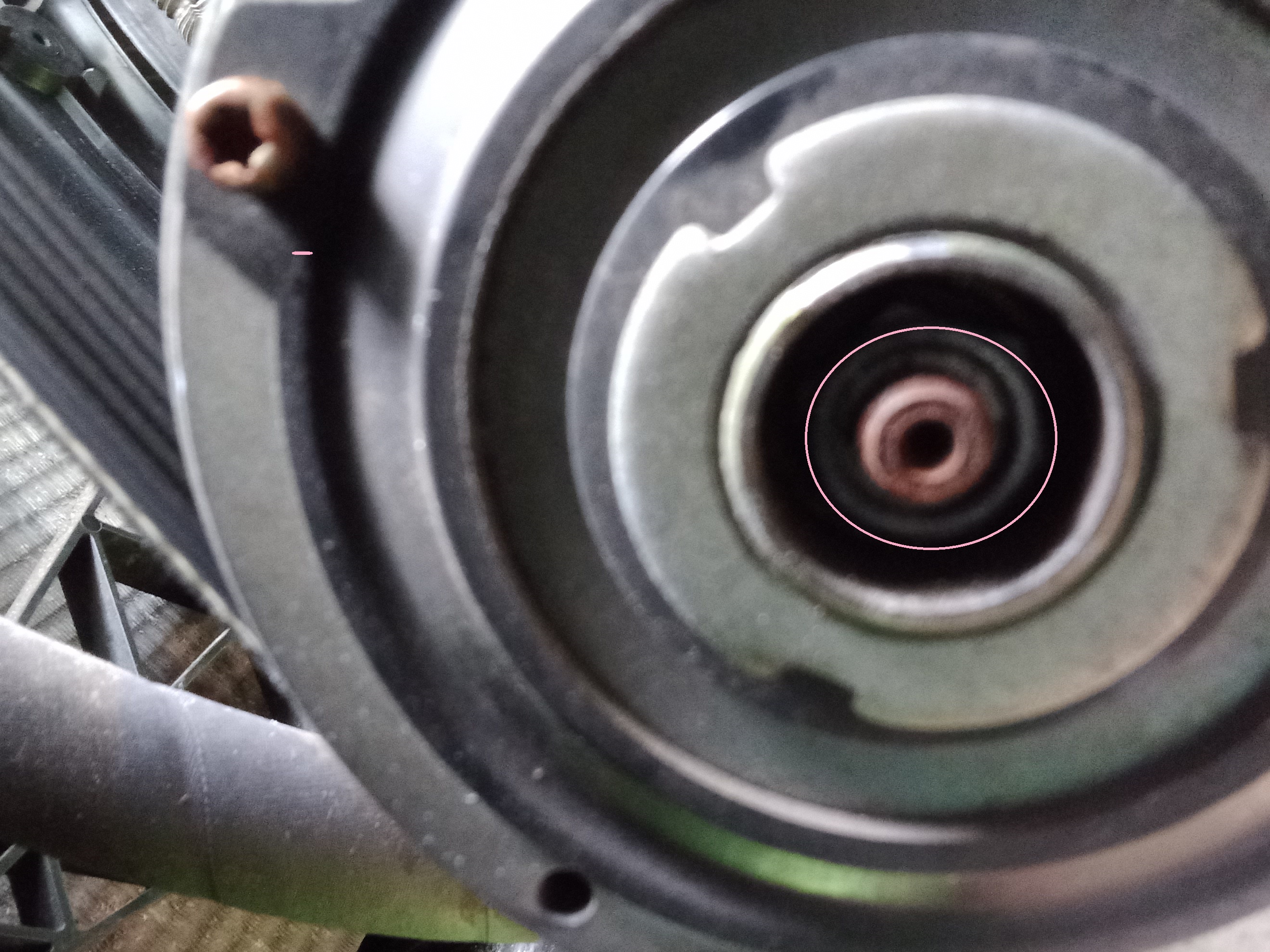

Had another thought re the compressor. On our 06 Megane the compressor has a clutch , which you can visibly see working . As the Fabia doesn't have one ( clutch,)   although it's turning when engine running , how would I know that it's actually compressing and not just turning?

Since the compressor has a shear joint to the pulley the only way to tell easily is to remove the belt and turn the pulley by hand.
Thanks Sepulchrave,, that's a useful tip. Presumably you mean if it's broken the pulley would have no resistance , be easy to turn by hand?

My understanding is that if the shear coupling has broken you'll see most of the pulley rotating whenever engine is running, but the bit in the middle won't be. The bit inside the pink circle here:
Awkward to see but careful application of phone camera on video may help.  This shot is from below, with undertray off.
Thanks Wino, was just about to dig some spanners out to take aux belt off.
The compressor is easily visible on my car, so when and if the Mrs  ever gets back from the shops, I'll go and check it and the fan.

With the engine running , compressor is turning , complete with middle part.
