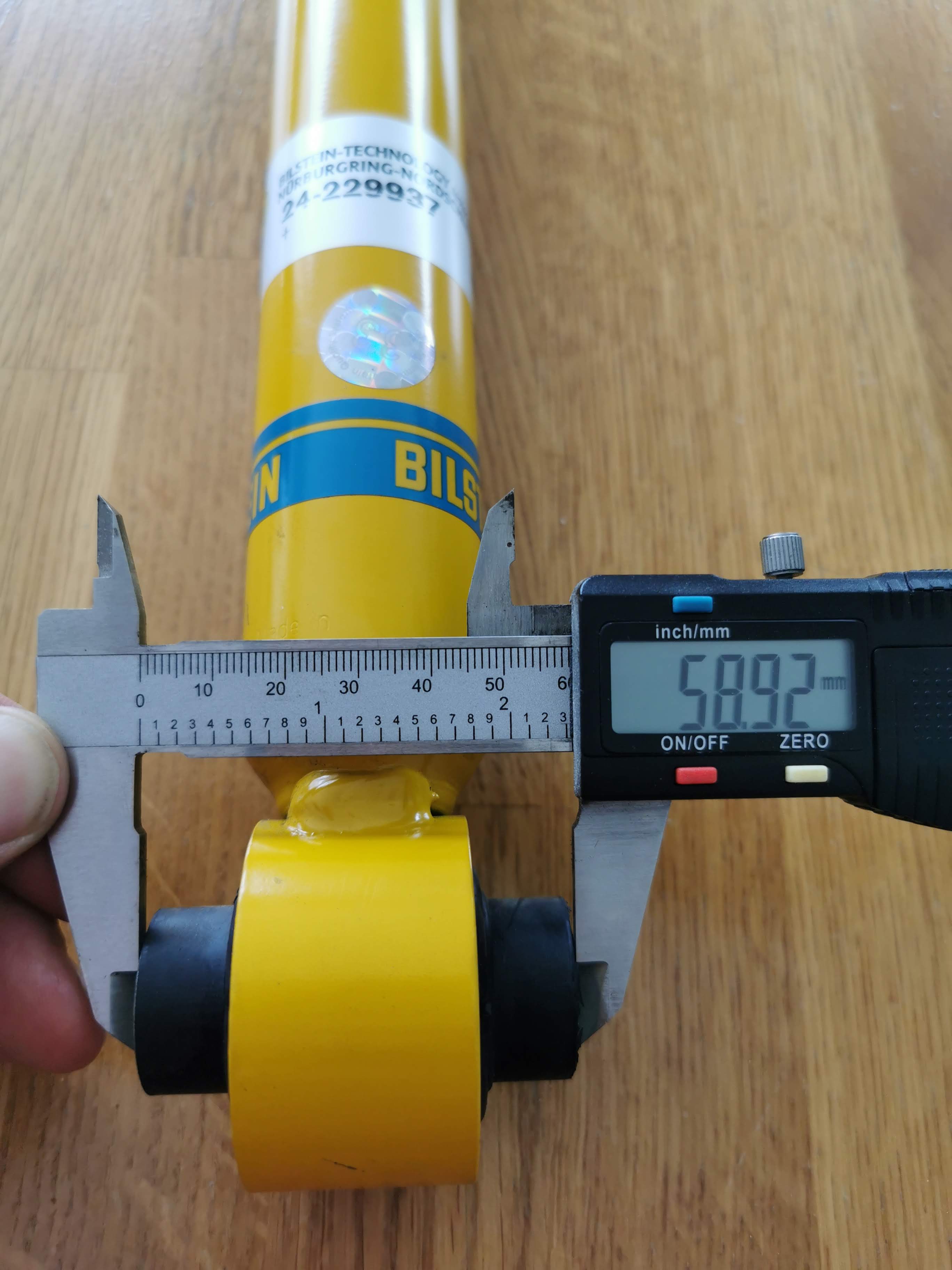

I recently purchased a pair of rear Bilstein B8 shocks for my 2015 Octavia Combi 150TDI:
https://www.winparts.ie/drivetrain-suspension/shock-absorbers-coil-springs/shock-absorbers/c10/shock-absorber-bilstein-b8-performance-plus/p790705.html
790705 Shock Absorber BILSTEIN - B8 Performance Plus
SKODA OCTAVIA III Combi (5E5, 5E6) | 2012.11-??? - 2.0 TDI - 1968ccm 150p
I ensured to enter my reg correctly in the Winparts website to ensure I was buying the correct part but they do not fit - the problem is the diameter of the bushing - attached photo for ref.
They measure approx 59mm, whereas the shock on the current car is approx 45mm - quite a big difference so it won't fit.
Bilstein part number is 24-229937
According to the Winparts and other websites - these are the correct part number for my car but in reality they don't fit.
Anybody have any similar experiences or know the correct part number I should order?
Thanks a lot
Fergal
Bilstein B8 24-229937 is for multilink rear suspension. I doubt the 150HP has multilink rear suspension.
