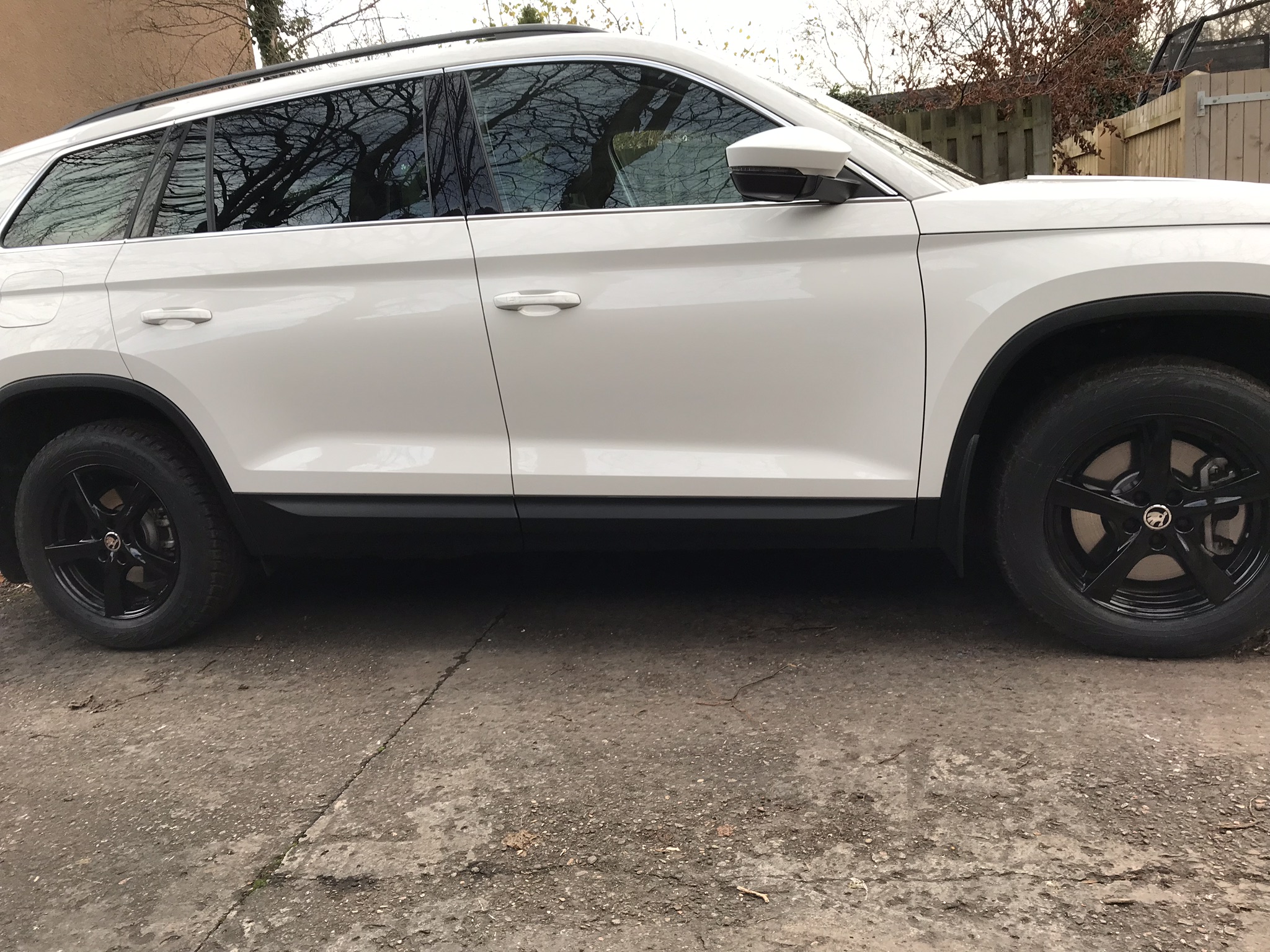

I have a 2.0 TSi Edition model and replaced the 19-inch wheels with Borbet alloy 17-inch shod with Michelin Cross Climate + tyres: my local tyre dealer is 'garaging' the original wheels/tyres and when the car gets sold, those will go back on. I obtained the wheel spec from Skoda, everything fits just as it ought to.
Round here, the roads are absolutely atrocious (and getting worse) and the higher-profile tyres give a lot more protection and cushioning. In the short time I had the original wheels/tyres, I was impressed by both the ride and low level of road noise. The switch to 17-inch wheels means the ride is noticeably improved when encountering the road imperfections (round here, that's, er, all the time) and a bonus of a small but noticeable reduction in road noise (more to do with the CC+ tyres I guess rather than the tyre profile). I run the tyres at or slightly below Skoda's recommended pressure of 2.4 bar. (As an aside, I can't quite see why Skoda recommend the same pressure for 19, 18 and 17-inch wheels/tyres, given that the larger volume of tyre as wheel size decreases would normally suggest a lower pressure. Hmmm)
Given my style of driving, I detect absolutely no downside to fitting the smaller wheels and as mentioned above, this wheel/tyre combo is available in the EU (most EU countries do not share the UK fetish for crazy large wheels with rubber-band low-profile tyres). My local tyre dealer will happily tell many stories of how the local roads wreck these fetish wheels/tyres, which is good for his business. His brother-in-law runs an alloy wheel refurb business - surprise, he's doing a roaring trade.....
And one final bonus: my Borbet alloys are 5-spoke and thus much easier to clean than the factory-fitted wheels.

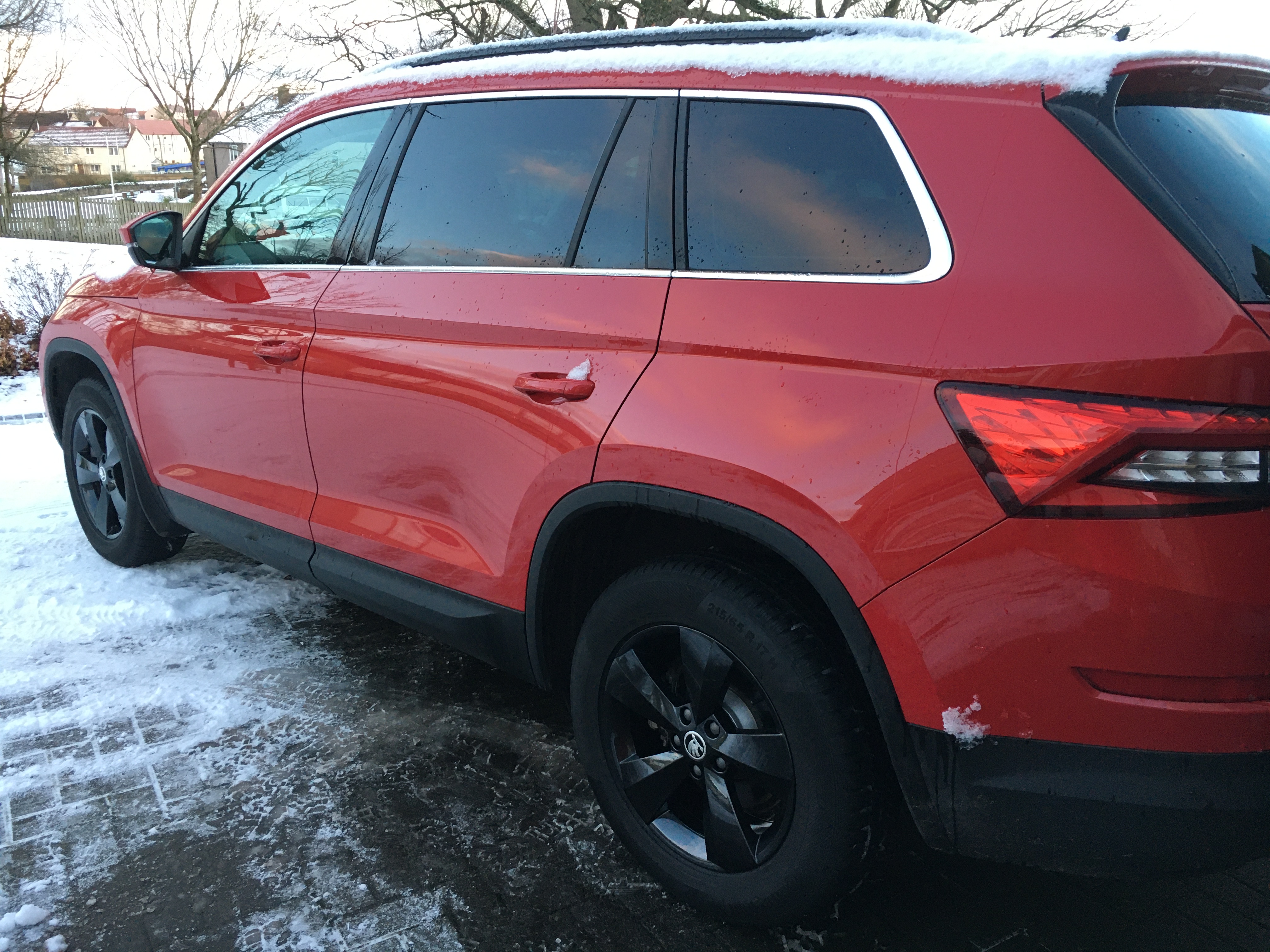

I’m another running OEM 19” Triglav Summer tyres plus 17” winter tyres.
Skoda Nanuq btw.
I can definitely feel a more “bouncy” ride on the high profile 17” tyres compared with the 19” tyres.
Not a problem, but noticeable.
I do have DCC to play with so often use it to offset the squidginess on 17s.
