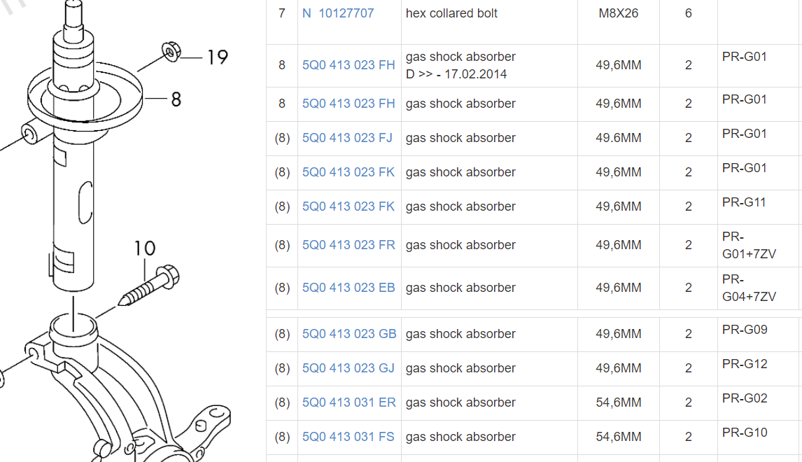

Yep, or you might be able to figure it out from the PR codes on the build sticker in the boot.
Various 3-character PR numbers starting with G correlate with different part numbers and diameters of front strut.
This is a screenshot from 7zap, but there are two other pages here and here if info on your particular "G" number and part number combination isn't on this one:
2070230336_Screenshot2021-06-1413_27_45.thumb.png.39dcd08c17c17c3278c717188a806647.png
G02, G03 and G10 seem to be the 55mm ones from quick scans of the three pages.
Measuring as a double check isn't a bad idea though.

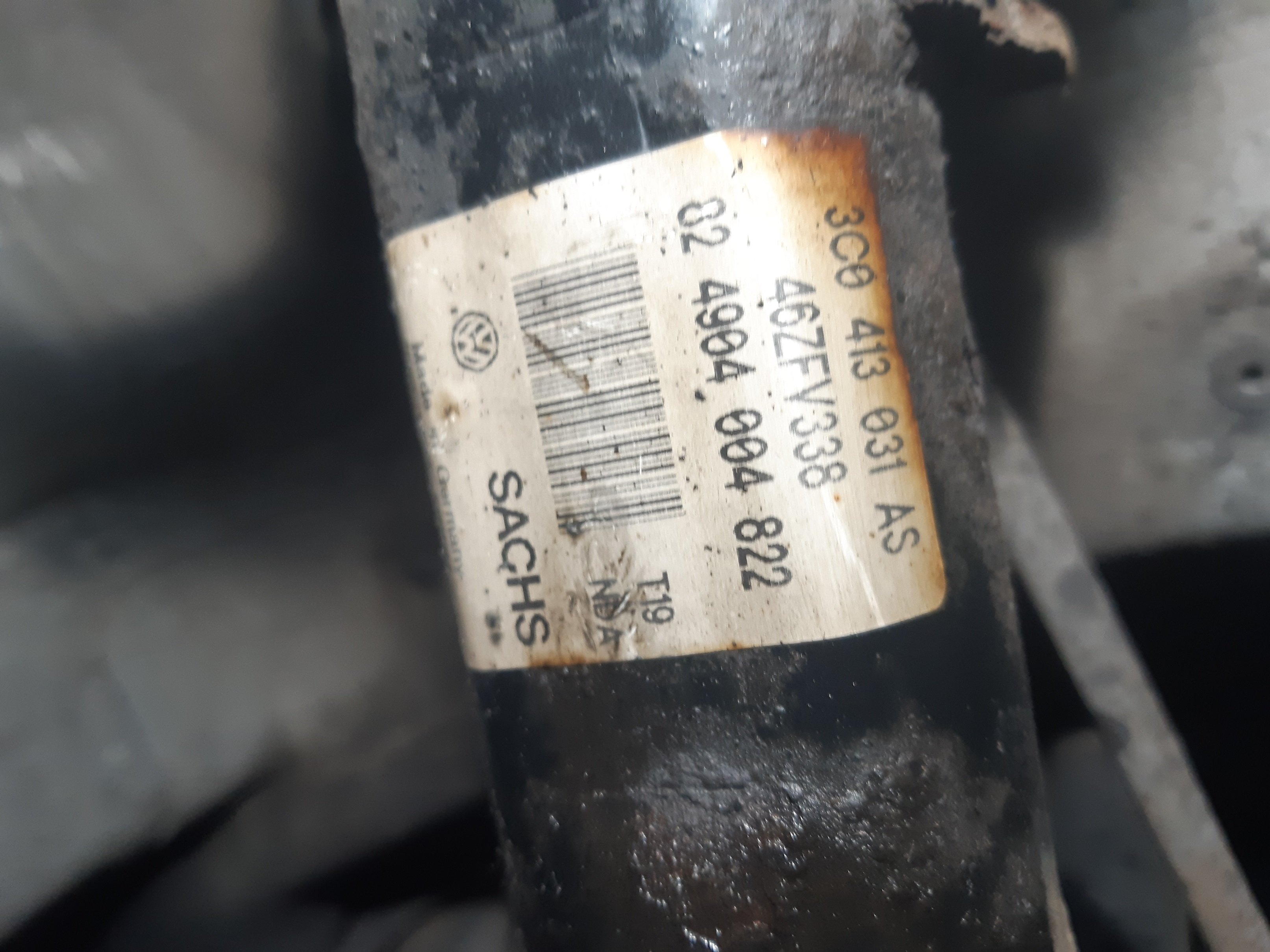

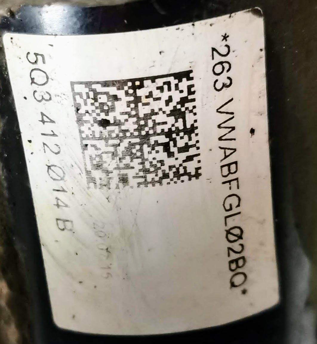

This is the label from the current shock.

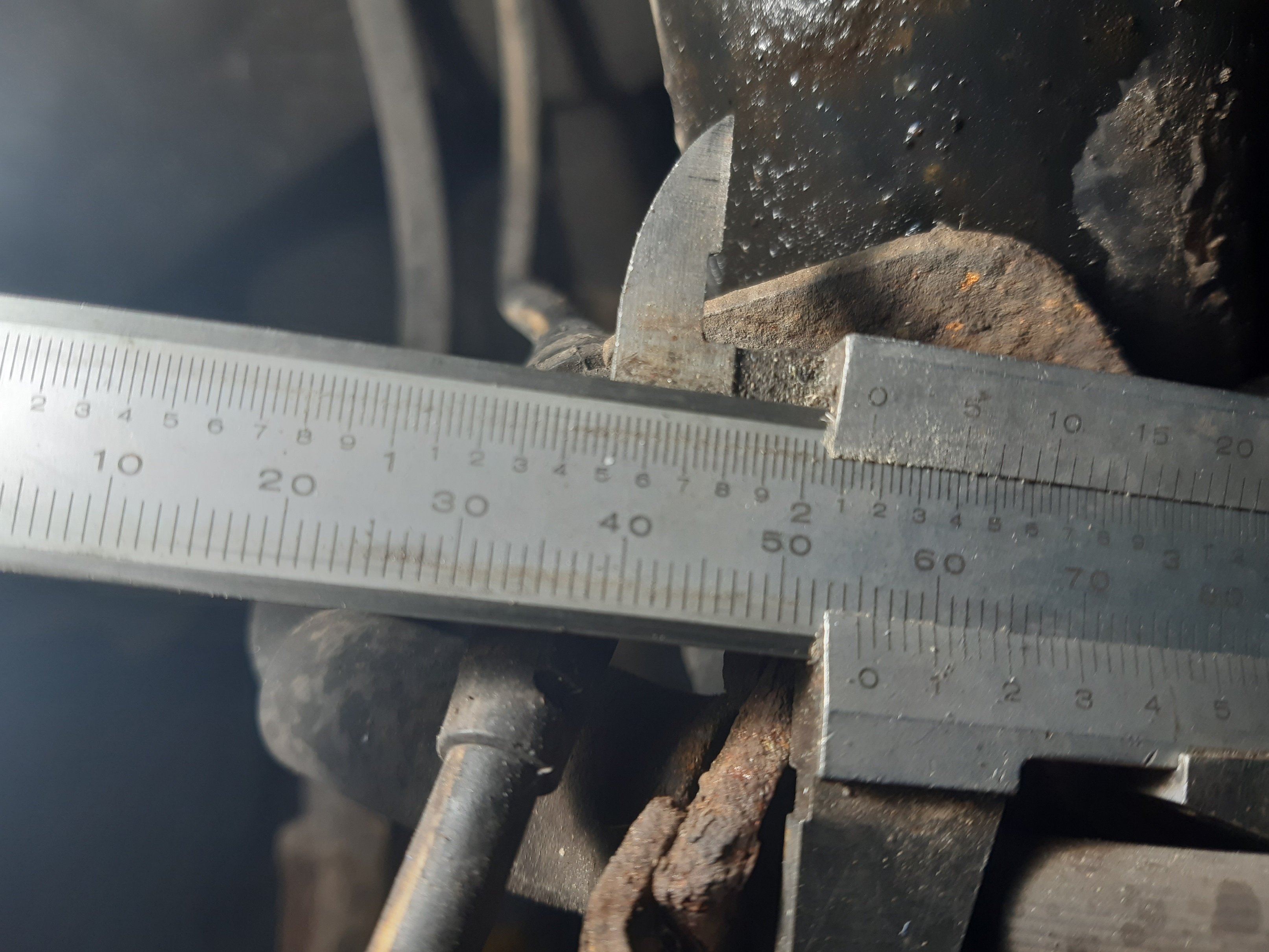

It was a bit awkward to measure the strut diameter but it looks a lot closer to 50mm than 55mm
  • Sponsor

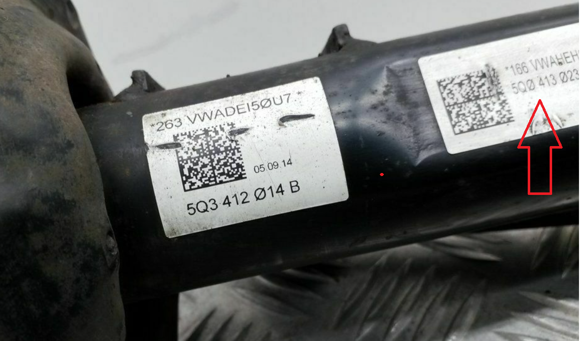

That's not the right part number , I'm pretty sure. There's often more than one label on there.
Edited by Wino
  • Sponsor
This shot from an ebay ad tantalisingly doesn't quite catch the suffix on the end of the true number, arrowed:
You were right @Wino there was another label below that which was not visible due to dirt covering the label
Just climb under the car with a caliper and measure it.
There is a rule of thumb that bigger engined cars get the 55mm but I had 50mm on my 2.0tdi so not always true.
Was it readable once cleaned off?
afraid not @Wino, regardless they fit just fine.
