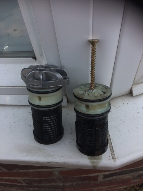

No real need for a screw in the filter, slacken off the the 2 screws on the cap. Remove one, take a judgement of the amount of engagement needed to avoid pulling out with both screws slackened, and just start the engine - shutting down after a few seconds.
The pump is activated just below normal idle revs, pressure builds up and displaces the cap and filter to the extent you allowed in the exposed thread length.
As soon as the filter "O" ring clears the casing, oil floods out and so there is no fear it will eject through the floor panel :o
Usual stuff, clean around the filter cap, the floor above etc to ensure no particle of anything gets into the unit body.
Has worked for me for years now.

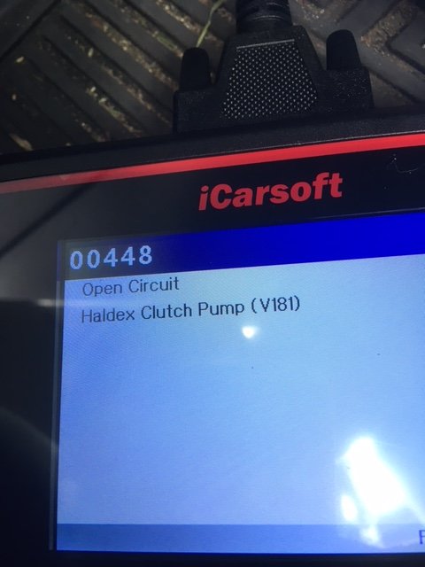

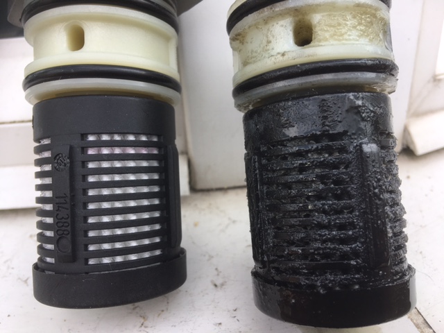

Hi, Indeed that would have been my preferred method if the pump worked! Got there in the end with the screw levered off one of the filter cap bolts screwed half way back in.

Hi , I really don't know, I'm on 70k but only bought it 3 months ago. Could have failed last year or 5 years ago hence the suggestion to check your 4wd is working. Cheers.

It can fail anytime after about 30k from the previous service depending on the filter.
Had my pump changed at 90k as it had failed, serviced at 115k and it had failed again by 135k as despite asking for it to be done the filter wasn't changed at 90 or 115, I believe it was only cleaned at 90k and untouched at 115k. 😠
I now insist on seeing the old filter after a service to make sure it's been changed.
