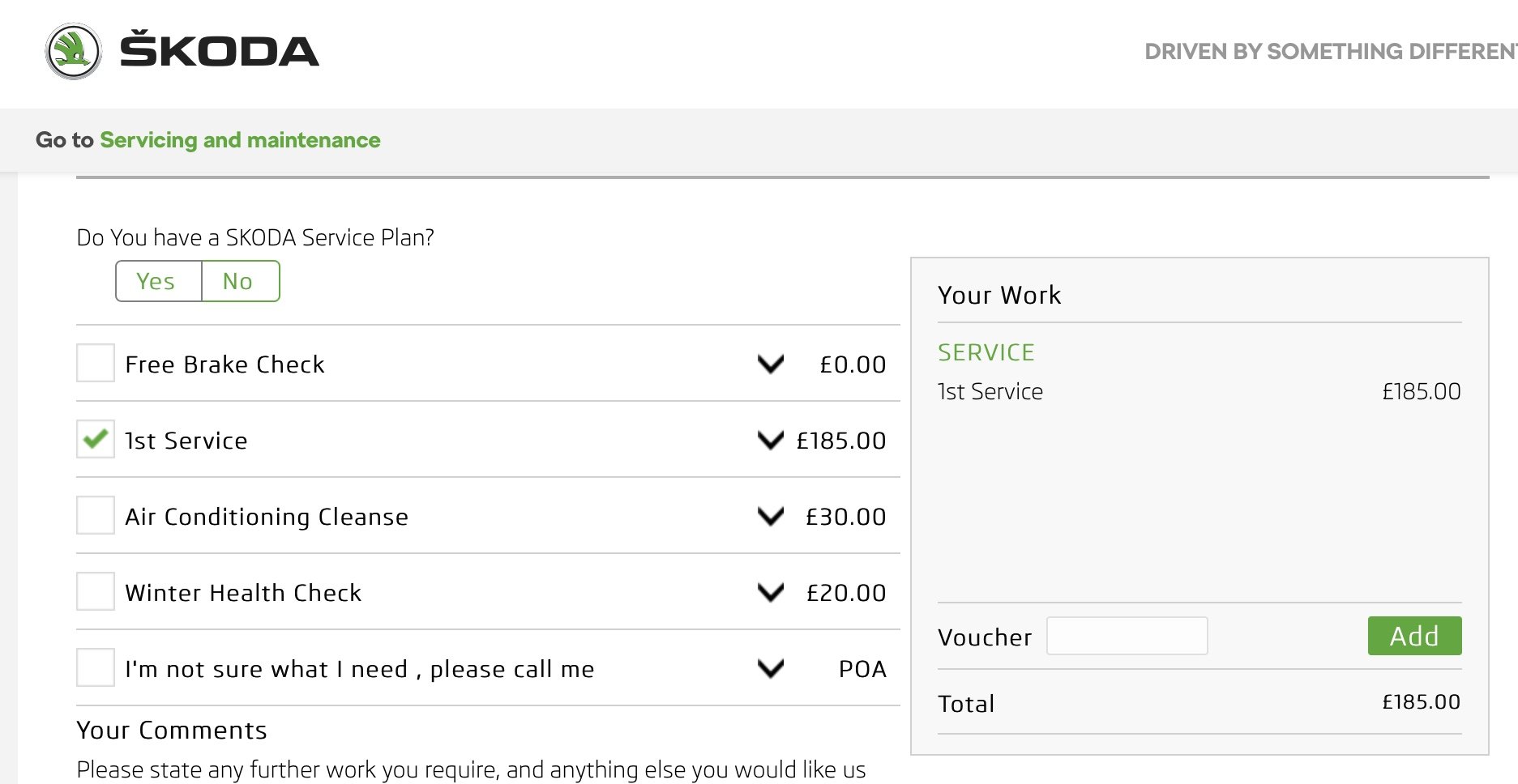

I recently got a dash message on my Bear telling me I need a service in the next few weeks. Variable type.
A quick look online suggests I must pay my friendly dealer a mere £185.
As I’m past the half way mark on a 3 year deal that should see me out.
Same as Bear No.1.

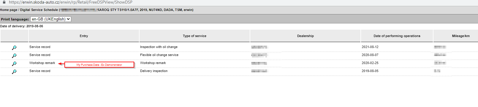

There is no need to book your car in just to check if it needs updates. Skoda ERWIN already knows from your VIN exactly what software is fitted to your car, and that is why updates are flagged. Similarly ERWIN will tell you if a TPI applies to your car, all it takes is 30 seconds to read it and decide if action is needed. TPIs used to be called RECALLS. Changed now because of lobbying, only certain safety issues are flagged as RECALLS and only after the incompetent VOSA has decided its serious enough.(How many Zafira fires does it take to instigate a recall?)
For the incredibly thick (me) can you remind me how you do this in ERWIN.  I have a free account and can login and look at my digital service record but I can't see all the TPI's and updates that were performed already and what one's might need doing (like I suspect the steering Firmware):
Every other part of ERWIN I try to access I need to pay (that I can see).   For example, I had the the update to the DSG DQ200 done when I purchased the car (refused to buy it at the supplying dealer until it was done) but I can see no mention of it in ERWIN. under the magnifying glass for the workshop remark when I purchased the car as an ex-demonstrator/Skoda owned "pool car" all I saw was:
Good luck to the average driver being able to do even that TBH - Not exactly straighforward for the mass public 🙂
