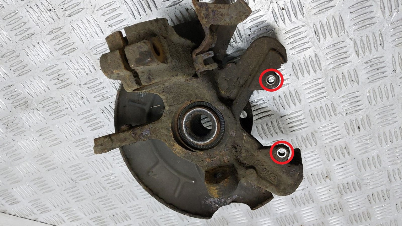

Just one last quick question as always lol does anyone know the torque setting for the main brake caliper bolts as im going to take this opportunity to change my pads and discs while i,m re stripping the rest ???
Slider pins are 28Nm for FSII & FSIII calipers. Pins are 7mm Allen for FSIII which are on the 1.4 MPI. Disc size is 256mm.
There are no other caliper mounting bolts as the pins go straight into the hub casting....
