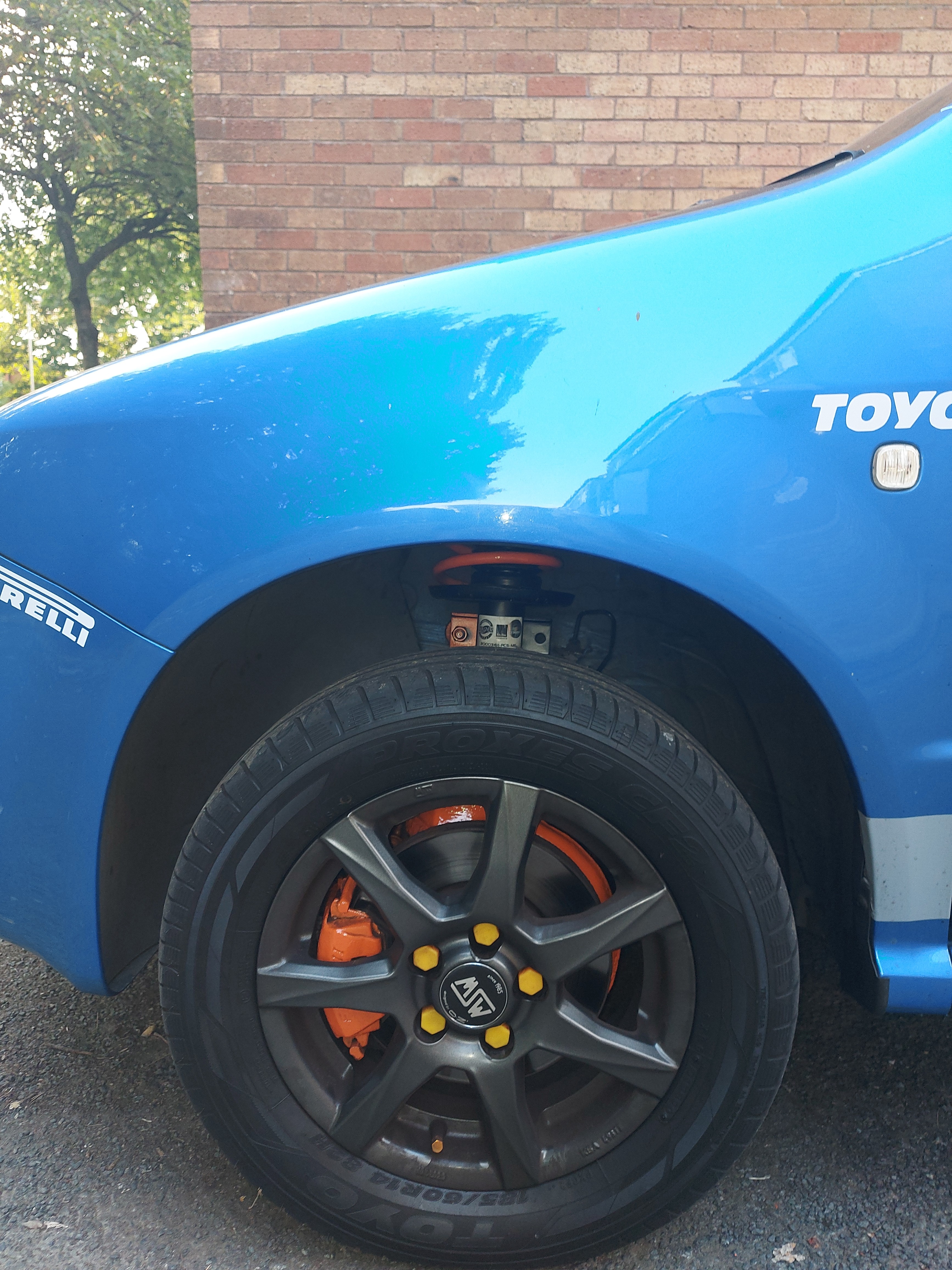

I dont know what the gap is meant to be at as when I got the car they were worn anyway but no way this high.
That's ridiculously high.

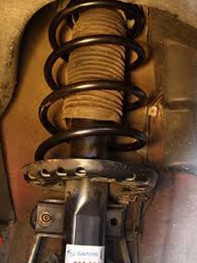

7 hours ago, Stewartasb said:
Hi all just an update, So did all the suspension work all went back together well bit of a pia holding the shocks up by yourself while you maneuver the hub back into place lol but all done now only issue I seem to have is the front end seems to sit much higher than it used to by like maybe a good 3 inches or so.
When I took the originals off I put a new one against an old one and length was all the same so im at a loss as to why its sitting so high now any thoughts please ???

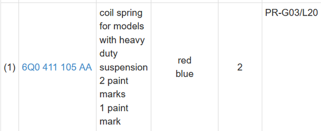

That number comes up as Skoda cross reference 6Q0411105AA
On ETKA they come up as ''models with heavy duty suspension''.
really thats interesting so basically they are the wrong springs then way to heavy duty hence the high ride height damn :(
