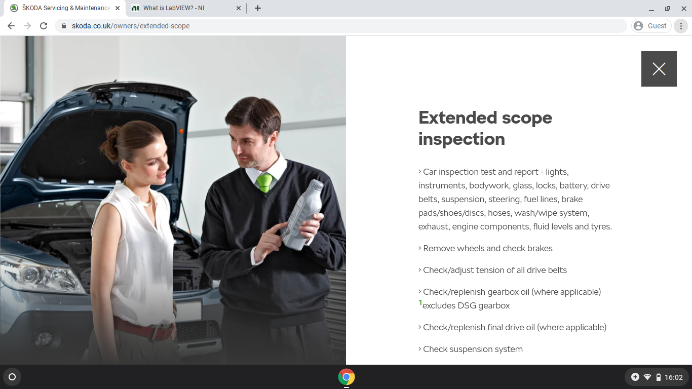

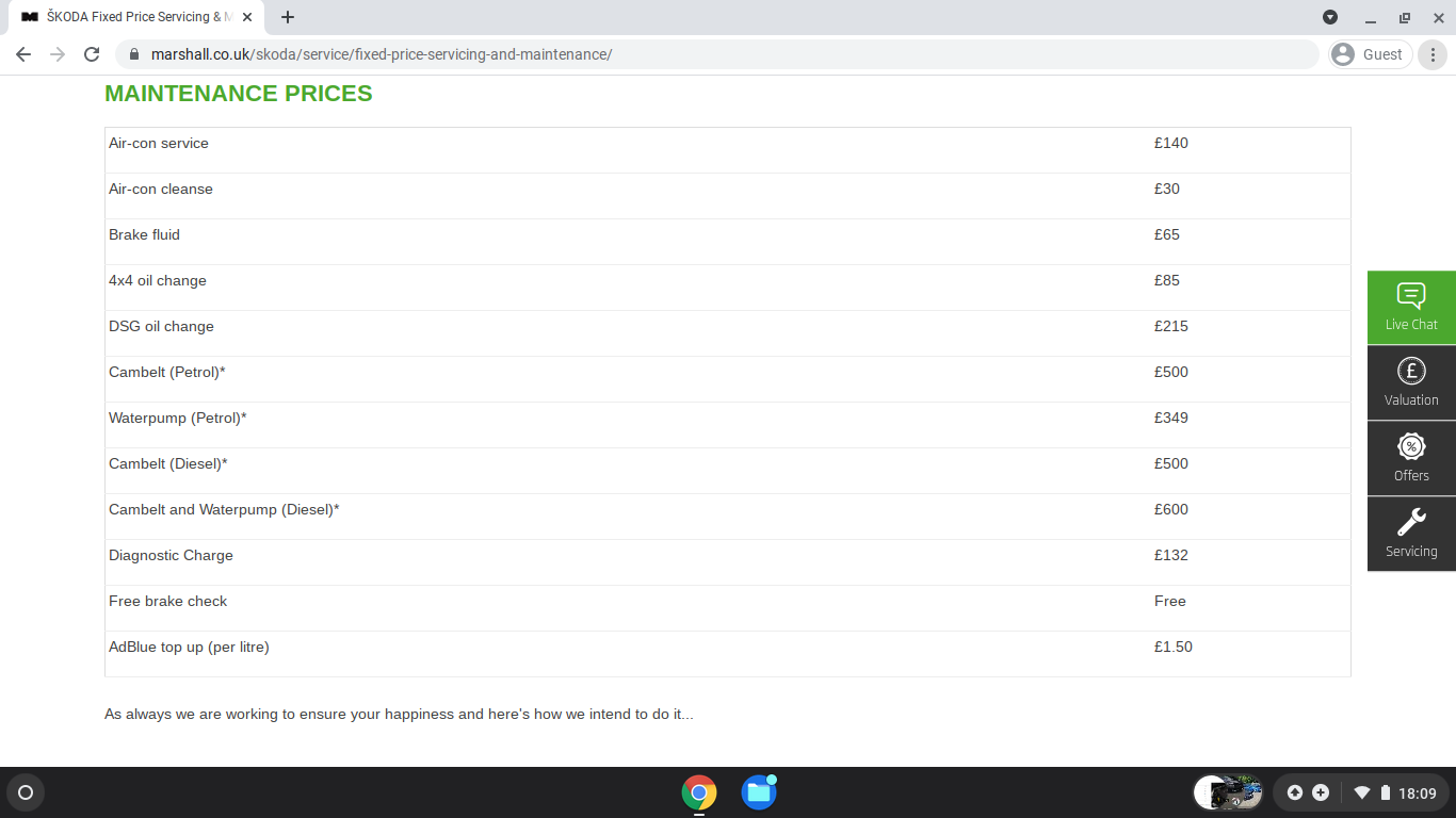

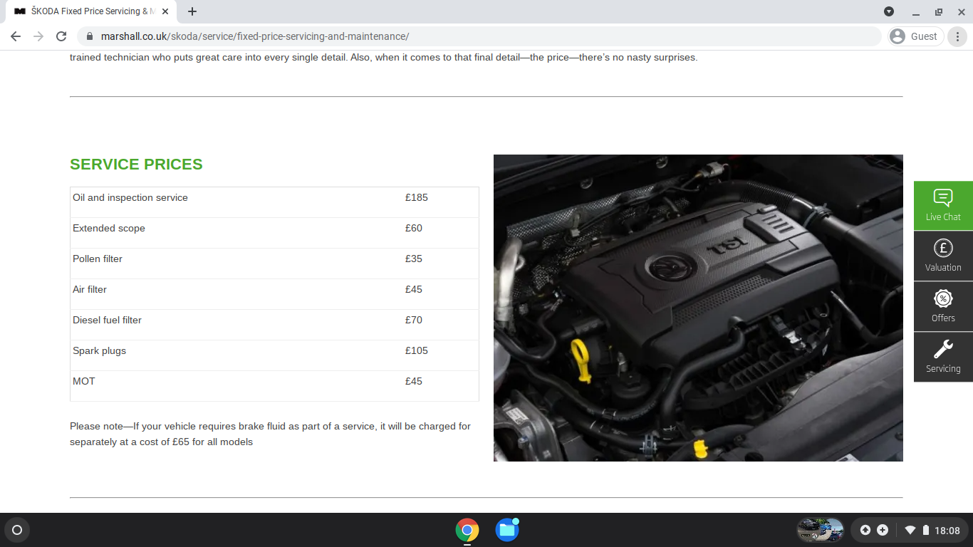

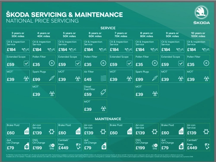

The DQ200 DSG has no service schedule/ recommended oil change interval or even a need to change either of the 2 oils.  Leave well alone if all is well.  Do not have anyone mess with it unless they have all the gear and more than ideas.     People do change their oil but then they have reason to.  Best let sleeping dogs lay.
Prices are ridiculous, best find a good Independent and get work done not just ticked off and lots of up-selling attempts.
1135553596_ServiceSchedule.jpg.010f7f298e30d227a90f596bebce01ae.jpg.eed1339005a1b645c62713aa330a487a.jpg

The chart clearly shows DSG oil change at years 4 and 8.
It does.
  Clearly but not clear enough that is 6 or 7 Speed Wet Clutch DSG's like DQ250 or DQ380's with 40,000 mile oil change intervals or DQ381's and 80,000 mile.
But here we are looking at a DQ200.

I was going to delete this after TerFar's post but seeing e-Roottoot's latest post I've revived it.
If there are 40,000 and 80,000 miles oil change intervals are there also time interval alternatives too?
ETA: From the chart above it will be very interesting to see if that "No service interval" changes in the future.  As I put changing the oil gives the chance to check the oil that comes out, if only visually and rubbing it between (gloved) fingers to to tell you what condition its in and possibly tell you how things might be going with the box especially if you analyse the oil for what's in it (not expensive nowadays and can be done from home).
I've no idea how easy or difficult it is to change the oil(s) on these DSG but if it could be done I'd do it.  ETA: But others may think I'm wasting my time and that's fine as they may be correct and different people have different views.
Seen this 'sealed for life', doesn't need changing gearbox oil stuff before, in fact the Ford (type 9) gearbox in my car was without drain plug but it's gear changing can be improved (but not speeded up) by changing the oil and to better oil.  That gearbox could be 37 years old for all I know and I've no evidence it's ever been reconditioned in that time.
The gearbox and rear axle on Midget never had recommended oil changes but both benefit from occasional oil changes, yet the similar gearbox on the MGB had 24-months or 24,000 miles whichever was sooner (soonest?).  Gearboxes, same as engines, have lots  more bits added to them now but they still basically bits of metal tuning in a bit of oil, cars are very ancient technologies with lots of electric, electronic, computers and programs on them to squeeze out the last drop of possible efficiency from their ancientness.
In ancient times if you had something like an old Ford you could just run it and never do more than add petrol and oil as required and just see how long it'd last with that neglect and it'd often be a very long time but the computers on modern cars wouldn't be happy with their readings doing that now, plus you'd probably never pass the MoT now, unless it's  done over the phone.  :biggrin:

The thread is here on the Famous DQ200 DSG Clutch Slip & i think page 11 shows the Oil Change.
The DQ200 DSG World Wide Recall on 2012 had 2009-2012 DQ200s get the Synthetic Oil changed from Synthetic to Mineral and a Software Update.
Thousands still run the Synthetic or the Mineral.  2014 Europe got this as a Service Campaign.
Then there was the Software Update on ones from 2013-2015,  then the TPI's that the aforementioned thread covers.
Millions of DQ200's from 2012 are running the Factory Filled Oil, because that is perfectly fine.
If you want you can change the Oil, both oils.   VW Group do not make a recommendation to.
If giving advice on certain service items best get familiar with them. Too many in VW Group Branches are not.
Millions of DQ200 built on since 2009 for application in over 50 vehicles and millions of DQ200 recalled and tens of thousands of failures and VW Group have never changed the 'No Service Interval'.
In 2012 they did increase the Warranty in Countries the courts / Government Agency would tear them a new hole to 100,000 miles / ten years.
