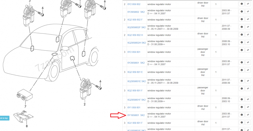

I expect yours to have part number 6Y1959801. There's a suffix 'SK2' in the parts catalogue, but its not clear what this means, and they don't print it on the part number label on the product, only on the box it comes out of; so secondhand purchases can be a bit 'hope for the best' unless the seller is crystal clear about which vehicle the part was removed from.

I wouldn't be confident of anything that wasn't from a Roomster.  That SK2 suffix I mentioned earlier would be a different suffix in any other model.  You might be OK, but there must be a reason for the different suffixes or they wouldn't exist.
No, it has a different part number for a start, but if you look at the photos you'll see it's also got the wrong 'handedness' compared to a 6y1959801.  The installation orientation is different on mk1 Fabia compared to all other applications of these parts.
You need exactly the same part number as your existing one. The part numbering is very confusing, and ebay sellers often over-generalise about which part numbers fit which models.

6Y2959802
Don't be tempted by units where the part number starts 6Q... or ones with a suffix F on the end of the base 9-digits, they have different connectors, and wiring. Can't seem to font size match this back to normal, sorry.
