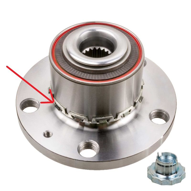

11 hours ago, paulkennedy said:
I am assuming the circlip has been removed?
There isn't one. The bearing has a locking springy thing attached to it....
wheel-hub-wheel-bearing-front-skoda-fabi
It finally came off with the heat gun me pulling on a scaffold bar over the breaker bar my mate on a pipe wrench on the back nut and his sister tapping eith a hammer not exactly the easiest one I've helped with.
