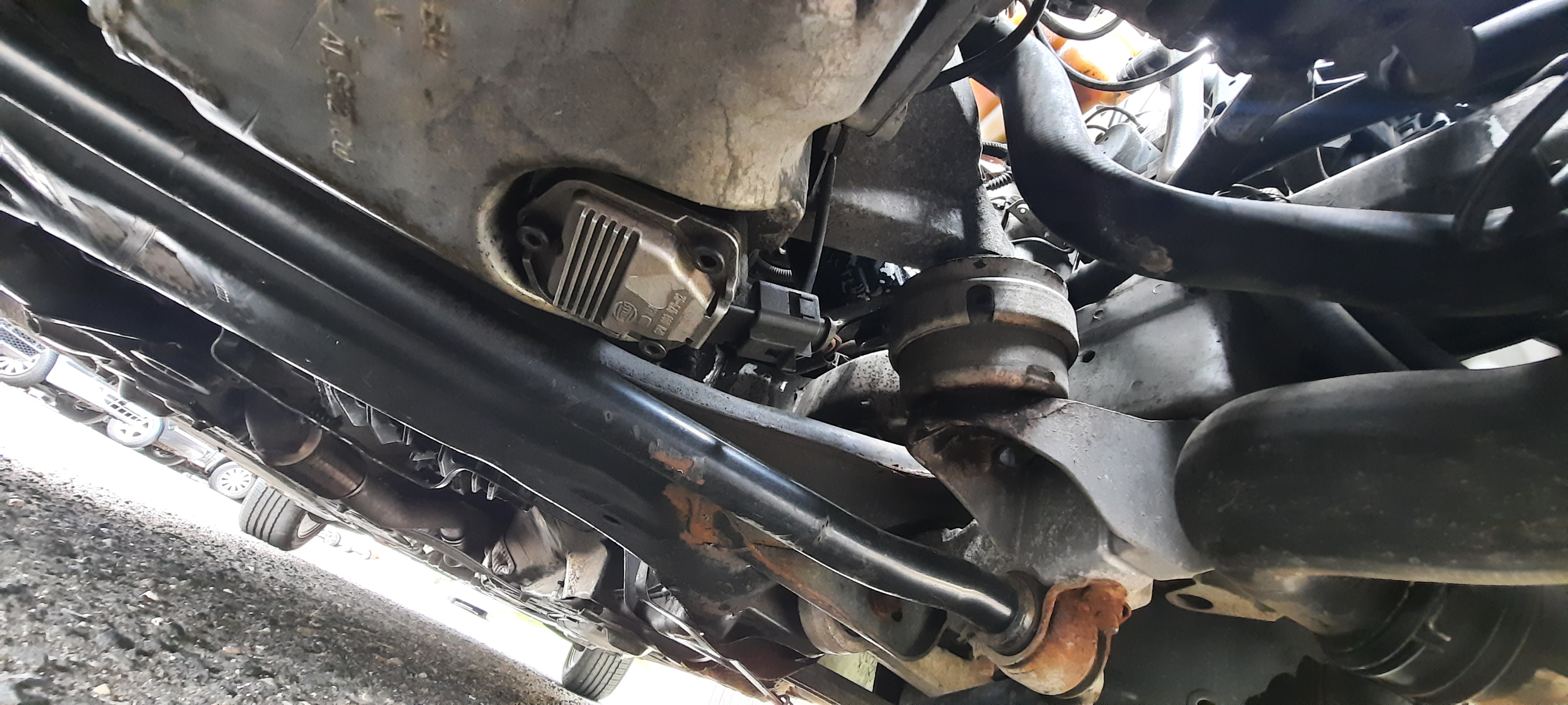

Which engine does your car have?
You will need to look from under the car to see the sensor in the oil sump, if there is one.
It Škoda Superb Year One. 1.8T. I don't exactly know how does it looks like, but I'm about going to check it out
Is that one?
  • Sponsor
That is  the one. :)
First thing is to check that the connector is pushed on fully; it looks like it may not be?
The connector latch may be broken if it pushes further on but does not 'click' into position.
4 minutes ago, Wino said:
That is  the one. :)
Yeah, i don't feels the click when i connect it. Then what should i do?
  • Sponsor
If the broken part is in the wiring connector (probable) rather than the sensor, you could replace that connector.  There will be a part number written on it somewhere in tiny characters.
Or you could maybe find a way to fix it in the fully-engaged position. Not much to attach it to though unless you use superglue or something.
