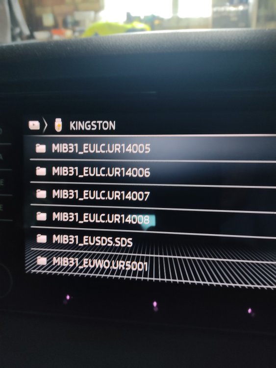

I know this thread is over 5 months old but I just wondered if you had eventually managed to get map updates on the Kamiq using the USB C method.
I have just acquired a used Kamiq 1.0 TSI SE L  first registered Jan 2020 with the Amundsen MIB3 Infotainment System and am having the same problem. I have received conflicting advice as to whether it is possible in the UK to update the map using the unzipped file from Skoda Portal or if the only way is to use OTA updates. The free Connect subscripton period from the previous owner ended in Jan 2021. I am only interested in up to date maps, not the other facilities, so I was hoping to try to  get the 2022 map update manually before having to buy a new Connect subscription.
I have plugged in a memory stick with the unzipped files on and driven for 2 periods of 45 minutes but I'm still on version 19.1 for the maps. (Hardware H12, Software 0278).
Has anyone in the UK got thi update method to work yet?
18 minutes ago, Omniking said:
Map-updates-mib3.pdf Here is the manual for mib3
Thanks for the link.
I have followed this manual and loaded the zipped files on to an 32Gb memory stick, plugged it into the USB C socket on the Kamiq. After driving for two periods of 45 mins nothing seems to have happened.
I will try downloading it again. I formatted the pen drive to exFAT as per the instructions. I might try formatting to FAT32 and see if that makes any difference.
You need to use exfat and do navigation route trajectories, then i think it will pull the new maps. Leave the stick in and every time you drive do a route and  after a week drives check the system navi if it changed.
No you cannot update with mc in usb-c maps updates automatically you need Skoda connect to get updates
Hmm..I have just driven for an hour with the unzipped map files on a memory stick plugged into the car's USB C socket. On checking the System Information screen the Navigation Database has changed from 19.1 to 21.7. I scrolled through the map and noticed there is a new roundabout showing where a new road is nearing completion. This was not shown in the 19.1 version. So looks like the update has worked OK.
Ah nice it is working :)
