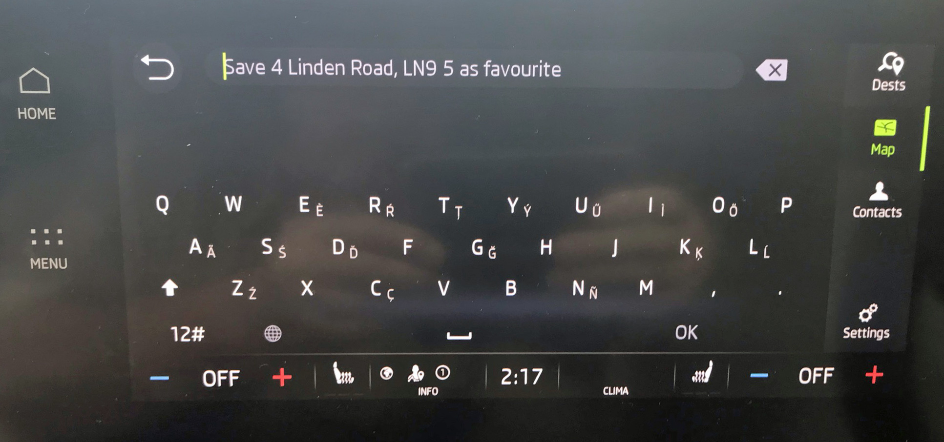

Foureyze - OK, tried that, but with only partial success. Think we have different systems (mine is Columbus). Google Maps gave me the destination coordinates which I then input into the SEARCH screen and, indeed, the address popped up. But then as you see from the attached pic, it appears to be asking me to SAVE. But how? There is an OK button, but it is not active. True, at the point of departure I can enter the coordinates and press START - but the problem persists that I can't save the address in advance as a Favourite.

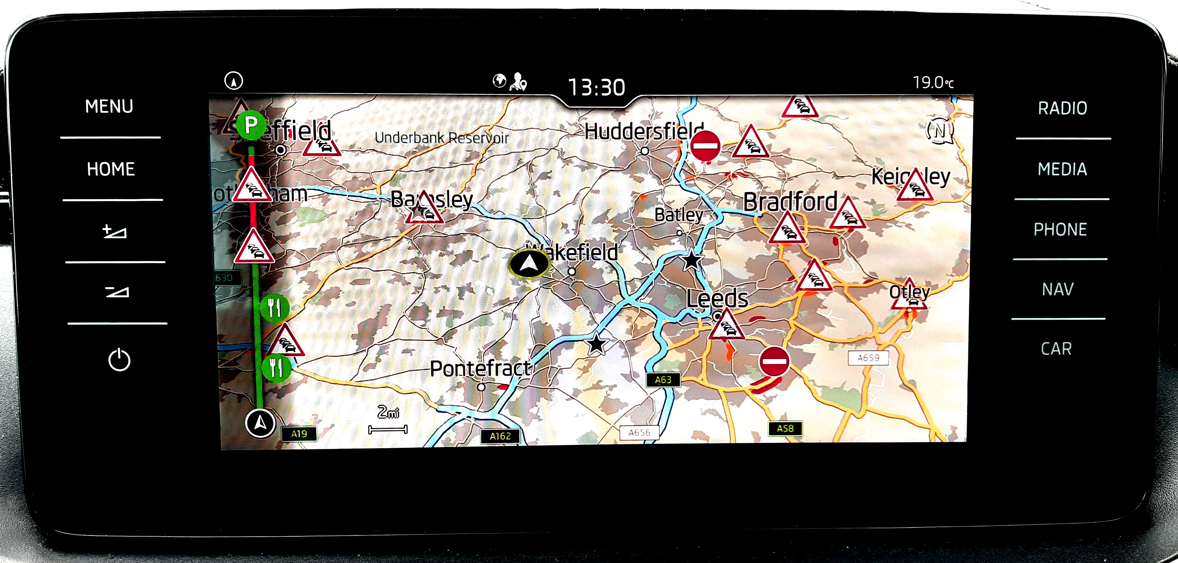

Finally a photo attached of the MIB3 navigation screen for reference.
When it asks to SAVE you have to write a name in the text bar e.g. "Bar" and then OK and it will save the destination as "Bar". At least this is how it is done in my Octavia...
