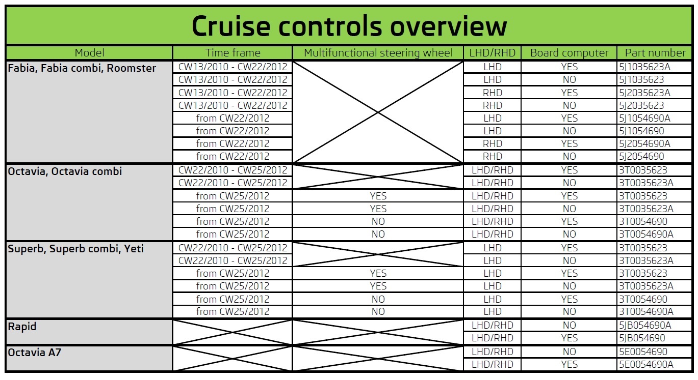

I found this old post where it says 5J2054690A is suitable for models >22/2012.
Why isn't the dealer not able to say that this part is suitable from their system?

see attached diagram for part number to order........and I will confirm it fits and works because I ordered and fitted one to my 2013 vRS
Edited by UrbanPanzer
Thanks for the clarifying the part numbers.
I will give them a call and hopefully telling the part number rather than searching via registration number will allow them to order the part I need.
Managed to order it from the dealer.
The reason why it isn't being returned on the parts system was due to it only linked to fitting a Roomster and none of the other Fabia models.
