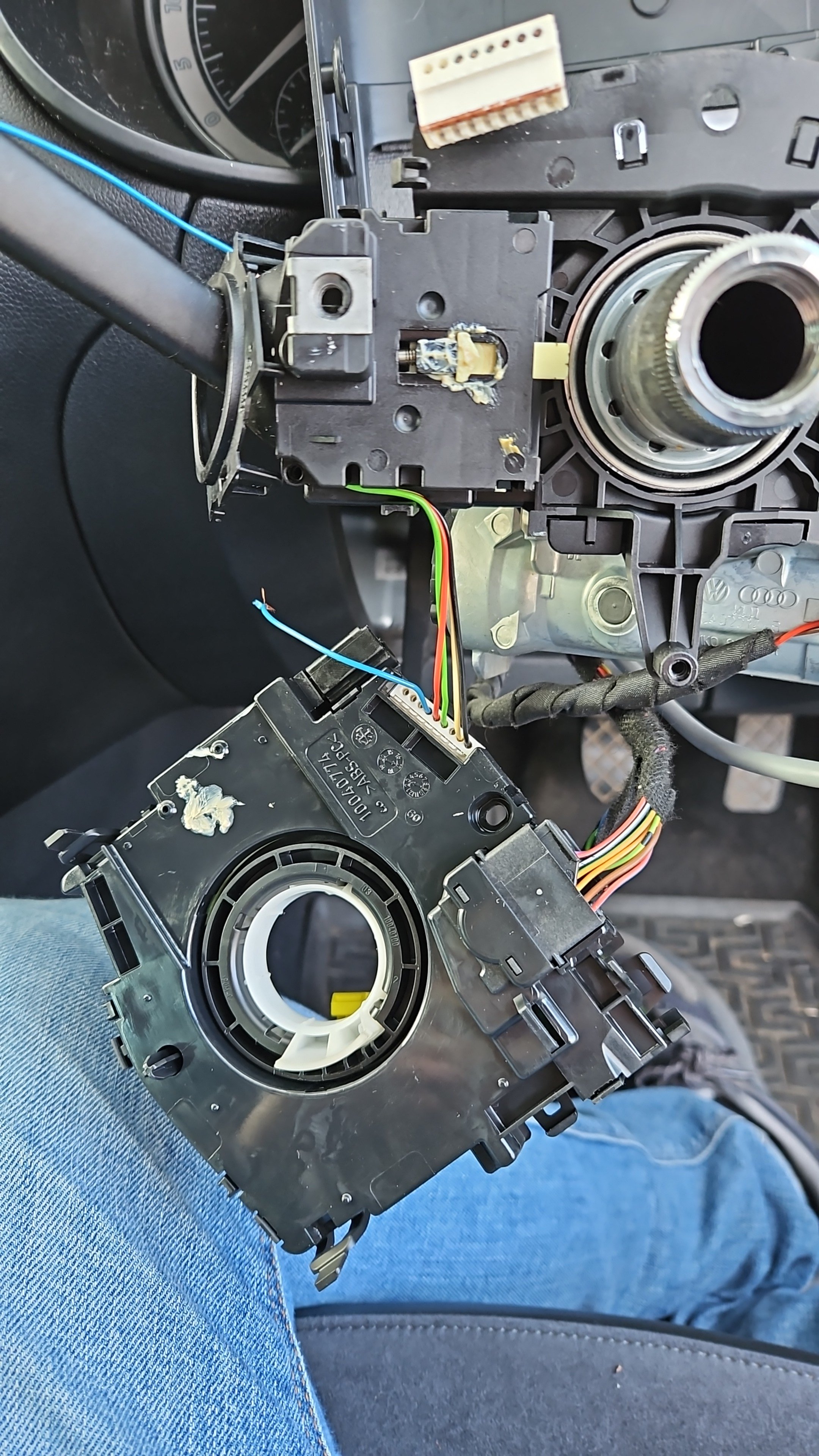

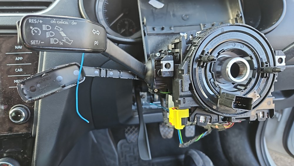

Thanks to all who replied. By way if an update, I have fixed the fault!
I decided the pop the steering wheel off and take a look, which revealed a broken wire! I soldered it back together and voilà, I now have cruise control!
