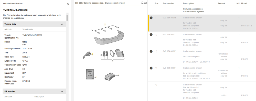

Thank you pab567, the VIN is: TMBFA6NJ9JZ160550
I am afraid they are right - such accessory is available only for cars manufactured after 30.07.2018 and yours was made on 21.03.2018. Sorry 😞
Damn, I got unlucky there. Really appreciate you checking for me though!

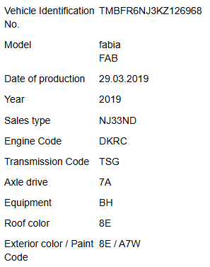

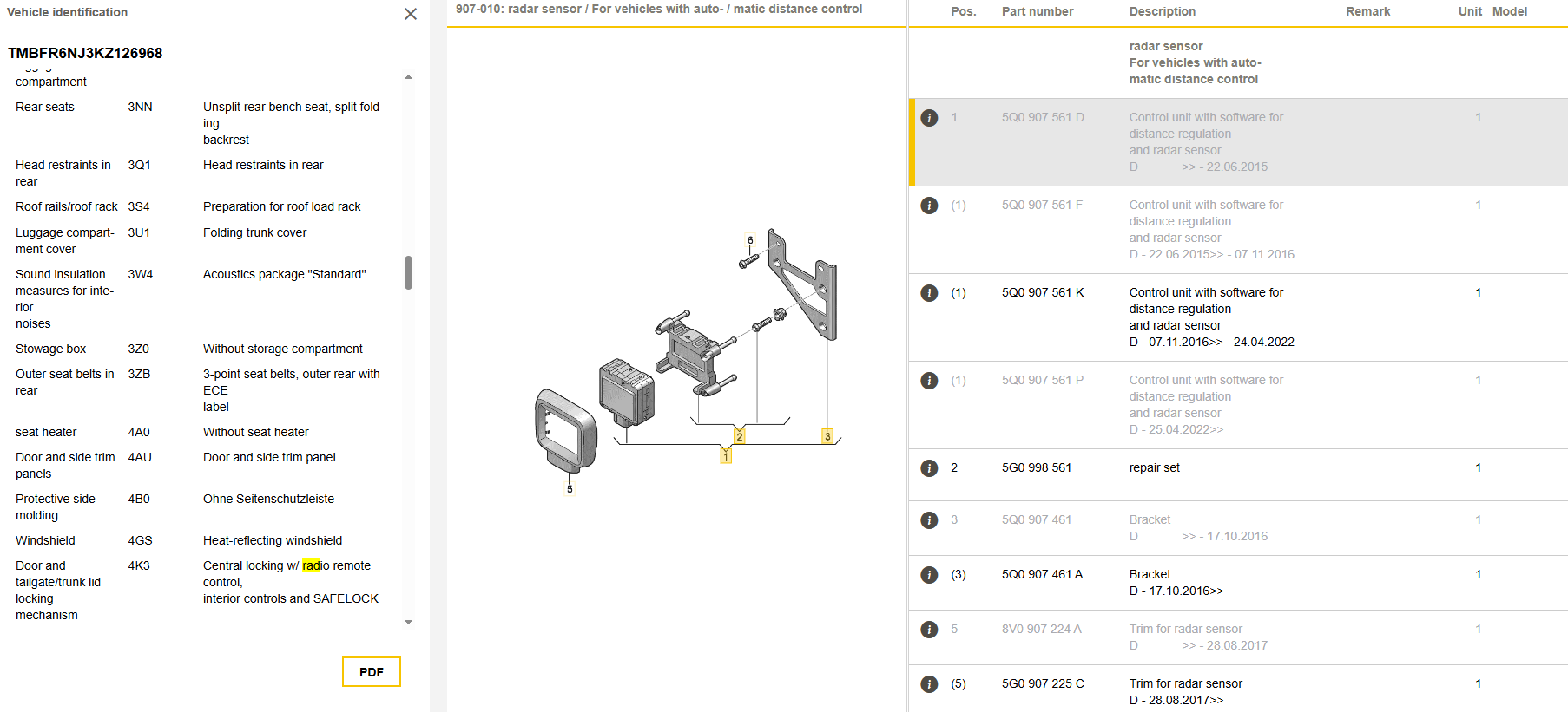

@pab567 , can you check mine? first registration was 31st May 2019. VIN is TMBFR6NJ3KZ126968.
The reason I ask is that Skoda is at the cheaper end of VAG and, apart from the adaptive cruise ECU and the column switch, has the hardware to run adaptive cruise. I'd not be surprised if the wiring looms are carry-over from the higher spec. cars.
Your Fabia was manufactured on March 29th, 2019:
It's equipped with speed limiter only but it has radar installed as it is equipped with forward collision warning - it has options:
6K2 - Forward collision warning incl. autonomous emergency braking, without adaptive cruise control
8T9 - Speed limiter without cruise control system and without adaptive cruise control
You car has the same radar as used in cars with adaptive cruise control - part number 5Q0907561K.
IMHO Skoda dealer should be able to add cruise control to your car
Thank you pab: it's somewhat my expectation. There are so many options on modern cars that there are really never the two the same made. The cost of custom looms is large (surprisingly, still hand-made) and the shelf space on the production line drives the factory into complaint mode. It wasn't registered in the UK till 2019 so a march build was also expected. As much as I like adaptive cruise control, and it is a nice feature, along with lane departure warning, which my Wife hates, the powertrain ECU isn't going to recognise same without a dealer reflash. But the knowledge that it can be done is appreciated. I'm sure the upgrade is a £4-figure number, but I will enquire and report.
