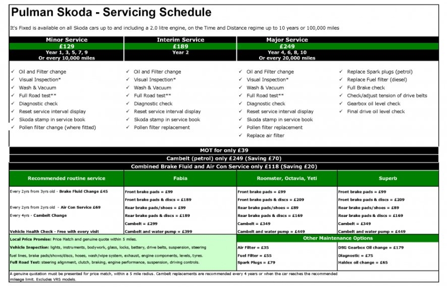

 How it was just a few years back, up to 2019/20.
Pulman Skoda were taking the pith with a Interim for just a Pollen Filter as an extra. They all get Long Life Oil.
All took the pith that called the first Variable Service a Major and many got away wit charging and nor changing stuff.
Cheated HMRC as well as Customers.

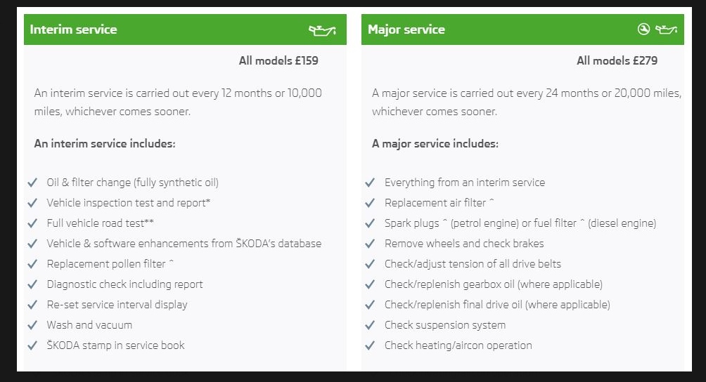

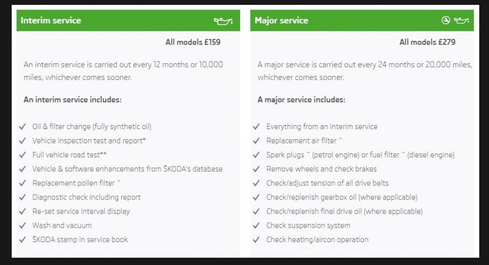

Edited by e-Roottoot

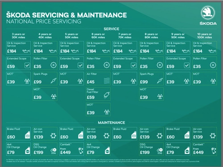

Prices have risen yet again. Plugs are £105 and filters risen too. I wonder how will they keep profit margins with electric vehicles?
Pollen Filters,  Visual Inspections, brakes which they will say are 80% worn and rear drums they will say they have removed and cleaned while not even having removed the wheels / brake fluid, diagnostic and road test.
With the Plug in Hybrids they have the TSI engines on Fixed Service Intervals.  That should be 'Fixed Interval Oil & Filter changes'  the service can still be variable flexible.
Engines might run very very seldom if the drivers are regularly run them just short distances on electric.
Plugs could last a decade plus.
