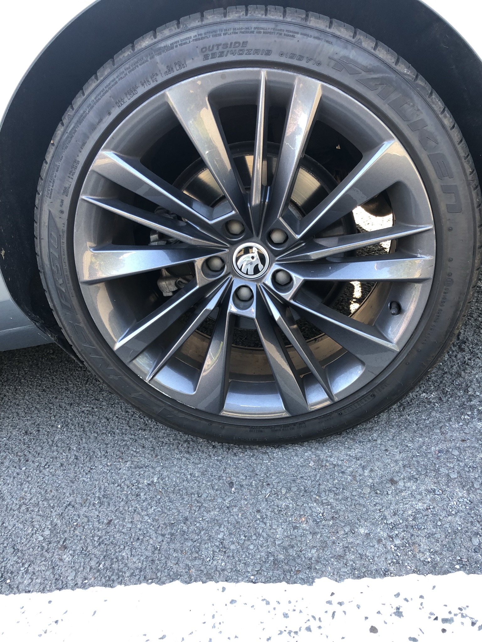

Got my very very nice 68 reg 190 tdi dsg 4x4 Superb Combi coming on for a couple of months ago from Carrs Skoda, Bridgewater, & gradually getting used to such a small motor after parting sorrowfully  with the 10 years older VW California campervan.
As a SEL-Exec it came shod with very posh metallic grey Trinity 19” wheels and brand new 235/40/Z19 Falkens.
However … 40 profile looks so fragile & apart from that I always convert to all weather tyres … 2x4 zero grip & 4x4 zero grip is what you get in poor icy or snow covered situations. The Camper was preceded by a 65 reg Octy Scout allweathers shod which proved great on snow & ice. Obviously not set up for anything adventurous off metalled roads I do venture albeit cautiously into forest tracks and the odd unmetalled track . So 40 profile tyres … rather not! And that’s apart from the relatively harsh ride over potholes, projecting drains etc.
Anyway, hopefully someone lusting after my wheels will come along in a month or so time to buy & I can then convert to a tiny upsize on 17” wheels with 225/55 tyres as suggested in an earlier thread here rather than the 215/55s. Tyre of choice is the Goodyear Vector 4Seasons Gen 3.
Any thoughts on such a proposed change?
