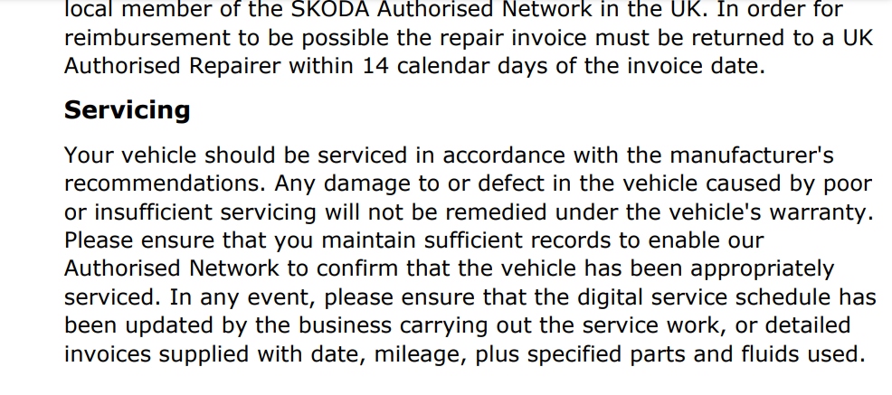

In terms of fuel, just do what you're comfortable and happy with as you are the owner/paying for it.
If you're in warranty read what is said about fuel and additives in your manual/warranty information as a new car warranty is worth a lot more than a few litres of fuel.

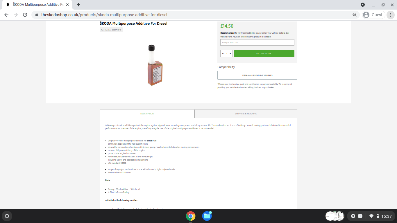

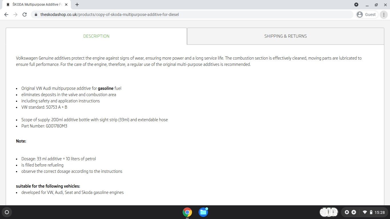

When reading the 'Owners Manual' & the Warranty concerning additives,
remember Skoda / VW Group have Additives that are sold and that at a service you will be asked if you want a Fuel Treatment done.
I had no idea that VW had got on the additive train, but then I drive a diesel.
It again makes the point of be careful what is in the additive, as they're not all the same.
I wonder what the base is for that.
They have been flogging their own additive for years and the standard is just the same as others manufacture or retail.
There were issues in the past with Warranty claims being declined because of the use of additives, but that was cleared up since VW's were the same product.
But then they do try stuff on.
