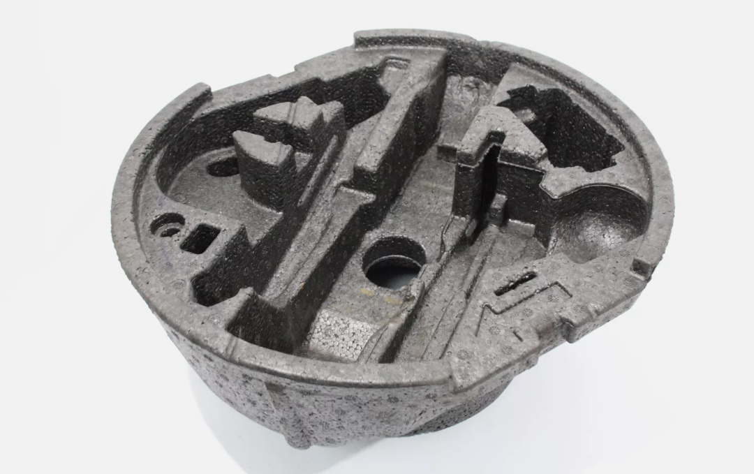

My 2017 SE has a spare wheel complete with jack and spanner. It looks like they may have been used previously, which tallies with the car having come to me with mismatched tyres at the rear.
My question is how should I store the jack and spanner within the rear wheel / well? These are currently moving around inside the spare wheel unsupported, whereas in other cars there's often a polystyrene tray of some sorts.

You can get them on eBay. This one's for an Octavia.
Use the OEM part number 6V0093860A to order from a UK Skoda dealer. The kit has everything except for the spare wheel.

Bah. The tray that arrived wouldn’t fit - a waste of a fiver! It was apparently the right part, so I’m not sure if I will bother again and just make do!
Was the OEM part number 6V0012115?
12 6V0012115 tool kit bag 14",15"
http://www.oemepc.com/skoda/part_single/catalog/sk/markt/CZ/modell/FAB/year/2016/drive_standart/797/hg_ug/011/subcategory/11010/part_id/2554171/lang/e
Well, the tray for my Octavia nominally looks identical, but sits like the photo inside a 16x6.5ET42 wheel. I doubt it would fit anything smaller.
1J0012115AA allows a 15" wheel to fit. There doesn't appear to be a tool kit bag that won't allow a 15" wheel to fit.

Spare wheel kit part numbers are as follows:
  • Jack - 6R0 011 031 H
  • Socket Wrench - 4D0 012 219 A (All vw ones are the same so get one from a scrappy for cheap)
  • Screwdriver - 6R0 012 255
  • Tool Kit bag (Just the polystyrene tray) - 6V0 012 115
  • Holding strap - 6Q0 867 749
  • Bolt for spare wheel holding - 6Q0 803 899 A
  • Extractor hook cap - wheel bolt - 8D0 012 244 A
  • Extractor hook - 6X0 012 243
The spare wheel for the car is a 15" 5x100 6JX15 ET38 part number is 6R0 601 027
