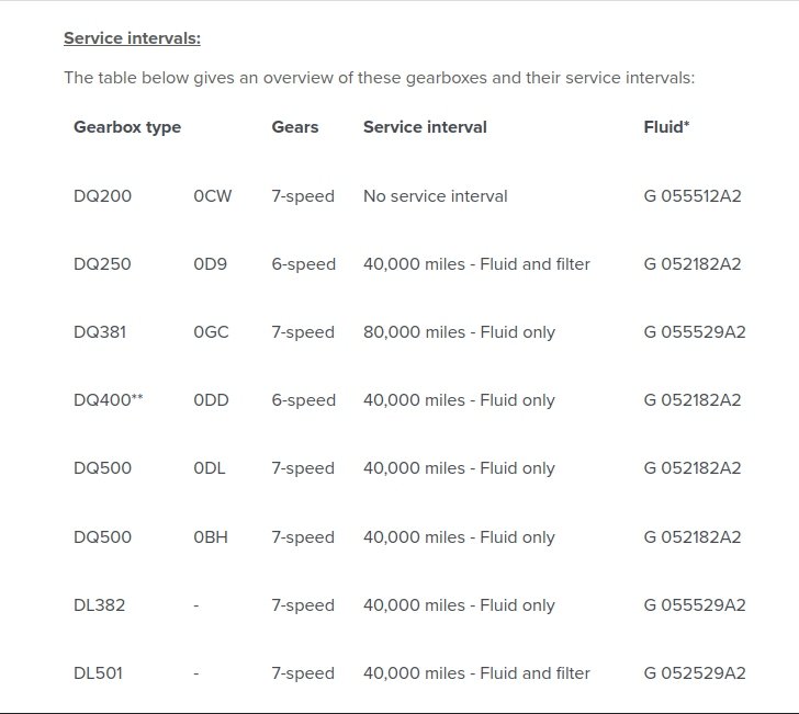

Find out what your gearbox code is from the build sticker in the boot.
Look up the relevant oil part number via one of the diagrams here gearbox Superb (SUP) [EUROPA 2015 year] (7zap.com) (first one is for transmission codes NBX and PRB, 2nd one as shown, KWB, MUJ and MYP). Cross-reference online to non-genuine equivalents if you don't like the price for genuine oil.
Refilling needs to be done with car dead level both ways.
