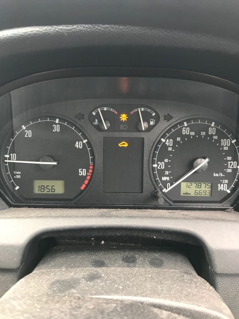

Recently I have been having a sporadic pair of warning lights pop up together  for the bulb monitoring (all bulbs are fine) and the immobilizer key (again haven't noticed an issue in this area.) . It happens randomly and they come on together. If it comes on it happens when you depress the brake and after a while it disappears.
Have replaced the brake switch – did not solve the problem. Seems to occur less but still occurs

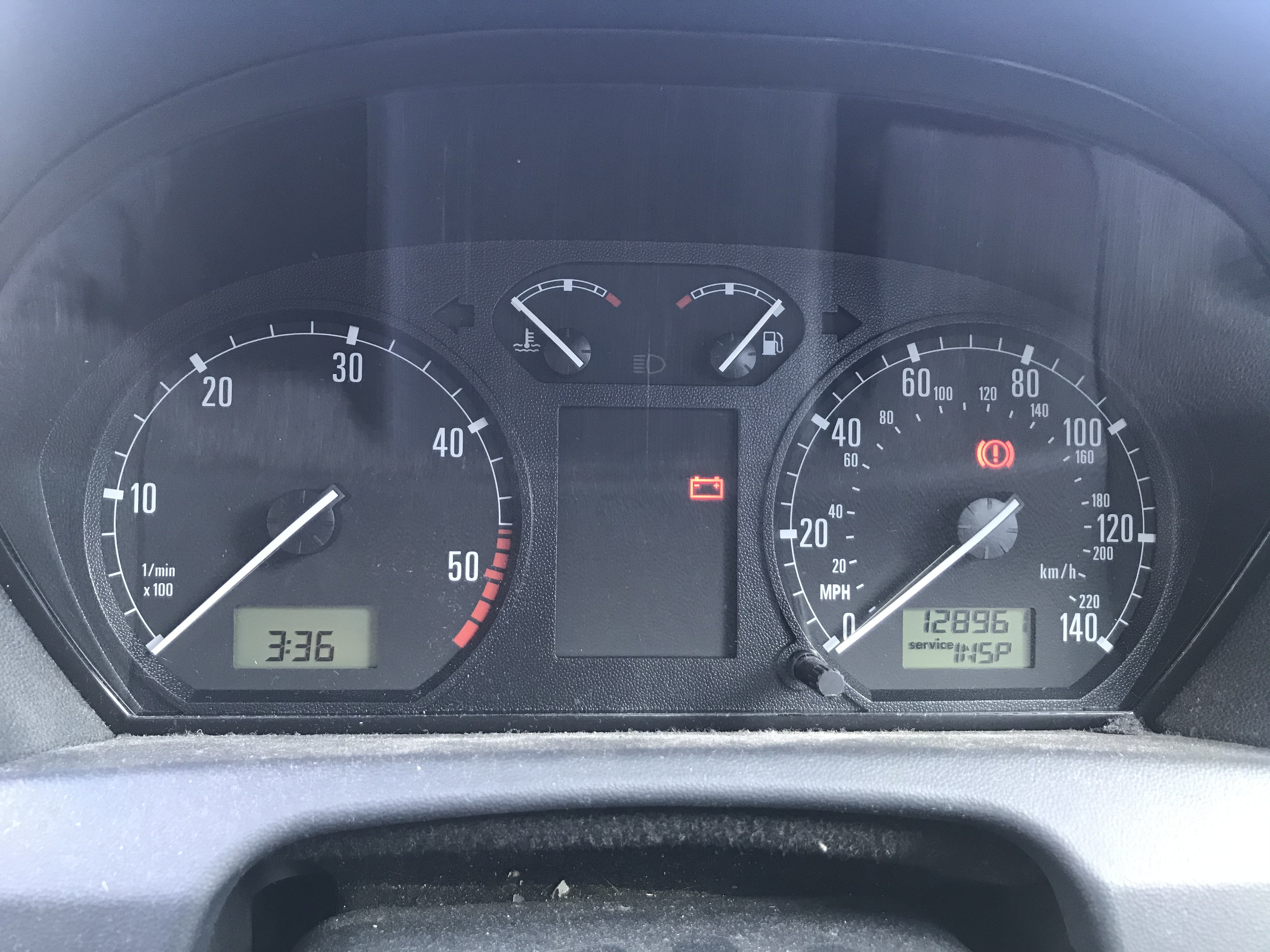

@hubsandspokes1987 My immediate thought too. Easiest first check. Does the battery light come on when you switch the ignition on but don't start the engine?
Hi both! Just an update. With the key in the first position the battery light does come on and stays on. Can’t test what happens on starting (yet) as I’m having to charge it in order to start it.

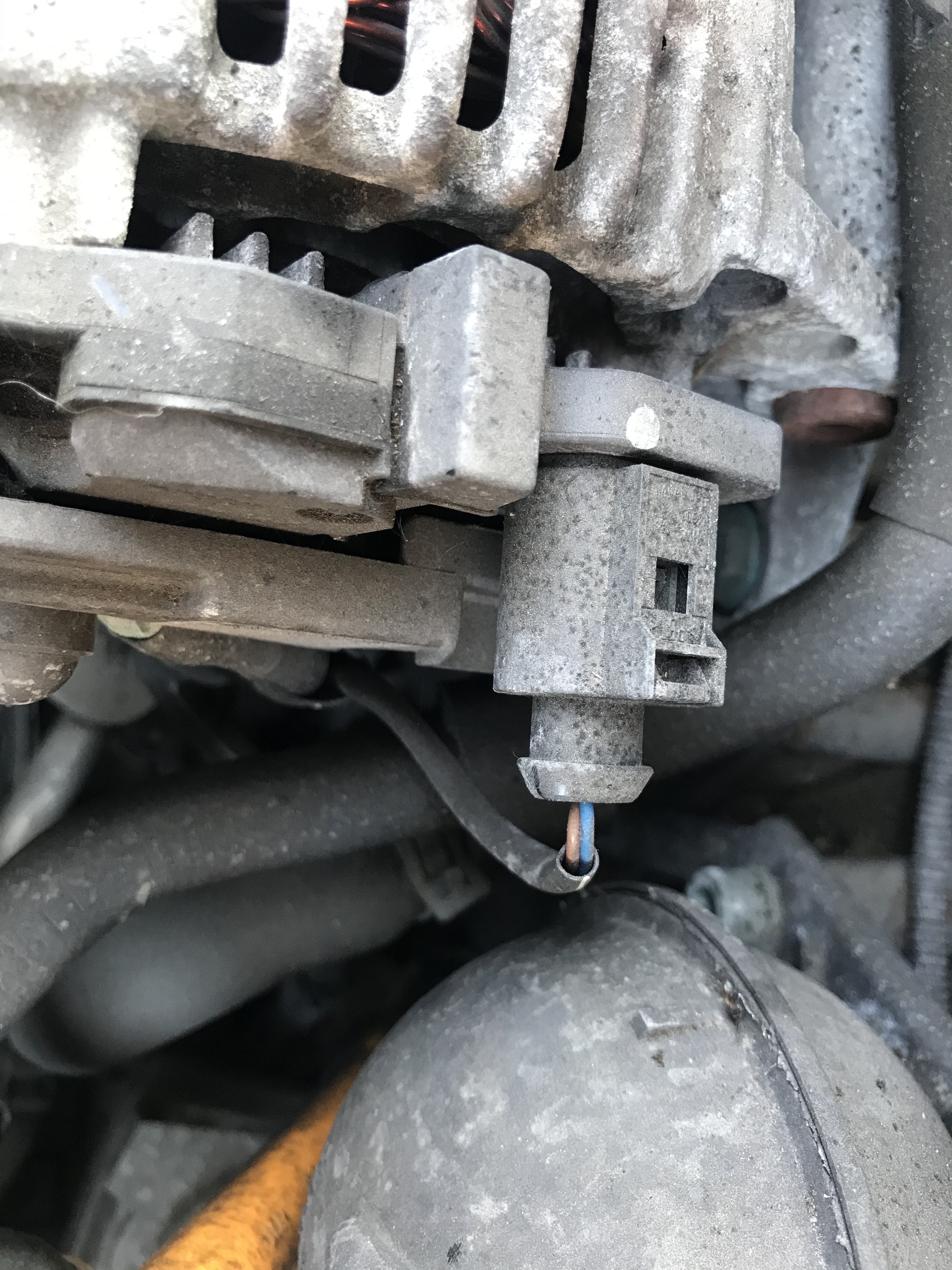

I had  a look at the cables at the alternator end (i think!) see the photo. Seem fine at this point.  But not the other end - I guess I need to root around I’m under the engine to check the other end?
can I put a multi meter at the alternator end and check the reading? And is there any point if the battery light is on in the dash? Lastly would the battery need to be fully charged for that to be relevant?
Nope. You've just ruled out one common charging system fault.
Next thing to do (when you've finished charging the battery) is to measure the voltage across the battery terminals with engine running at idle, with no major current consumers switched on in the cabin.
Ok, thanks! I won't chase that thread any further then. 👍 I'll report back on the voltage once the battery is charged. Probably not today with this miniscule charger I have!
