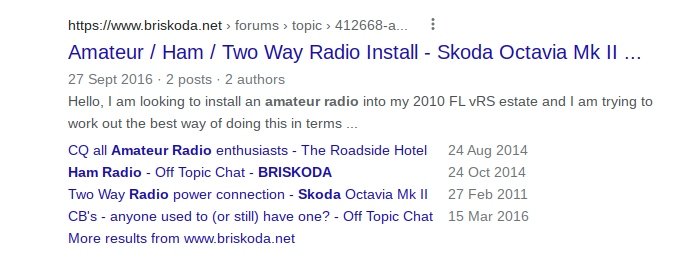

Sorry for my ignorance i needed a reminder.  Congratulations & well done.
Edited by e-Roottoot

No worries @e-Roottoot and thanks for those links! Not sure how I missed those when using the internal search tool before posting, guess that's the power of G00gle for you!
