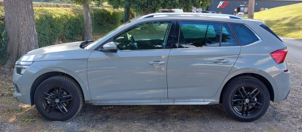

I've attached a photo of my Kamiq with the 16 inch alloys. I chose black as they don't look as dirty as quickly as silver alloys.

Good look!
If I were you I would choose ENKEI YAMATO IN 16 INCH. They are similar to yours new tyres in design, but have 7,8 kg ( instead of 9,2 kg)
Yes, I do believe in theory of unsprung mass for cars.
https://velonity.com/enkei-yamato-matt-gunmetal-16-inch-en02-701640-v6-54/skoda-kamiq-typee-nw-rim/1-5l-tsi-110kw-150-hp/

I chose the cheapest option I could get from a local dealer which compared favourably with anyone else. The two things I specified were the choice of tyres and black alloys. I wasn't bothered about style of alloy, more about comfort.

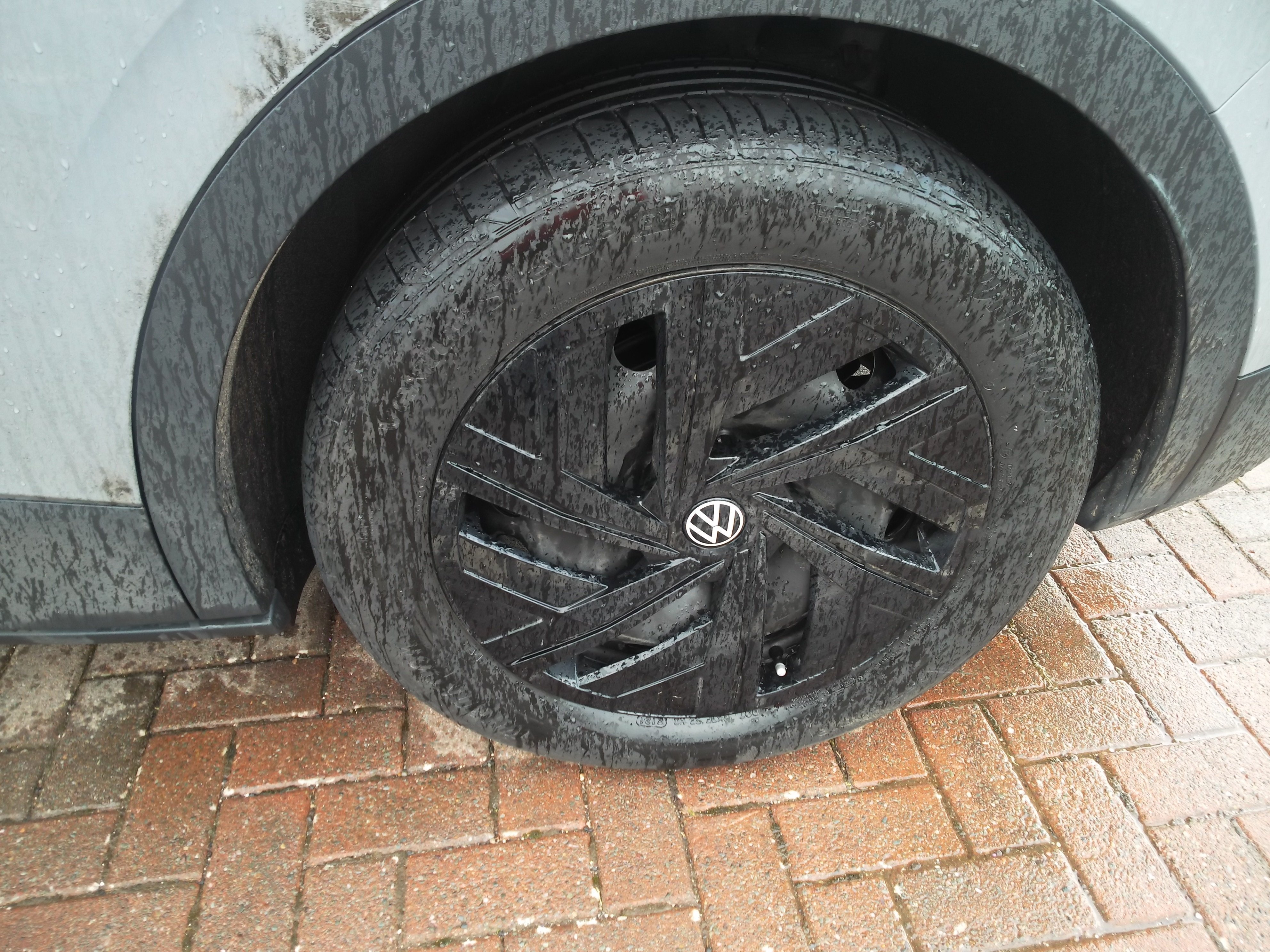

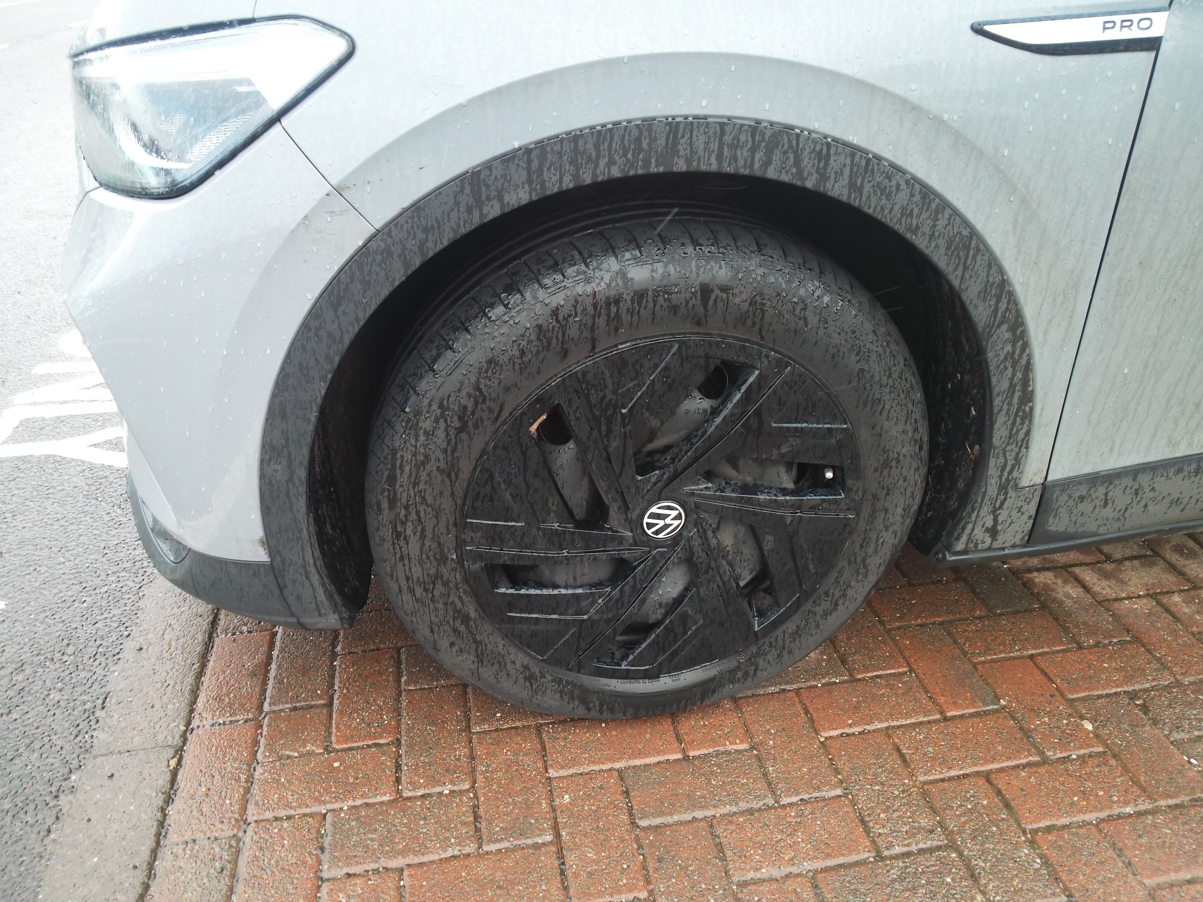

Beauty is in the eye of the beholder.
There are even £35,000 VW EV's running Steel Wheels with wheel covers.
