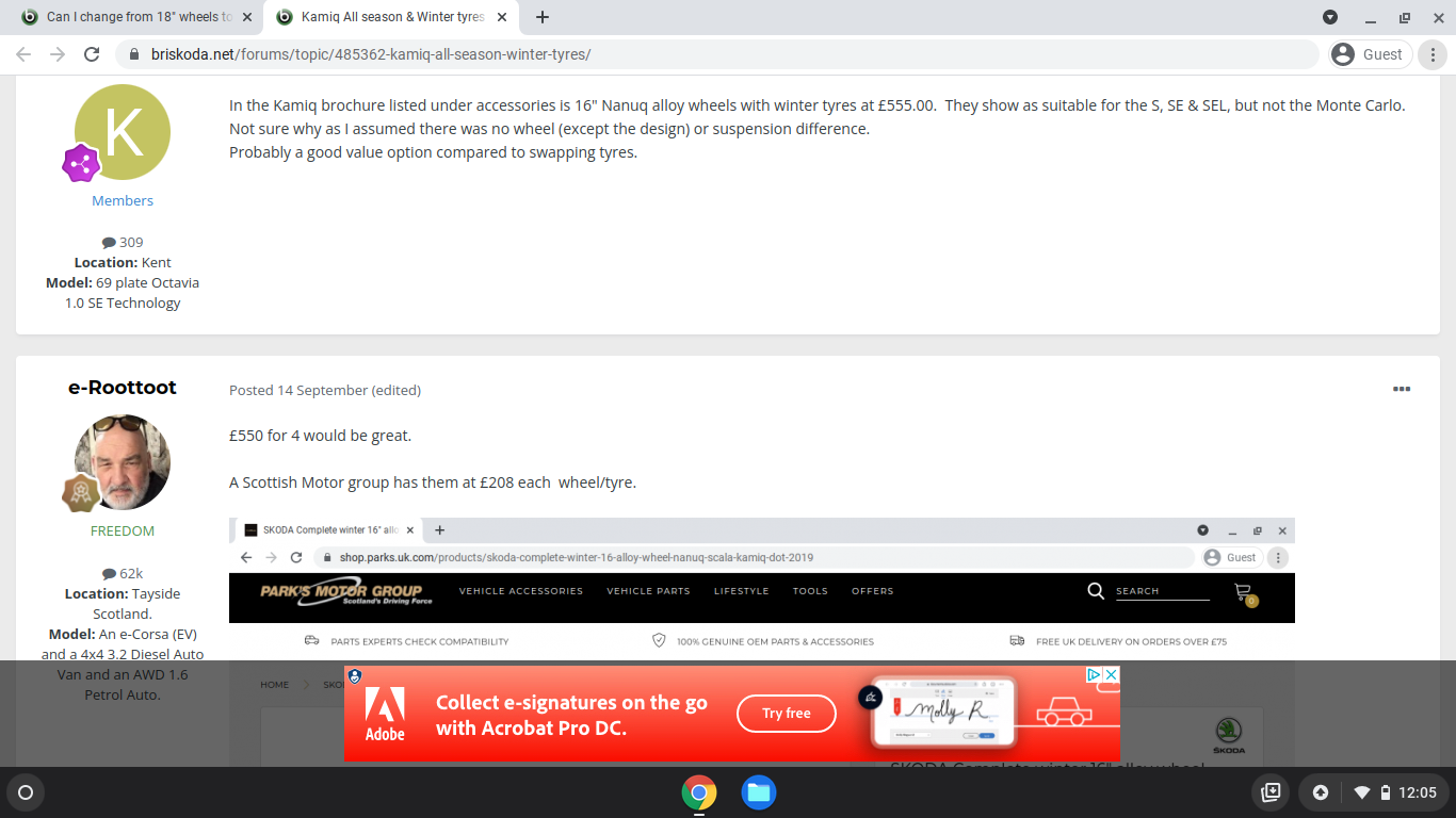

On Skoda accessories in the brochure it lists 16” winter wheels for S, SE & SEL, but not Monte Carlo. Not sure why as I thought the MC had no mechanical differences.

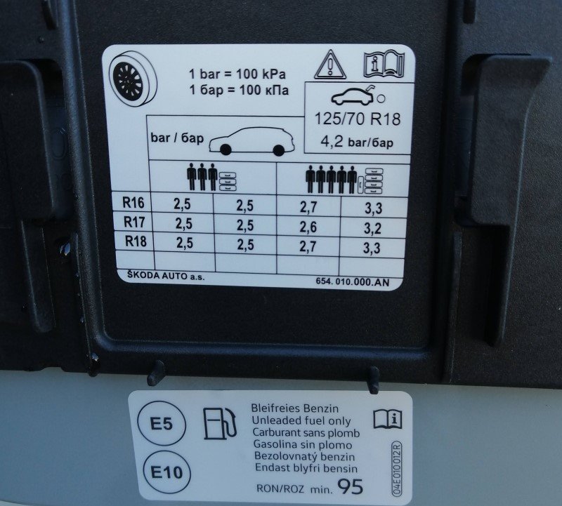

What tyre pressures are shown on the tyre pressure label inside the fuel filler flap?
Maybe you could put up a photo of the label?
If you are lightly loaded (ie. just two front passengers) I would try 29psi front and 26psi rear whether using 205/60R16 or 215/55R17.
29psi front tyre pressures and 26psi rear tyre pressures can support a total load of 1596kg using 205/60R16 tyres and 1558kg using 205/55R17 tyres.
For a full load (five passengers and their luggage) I would increase the tyre pressures to 32psi front and 35psi rear. That would be enough to support a total load of 1932kg using 205/60R16 and 1886kg using 215/55R17.
3 hours ago, cestrian said:
Those tyre pressures seem rather high. Maybe they are eco pressures?
It's surprising that Skoda is recommending the same tyre pressures for both the 205/60R16 size and the 215/45R18 size, as the 205/60R16 has a much higher load index (92 vs 89).
With the 205/60R16 tyre size, 2.5 Bar front and 2.5 Bar rear can support 2,100kg.
With the 205/60R16 tyre size, 2.7 Bar front and 3.3 Bar rear can support 2,520kg.
I doubt the Kamiq weighs any where near these amounts.
To keep things simple, I would try 32psi front and rear (with just two front passengers) and then 29psi. You should easily notice the ride improvement everytime you drop the pressures by 3psi.
