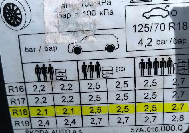

Hi Roottoot.
I was really going by the type plate in the fuelcap.  It states:
2.1Bar = 30.4psi
32psi (my pressure) = 2.2Bar
Interestingly I was running at 35psi (2.4Bar) and when I took it in for a service at VAG they actually reduced the pressures all around to approx. 30psi
I never asked them about the tyres etc.  They just did it of their own bat.
When I ran at 2.5Bar (which I did for a while) - the steering felt very light and the traction was abysmal.  Obviously that was with the Turnza's and I don't know a whole lot about the Michelin Crossclimate 2's but it seems 32 is is about right ??  Open to ideas though.

with the 19's isn't the lowest figure is meant to be 2.4 (34.8psi)?   (that is what it says on my 2wd Karoq at any rate): image.png.ebc4b7d2817707f97984b9c81e0e187c.png

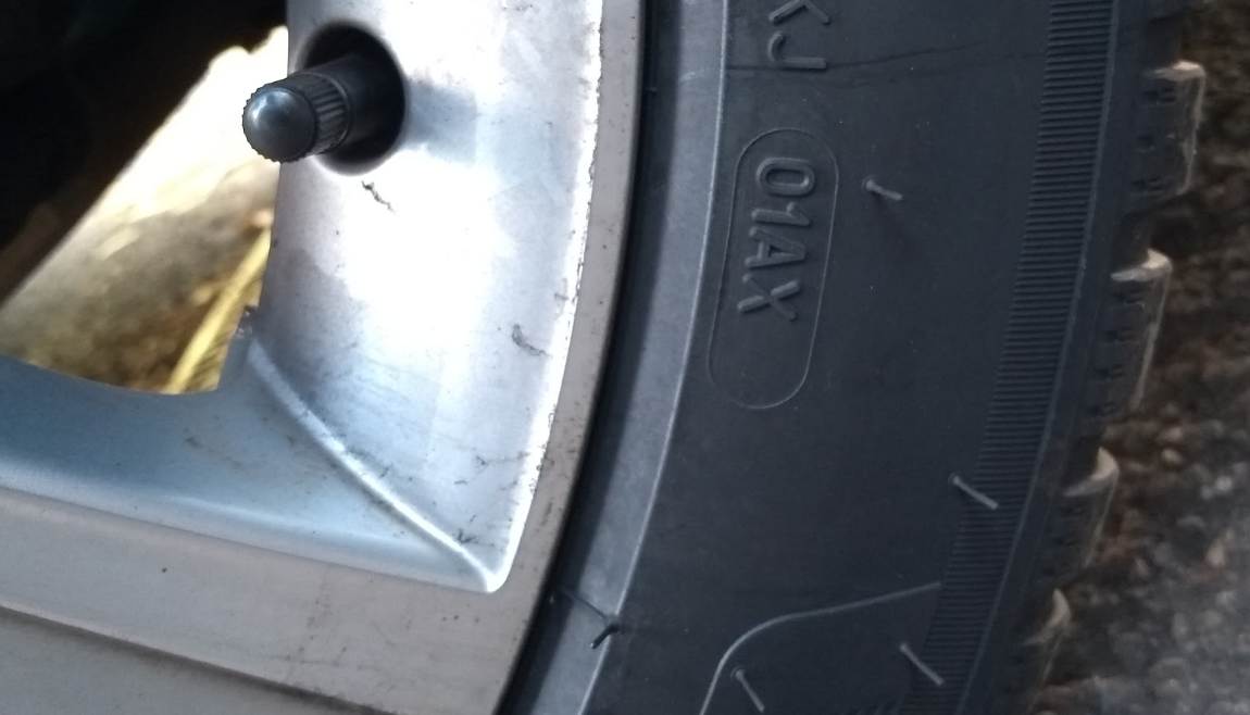

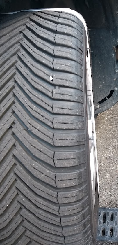

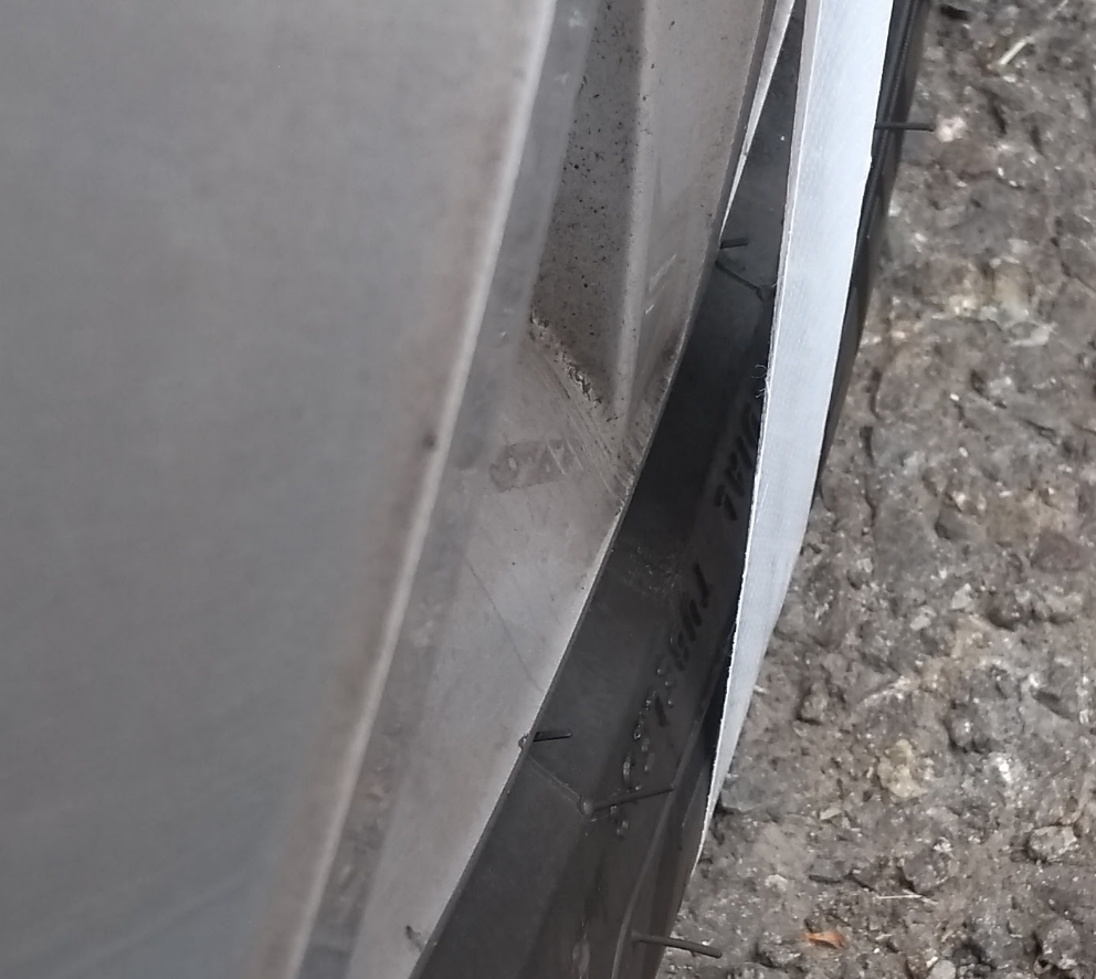

Do the Michelins have an 'anti-kerbing' ridge like the Turanzas, please?
On what I saw the other day at a dealers, certainly not much - one thing the turanzas are good for is really good rim protection
 Thanks for the comment. Whenever I have looked at tyre specs, I haven't yet seen a manufacturer that mentions rim protection as a plus point for a particular tyre.
Apologies for the filthy Alloys but I hope this helps a bit.
These are the SUV CC2's and while there is no marking "FP" or "CPJ" on them (which I am led to believe is the Michelin lingo for rim protection) - they do stick out a fair bit from the Alloy and they do have a reasonable lip on them. Maybe Michelin don't mark them up anymore???  I put some tape on to show the gap:
Today I had to do a "foot to the floor" exit from a dry T junction and no wheel spin. On the same junction in teh same conditions I have had a few occasions where the Turanza's lit up and Traction Control kicked in.  this was on 50% lock to turn right. I am well impressed! These things are night and day to the Turanza's.  Don't delay - just do it!! 🙂
