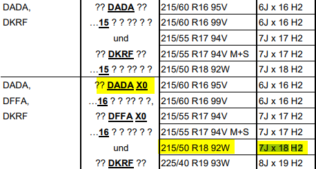

That explains why on the homologation certificate for my 1.5 TSI 4x4 the approved wheel assemblies are  listed as follows:
(incomplete specs)
225/55  R17  97V ...
225/45  R19  92W ...
225/50  R18  95W ...
225/55  R17  97V ...
225/60  R16  98V ...

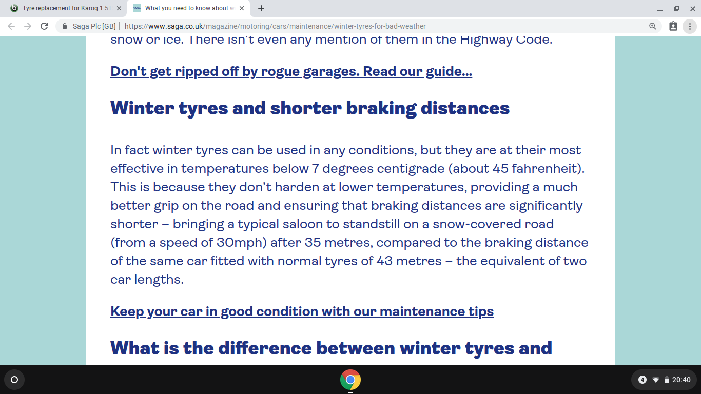

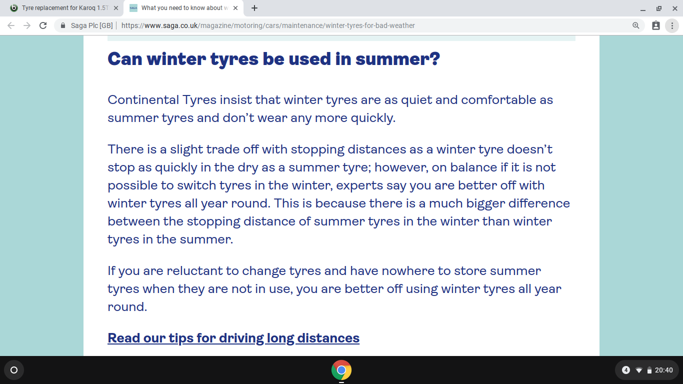

Just called my insurer ( a big name - SAGA).  Initially they said that they wouldn't have a problem.  Iasked for it in writing and they checked with the underwriters. The underwriters have stated that if the tyre I select is a lower speed rating than the official Manufacturer specification (in my case W for the 1.5TSi on an 18 Rim) then I would NOT be covered and I would invalidate my policy and I would not be insured if I had an accident.
I appreciate that it is probably a "catch all". They checked with the underwriters.
Please don't risk getting a V rated tyre if your Type approval states W
Buyer Beware.
Edited by smipx

Skoda sometimes states in the owner's manual that winter tyres with a lower speed rating can be used.
As all-season tyres have the 3PMSF symbol, they are winter tyres...as that symbol is the definition of a winter tyre.
Winter tyres aren't available with the W speed rating in size 215/50R18. Maybe your insurance company thinks it's ok for you to slide about dangerously in the snow on your summer 215/50R18 W speed rated tyres.
It wasn't long ago that some UK insurance companies were telling UK drivers not to use winter tyres because that was a modification. After a few years they admitted that they had made a mistake, and decided that using winter tyres wasn't a modification.
UK insurance companies advise car drivers to always drive on summer tyres in the snow. (This is what happens...)
Edited by Carlston
British Insurance Companies, Brokers, Call Centre Handlers & Underwriters never knew when Winter Driving Conditions actually happen in the UK as low temps or snow / ice can occur in Spring , Summer, Autumn & Winter in the parts of the UK, and warm weather can as well like a heat wave in Scotland in March 2012 with Blizzard like conditions coming in April with whole communities cut off..
So basically when winters or All Weather or snow tyres are not appropriate becomes a grey area.
Many in or around hill/ mountain roads keep the same tyres on all year and have done with different vehicles over the decades.
Do they want people to take their Winter / All Weather tyres off in May only to put them back on in August?
Night time temps might well be well below 7*oC even in those 3 months.
So you do need the agreement from insurers and it has become in the past years that they had become more sensible.
SAGA have not been so silly in past years IME, but then all anyone can do is ask and who knows what answers they can come away with.
Sometimes it seems to be nonsense someone comes away with.
What Skoda as a Manufacturer might say about a lower Speed Rating in Winter counts for nothing as they do not even specify when winter or winter like conditions are in the UK.
(They have still not designed Fuel Filler Flaps that do not freeze shut yet they are a Central European car manufacturer.)
Edited by roottoot
