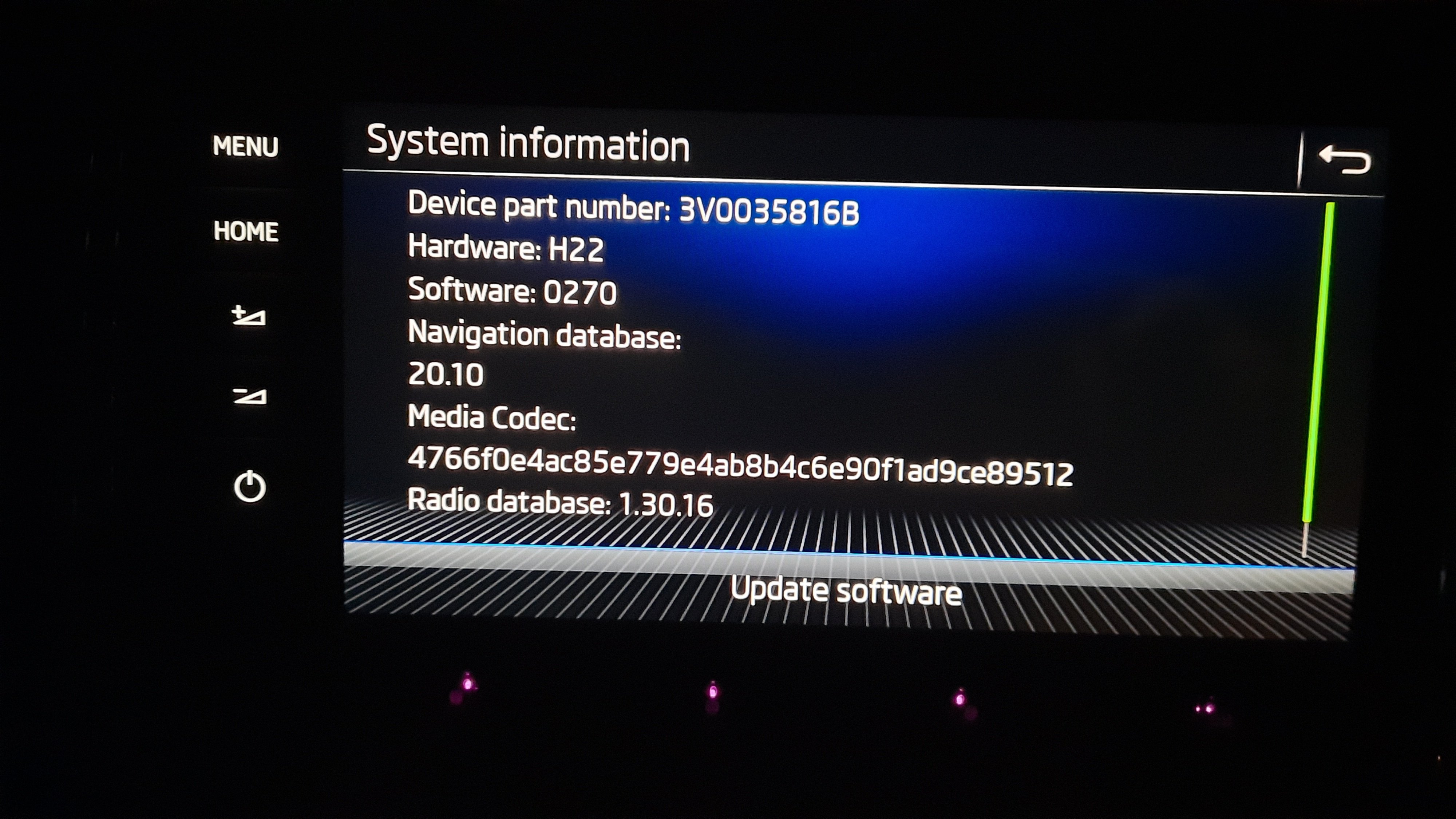

Really appreciate your reply.  I had to visit dealer for something else today, asked if I could have a look at a used 2021 Kodiaq on their forecourt whilst I was waiting and it's exactly the same as mine, the clock freezes. How weird.
Only thing I can think of is software version. Is your's the same as this?

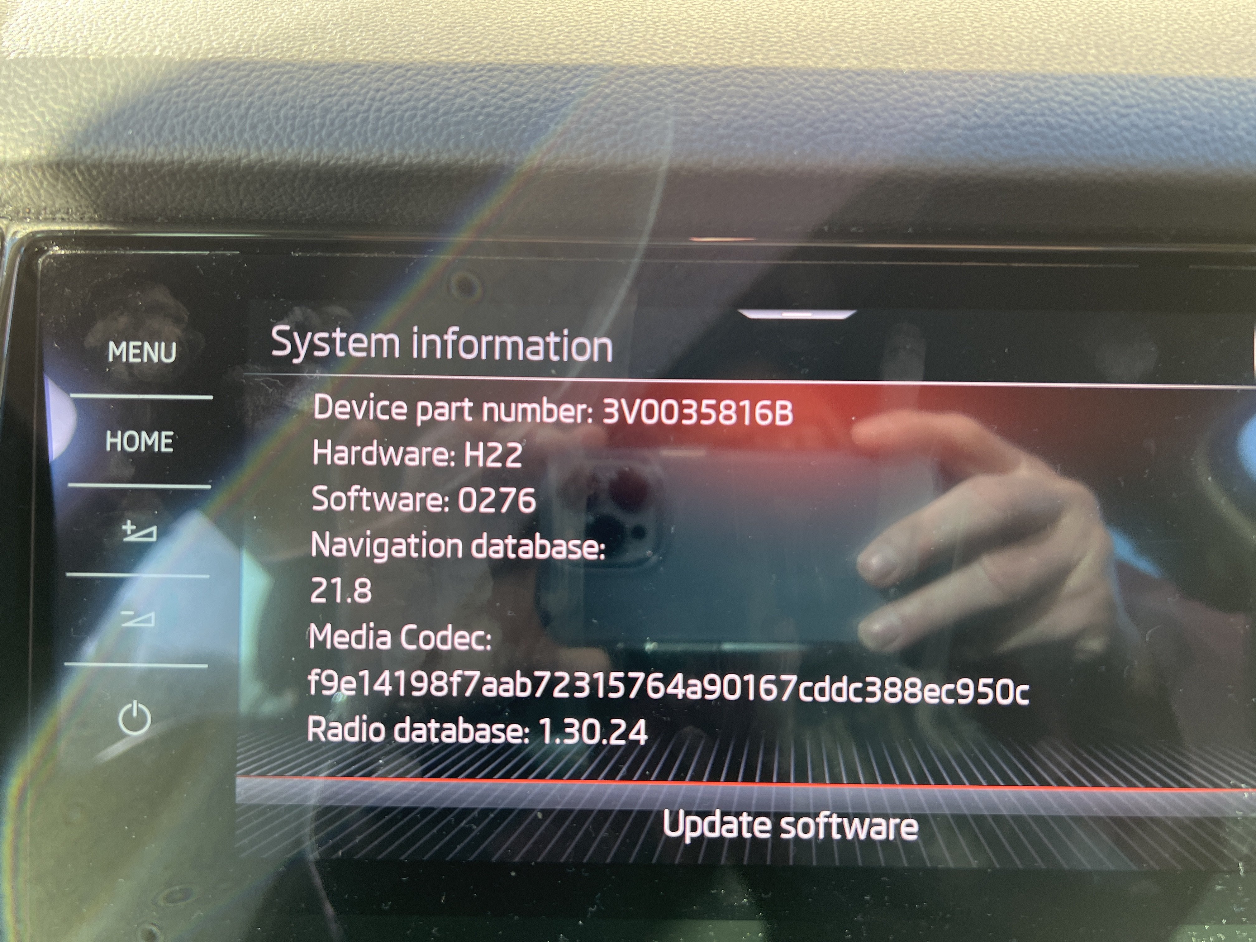

This is my system
2 hours ago, Billywizzo said:
This is my system
Off topic a bit, but I see that you have the latest mapping available i.e. 21.8. Did you get that over the air or did you do a manual update from the Portal ?
The car had a service last month so maybe they updated it, the only OTA updates recently have stated they were for the shop.
This car cannot be manually updated only either in the garage or over the air.

Now that's very interesting. You have updated software and Nav Db.  My car was serviced a few weeks ago but no updates were carried out.  Think I may have to have a word with my dealer.
Many thanks again, appreciated.
Mine has 21.9, and software 03something. It did an OTA update about a week or so ago (told me there was an update, I didn't check), but no idea what version it was running before that.

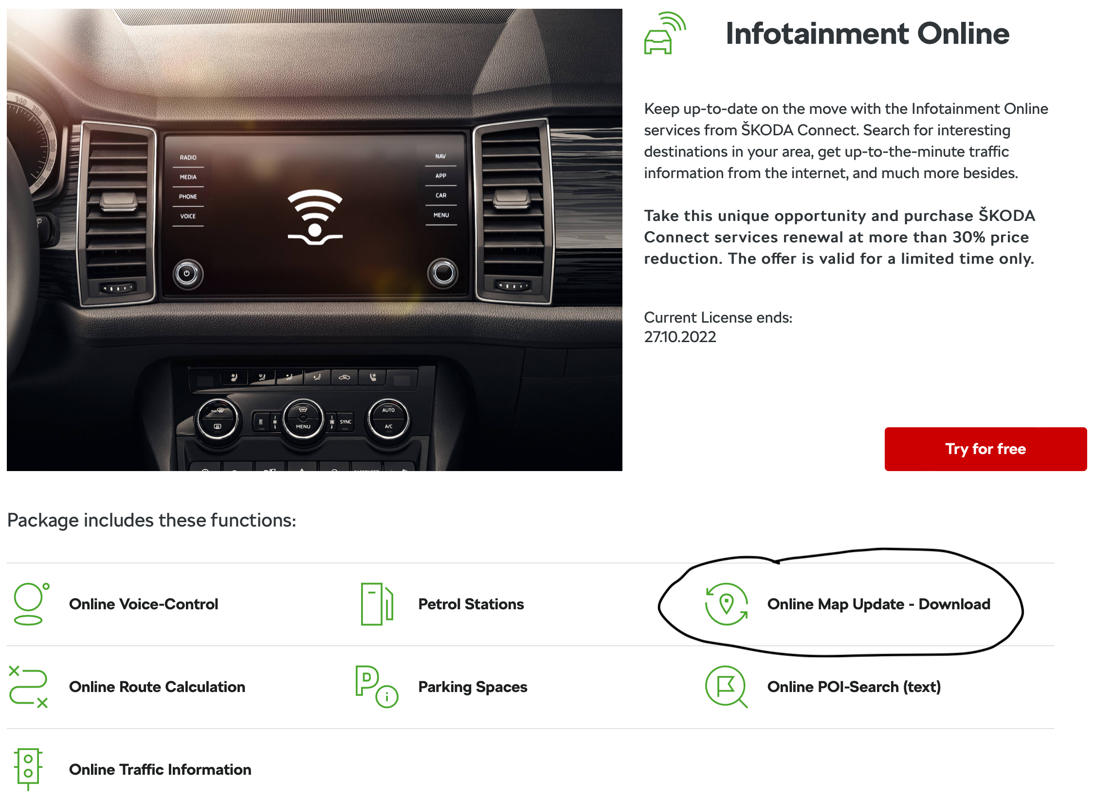

For what it's worth, OTA map updates are listed as part of the Infotainment Online package... so I guess no updates (OTA, at least) if you don't pay after the first year.
1837159618_Screenshot2021-11-23at16_14_25.thumb.png.09c50a5050bf18b8c05f9c3e3fd28f57.png
Yes, I believe that's the case, which is why I wanted to get at least one update done because I doubt I'll be paying when mine runs out. Other than map updates, I see little value in Skoda Connect except maybe being able to unlock your car via the phone app if you've left your keys in the car and it's locked itself, although I'm not even sure it's possible to lock yourself out.
I'm hoping Skoda will see sense and once again let us do map updates manually.
You're not the only one... I tend to use CarPlay for everything, so see no point in paying for Connect. I just wish you could display maps from CarPlay (not just directions) on the virtual cockpit. And no, I don't believe it's possible for the car to lock itself with a key inside - the only scenario I know of when the car locks itself is if you unlock it, but then don't open a door. For the key to get inside, you'd have to open a door, at which point it doesn't lock itself even if you shut the door again.
