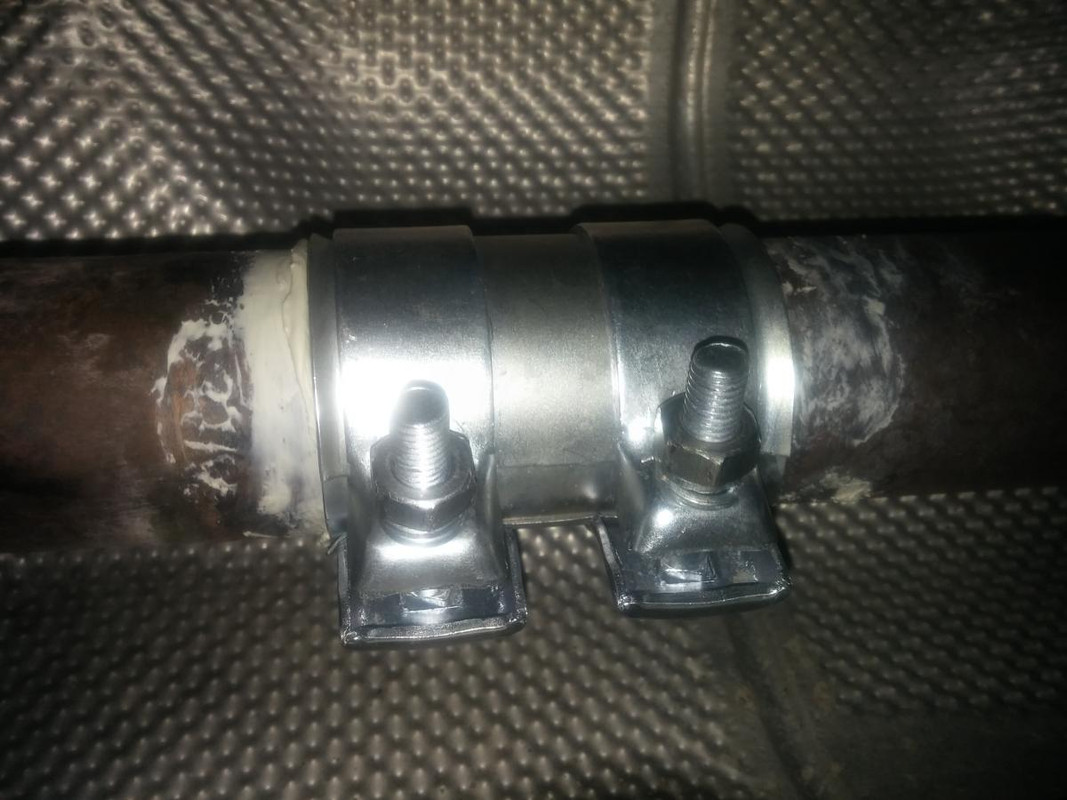

If I have to change cat out I know its sll one piece from flexi and cat rtc but eill I be able to just remove that section or will I need to remove back box and middle box first ???
You can just remove the front pipe section. It is joined to the rest of the exhaust by this type of sleeve clamp...
