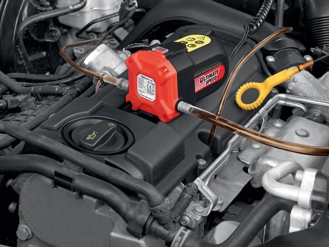

One thing I would say, if it is the same engine as the Golf Mk6  (I think it is), the oil can take some time to drain down, so be patient and top it up slowly.
I use a suction pump from Lidl to get oil out, only takes 5 minutes when warm and pumps it straight into an empty container so no mess to clear up and saves taking the undertray off.
Is the suction pump electric or hand operated, I have not seen one in Aldi before.
Usually plenty in Lidl, about £12, crocodile clips from battery, oil wants to be warm not up to full temperature.
Edited by Urrell
Thank you that looks very neat, we always pumped oil out from machines to avoid the mess
and make recycling easier.
