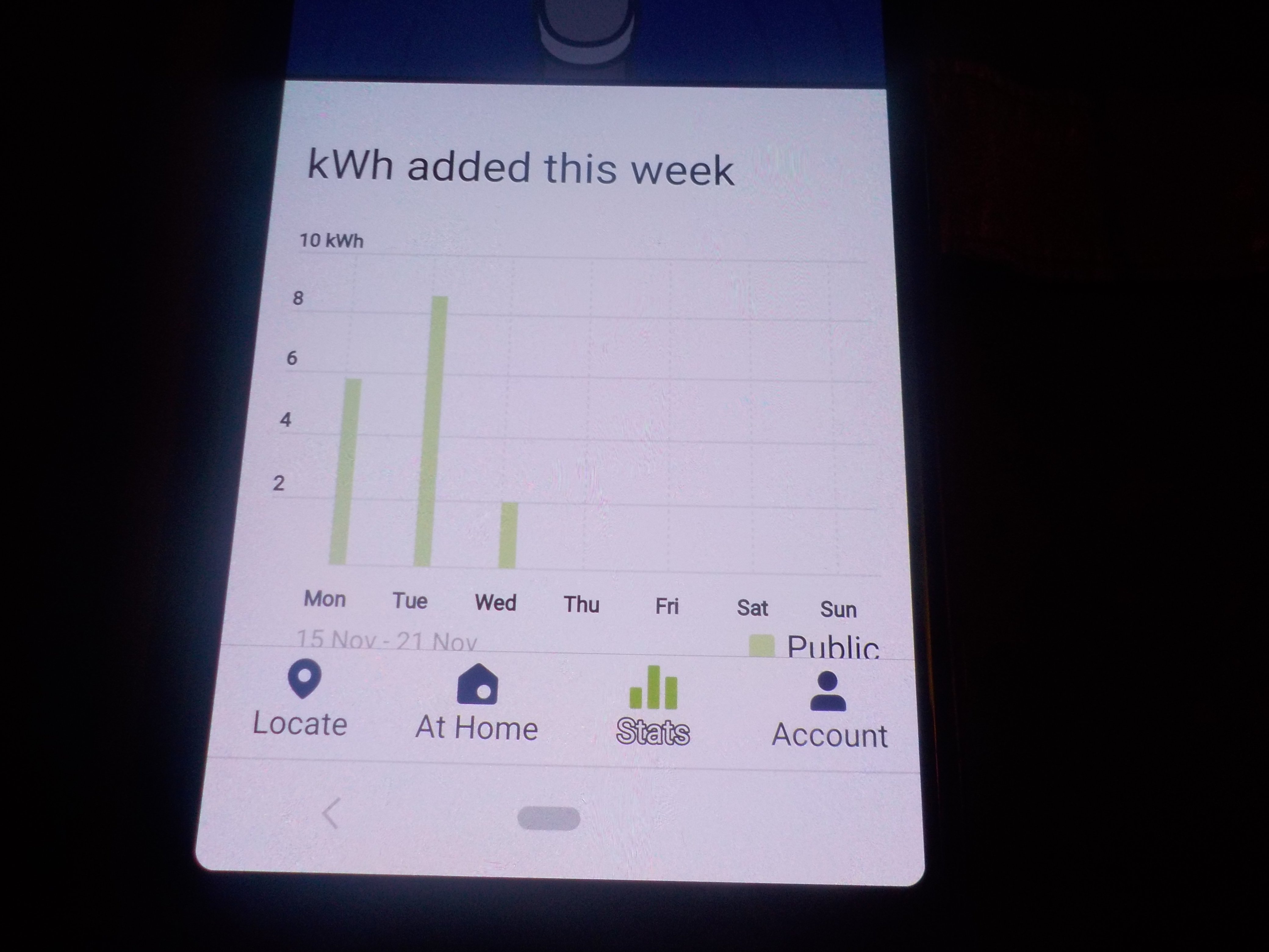

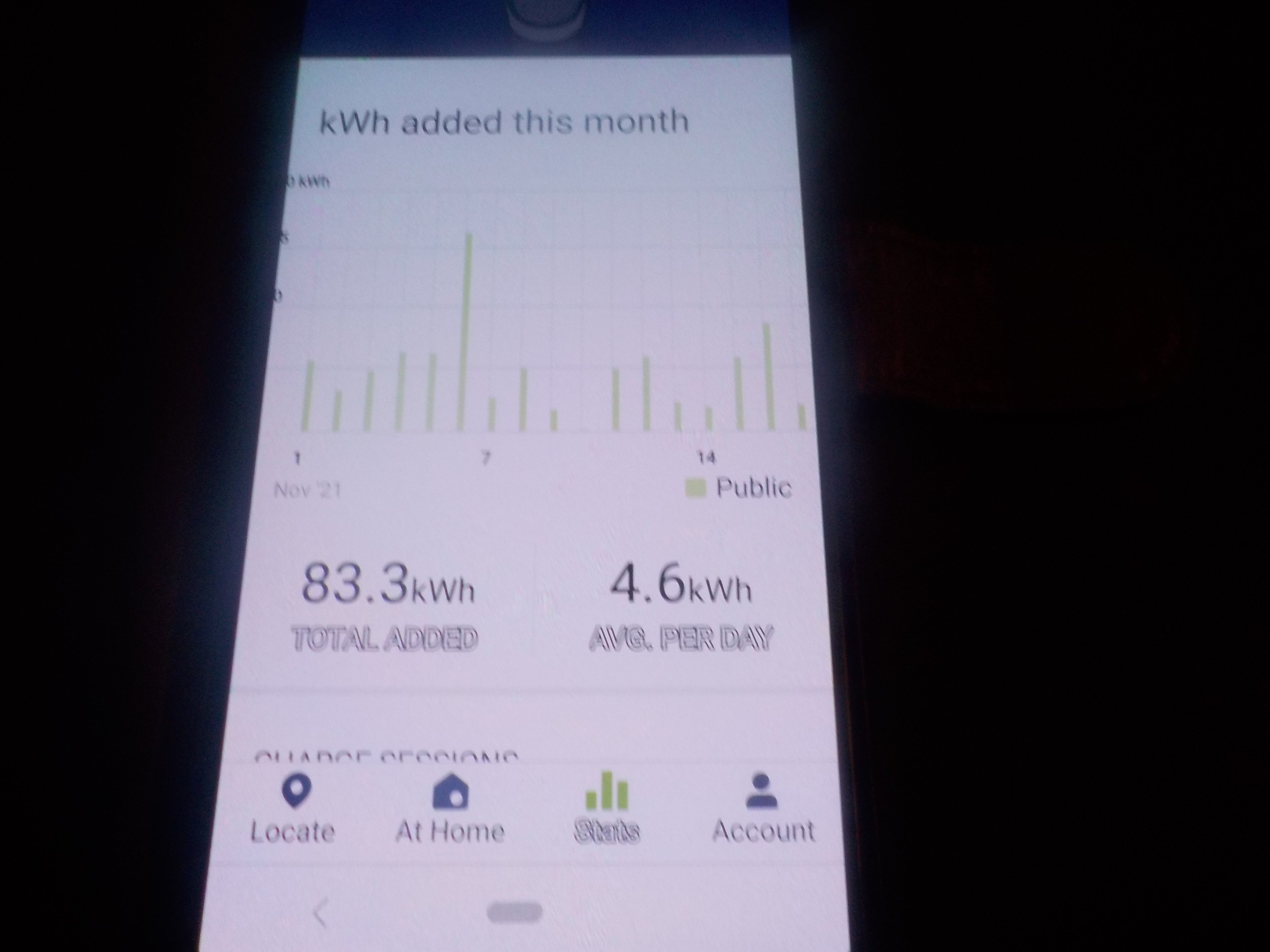

At present in coldish weather i use near 5 kWh of charge only driving on average just 6 miles a day average and the car sitting the rest of day and night doing nothing.
