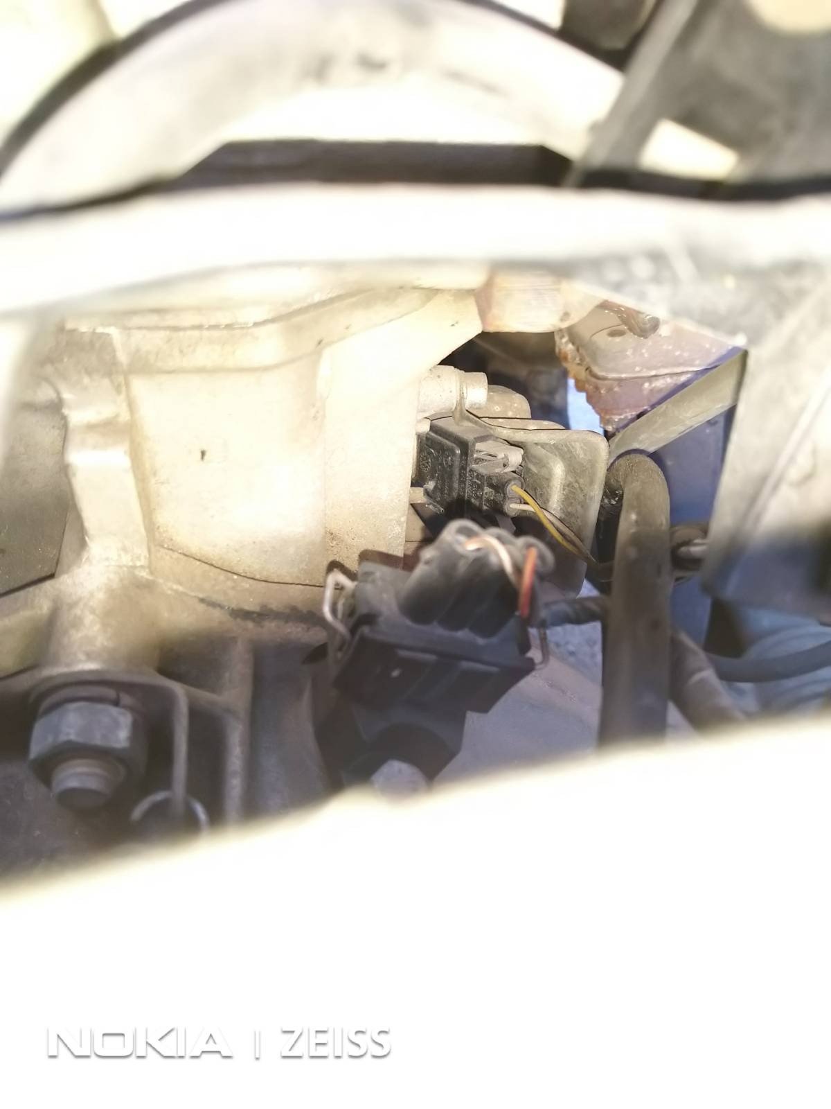

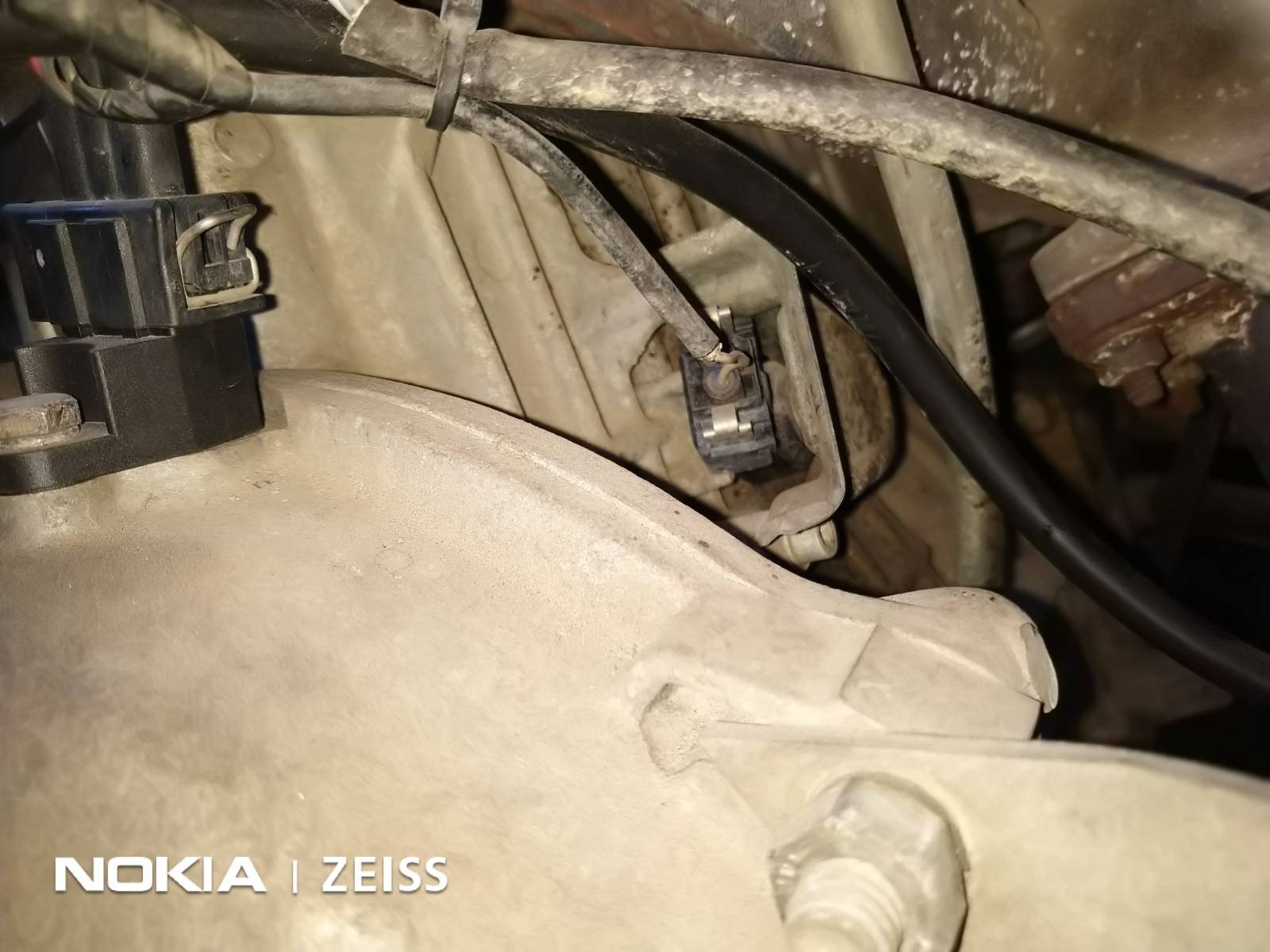

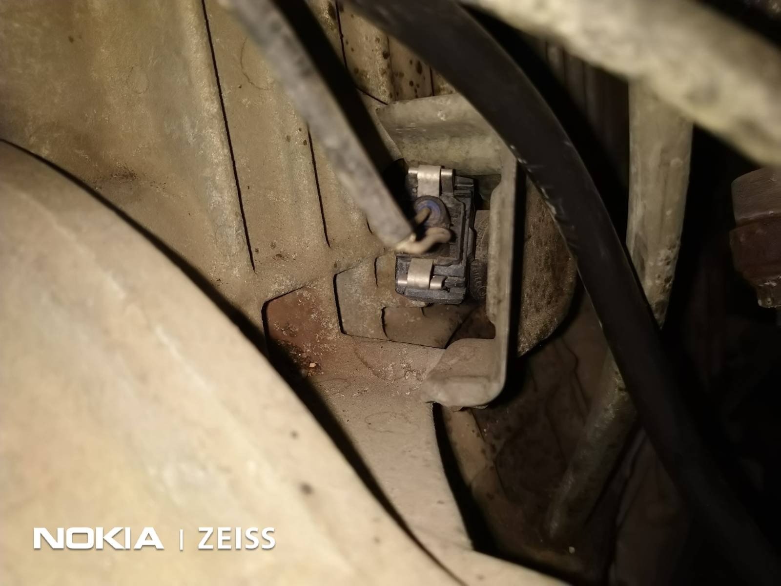

This sensor that I show in the photo, which is located at the bottom, at the foot of the collector, is the sensor of what ?
Here
signal-2021-11-26-104035.thumb.jpg.001c0c85ea82ed032a9832dfcb79d4f8.jpgsignal-2021-11-26-104038.thumb.jpg.d748d4b68c69c2b4228497c8a9acd524.jpgsignal-2021-11-26-104043.thumb.jpg.93eb2ea29992b412d0bc671d4191f5a3.jpg
It's the sensor in the back, not the crank.

I am unsure about which sensor(s) you mean and do not know enough anyway so will not comment on those.
Starter motor sounds fine, but if you have issues with starting on key, it could be bad ignition switch - it directly engages starter's solenoid, which causes contact wear over time.
The sensor in photo is knock sensor - it's there to detect "sound" of detonation, so ECU can change timing if detonation occurs.

Oh ty.
