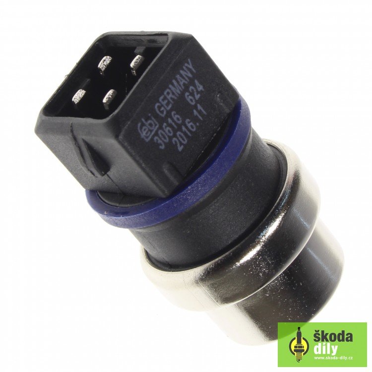

4 minutes ago, Thefeliciahacker said:
That's temperature sensor 100%
but I changed the temperature sensor, and now it shows the temperature on the display and everything.
Like this one

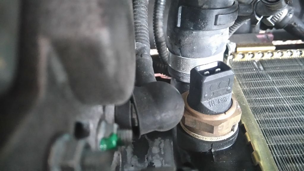

or is it the coolant sensor? which is on the radiator
Like this one
is that the top one I changed on Friday/Thursday ..
or is that one ?

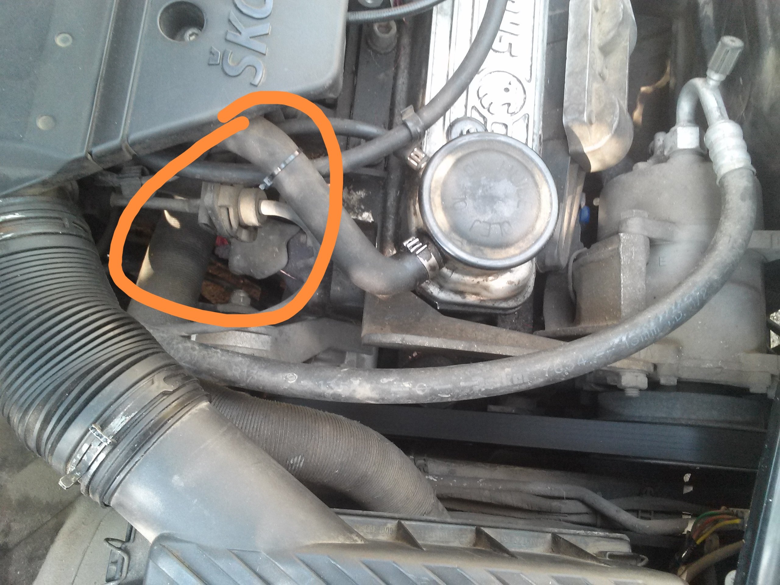

Joob, in that video the electric and starter side sound healthy so check basics like fuel delivery and spark - BUT - in that video I notice a hose not connected what else has been left off or missed - do not start rebuilding the car for a "schoolboy error" done yesterday/today.  We have all done something at some times, I thought my car did not sound right after starting and it was because I had not replaced a spark plug HT lead I removed to get easier access to something else.

Yes, in the video it's with the hose open, but then I put it in the place, and it wouldn't be because of that it turned on or not, because this is just a gas exit from the oil.
Yes but is that the only pipe, hose, electric connector, whatever else not reconnected or not connected that should be - it you left that disconnected on purpose fair enough although I am not sure why but if that hose or other item is not connected it is not doing its job and could it also possibly drawing air in that upsets the system or other systems and/or the sensors and/or the computer.
In other words - is everything connected as it should be so that the items can work together as intended.
If the car starts and runs as it should in the day except for in the mornings then it is either something that is not adjusting correctly for the morning starts or a faulty item that is affected by the weather and/or environment of the morning.  Have you tried spraying around with WD-40 Multi-Use as its one real purpose of dispersing water (damp).
